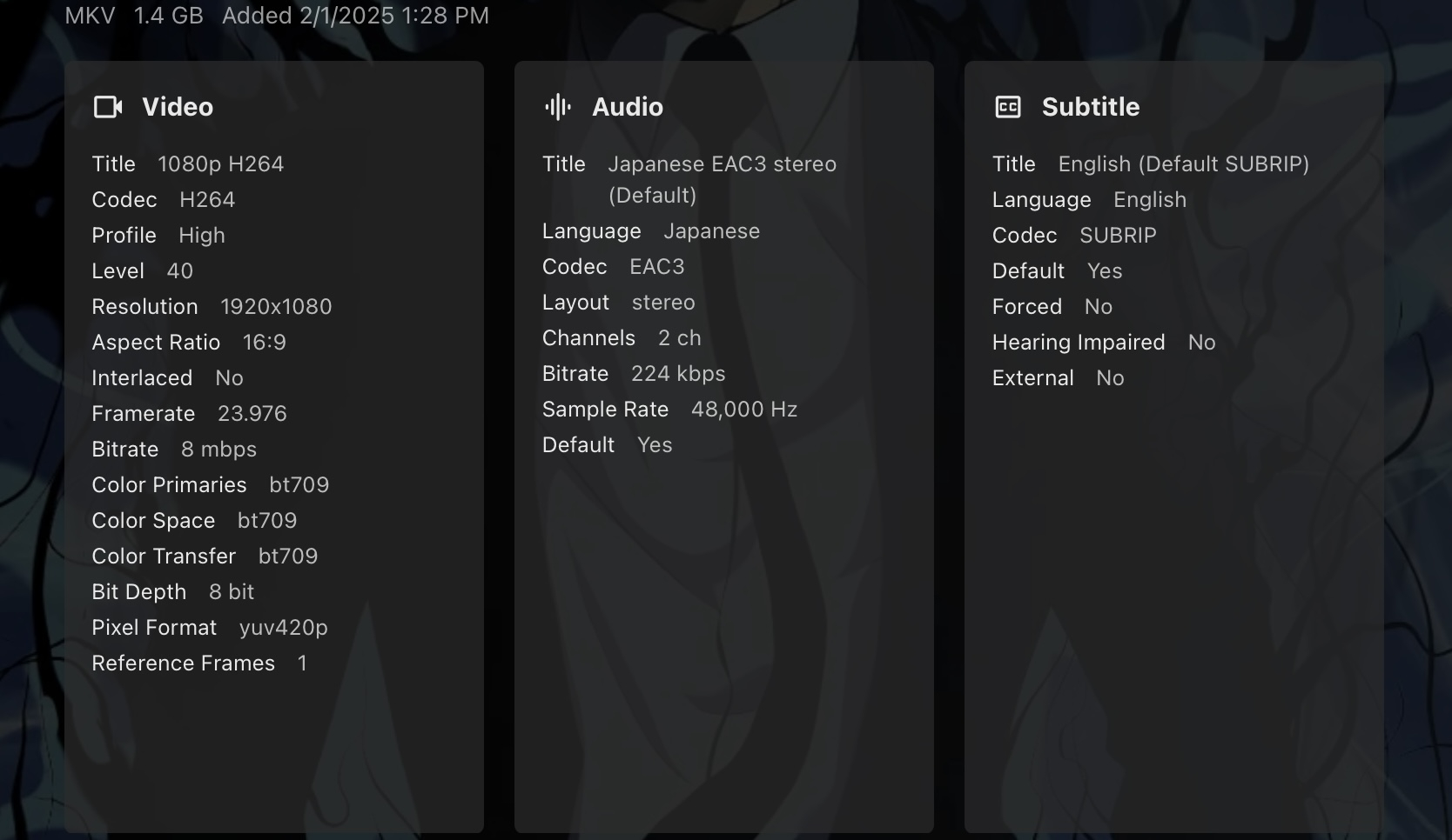

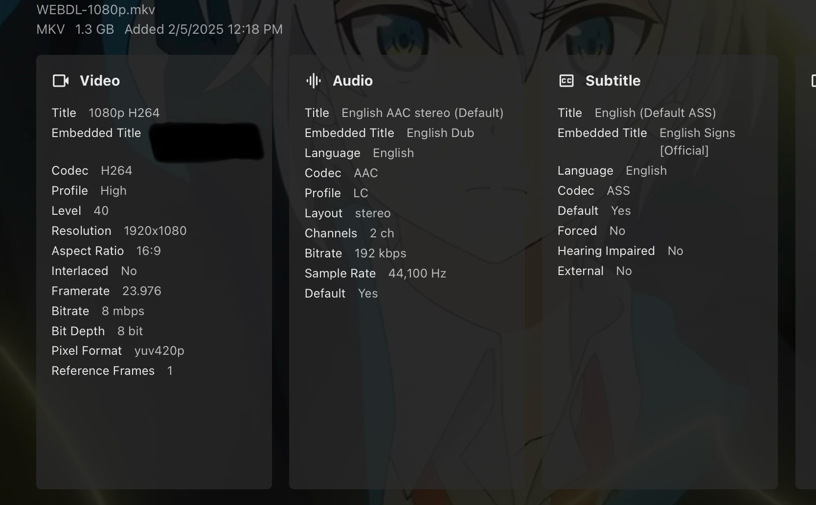

This has been happening for quite a long time, just getting annoyed enough to try and fix it as it’s been more frequent of late. These files play back without issue on web, iOS, and Roku players.
While playing back primarily dubbed anime but more recently other regular content I am unable to skip forward / back or ff/rw. The position indicator jumps in the direction of the command, then jumps immediately back to the playback location when I stop sending commands.
I suspect that the issue is with audio tracks with the AAC codec and/or the LC profile as this is present on some of the other files I’ve checked that I believe were also affected.
here is the media info for an affected file.
and an unaffected file (subbed anime) for comparison

SamES
This issue only affected older models and should be fixed for the next update.  @Luke, I think this is the the e.repeat issue we fixed in December.
