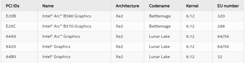

Q-Droid 861 Posted February 13 Posted February 13 According to Intel those devices are supported in the Linux kernel 6.12 and you're on 6.11. 1
lozanoeg 0 Posted February 13 Author Posted February 13 (edited) yes, i rolled up to 6.12 and did the same test but rolled back to make sure i wasn't changing too many variables. the ubuntu repo added for 24.10 also backported the drivers for 6.11 at least from my understanding of the install on ubuntu page. Edit: Here is the log for 6.12 hardware_detection-63875053217.txt Edited February 13 by lozanoeg
