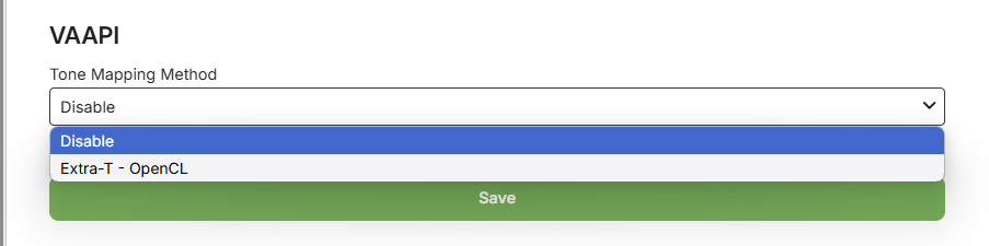

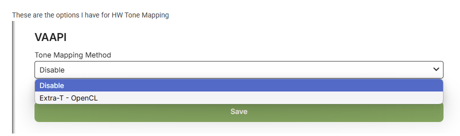

These are the options I have for HW Tone Mapping
If I set it to Disable, HW Transcoding works but the color are all faded (aka not Tone mapped, which I would have expected)
IF I set it to Extra-T - OpenCL, the transcoding reverts to SW and the colors are fine.
I was wondering if anyone was able to suggest things to try. I'm not sure if the issue is with the AMD drivers or something else.
On my other Emby Server, I have another option for Tone Mapping ("VAAPI HW Tone Mapping"). Should I be able to see this as well here?

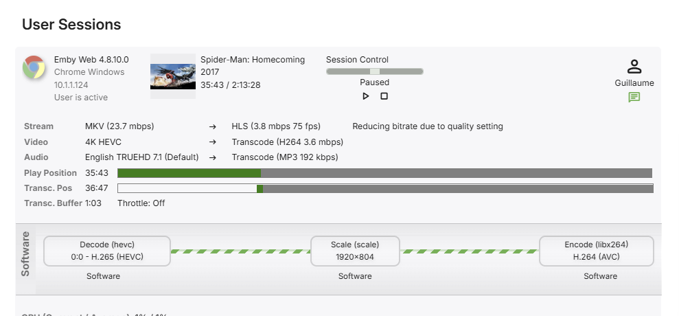

gcorgnet
These is what I see in Diagnostics if I have Tone Mapping on

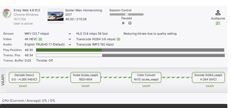

And this is with HW Tone Mapping Disabled

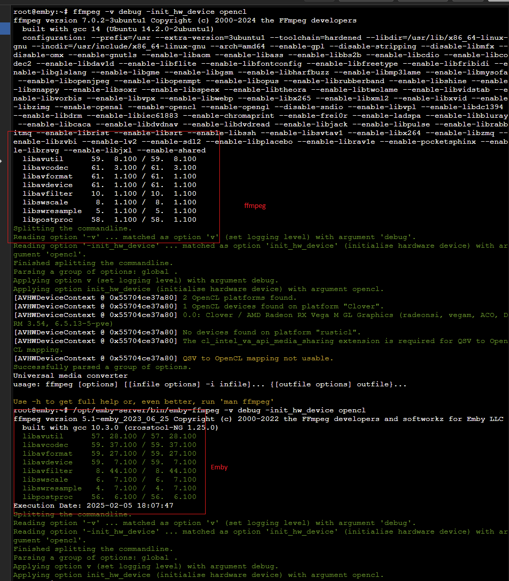

gcorgnet
Just following up on my issue: OpenCL Tone mapping not working on AMD GPU.
Runing the default ffmpeg and runing the one shipped with Emby give me different results.
I noticed that the version of the libva dependencies were all different, with the ones shipping with Emby being seemingly older (see attached screenshot)
Could this be the reason why it fails?
I've also confirmed today that Jellyfin (running on the same Proxmox node, on the same hardware) was able to HW transcode and tonemap the same file so I know it's possible and any help would be appreciated.
I note that according to their documentation, they use Vulkan for AMD. Could this be related?
I would appreciate any response or suggestion on this as I'm getting quite lost.
Thanks

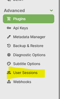

As for the diagnostics window, first you need to install the `Diagnostics Plugin` and then you need to go to `User Sessions` under "Manage Emby Server"
Hope that helps
