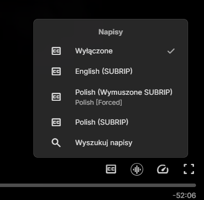

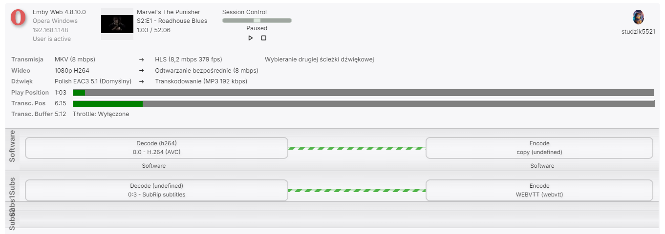

visproduction 283 Posted January 28 Posted January 28 ffmpeg-transcode-fc... 3 x subrip conversions to .vtt at the same time Also line 110+ 13:08:55.493 Stream #0:4(pol): Subtitle: subrip (forced) 13:08:55.493 Metadata: 13:08:55.493 title : Polish [Forced] 13:08:55.493 BPS : 0 13:08:55.493 DURATION : 00:49:15.452000000 13:08:55.493 NUMBER_OF_FRAMES: 5 13:08:55.493 NUMBER_OF_BYTES : 101 So only 5 instances of non-Polish subtitles and this forced sub has to be converted to .vtt. So it will be scanning for only 5 lines in 49 minutes. Does this cause an issue with subrip conversion. This forced sub process looks like it will be looking for 10 minutes screen times with no subs at all inside the forced file. How does the encoder react to this and do the other two suprip conversions at the same time? Guessing this can clog the encoder pretty much. Perhaps upgrade to how multiple subrip subs are handled? Do one only and delay or cancel other subrip conversions? I would guess if you turn off these subrip conversions, or remove them and remux the media, the encoding will work. A lot of encoding software is set to ignore subtitles because such multiple conversions often cause encoding to fail. In this case, two audios in ec3 that probably need conversion and 3 subrips, all at the same time.

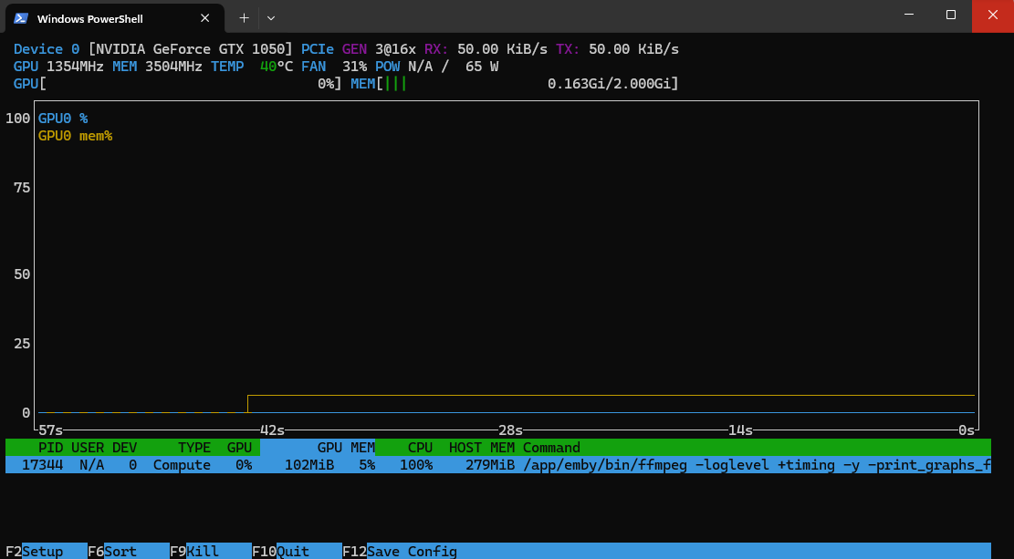

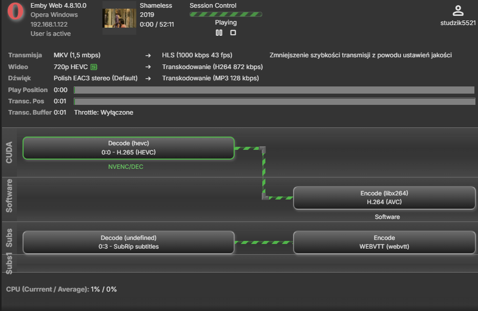

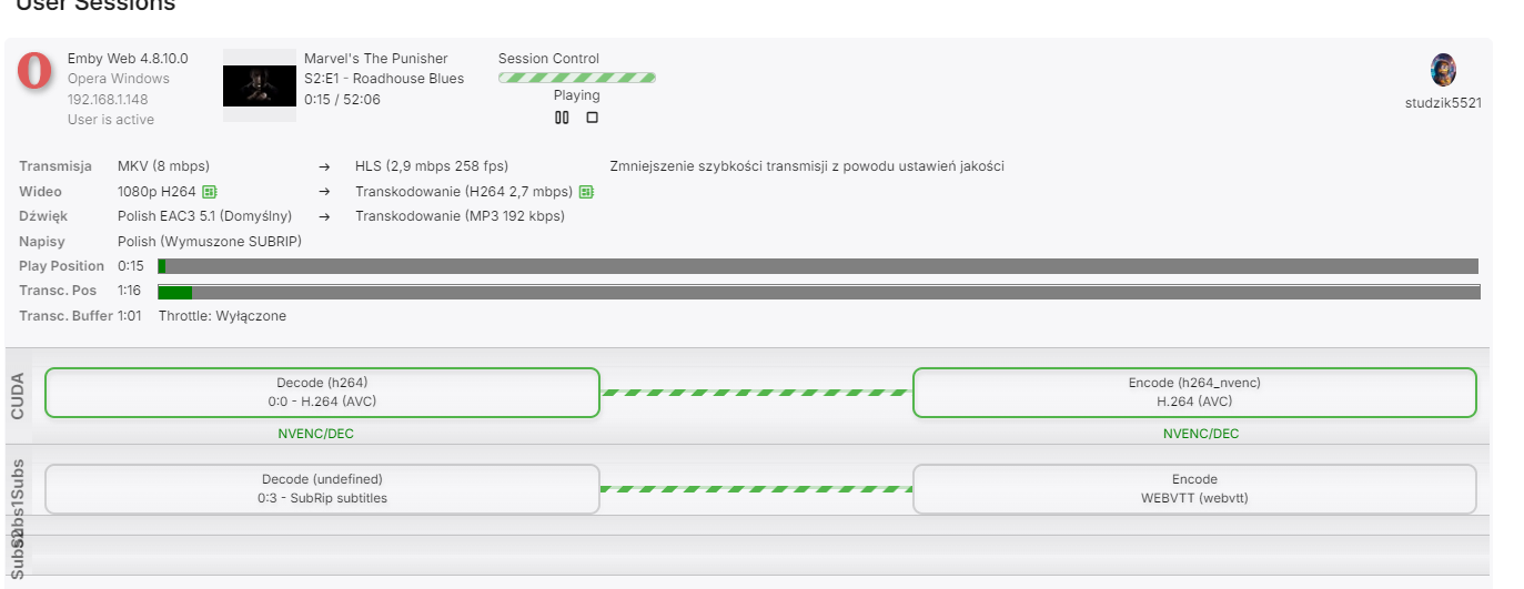

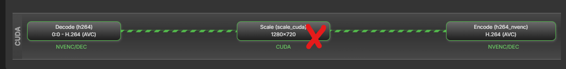

studzik5521 3 Posted January 28 Author Posted January 28 This works when I turn off scaling, even with forced subtitles (ss below) Also works in direct stream. Does not work when scaling from e.g. 1080p to 720p (with scaling enabled) When I try to run a movie, the GPU usage does not increase and the CPU usage is 100% (Subtitles disabled) What could be the cause? Or what to do to diagnose it better?
studzik5521 3 Posted January 31 Author Posted January 31 This occurs in every movie/episode where image scaling occurs. Can anyone help or advise?
visproduction 283 Posted January 31 Posted January 31 Also noticed in Embyserver(111).txt that Subtitles are being scaled to 640 x 360 because they are graphics based Subrip. Since you have three of these subtitles and the main video that also needs scaling at the same time, I would guess you are running into a very intensive workload. Pinning the CPU at 100% while doing all four scaling seems like it could be expected depending on your server setup. Subtitles disabled. OK, what is happening exactly with the software? Are these subrip graphic subtitles turned off? Is there a default subtitle metatag in the media file, that forces one subtitle to be on? Is this subtitle completely ignored when you tell the transcoding to not process? Does ffmpeg still look at the subs? If you really want to test to see if subtitles have an issue, turning them off is not really a test. You need to use a test video with no subtitles and remove the subtitles completely, from your media and try that. If you like metaphores, you may have just turned off the back lights for a trailer you are towing behind your truck, but the truck still doesn't go fast and there are noises coming from behind. Right, try disconnecting the trailer, or find a smaller load that fits in the back of the truck. 1
studzik5521 3 Posted January 31 Author Posted January 31 ok I'll try to "disconnect the trailer" or "lighten the truck" Now I understand that when I "turn off subtitles", I'm actually hiding them, not turning them off. But Iit's strange that 3xsubtitles + movie scaling works on CPU but not on GPU, but I'll check it out. I'll look for movies without subtitles and then I will upload the logs.

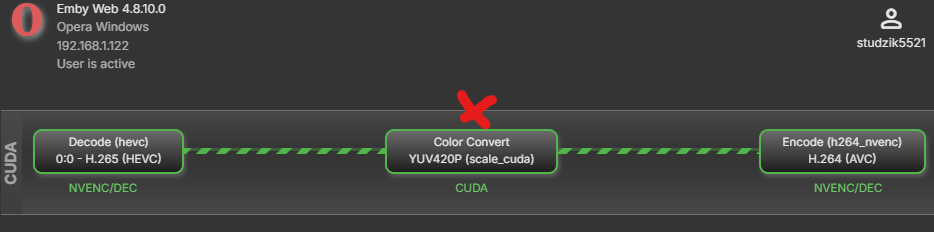

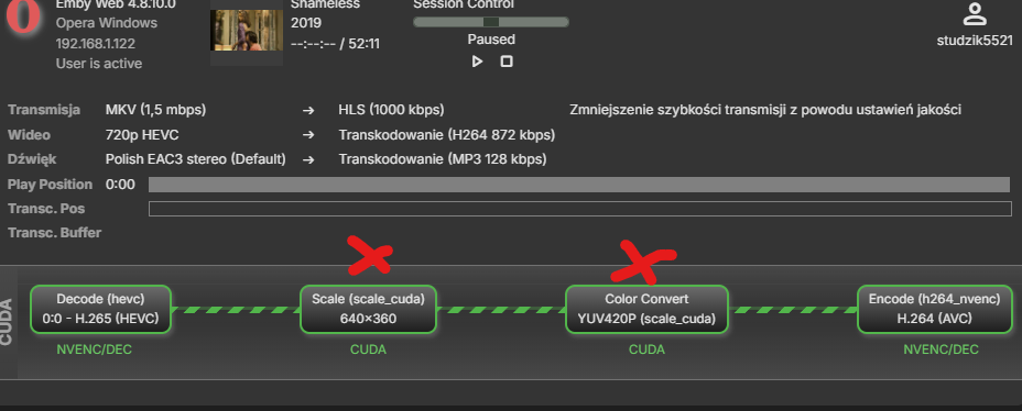

studzik5521 3 Posted February 5 Author Posted February 5 Now I have a problem with "Color Convert YUV420P (scale_cuda)" ffmpeg-transcode-4ad28fa6-3a3a-4de9-8c2c-646e4da28285_1.txtffmpeg-transcode-5c420884-c2ef-4a83-a32e-ec9e0ca61e11_1.txtembyserver (14).txthardware_detection-63874317511.txtffmpeg-transcode-ccd7e403-45c7-43fb-bacb-a25f434d5dfc_1.txt

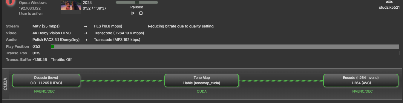

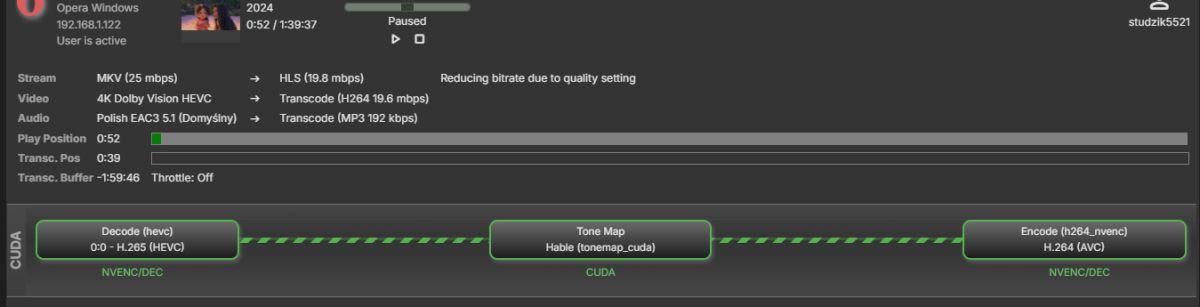

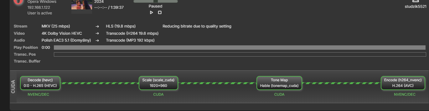

studzik5521 3 Posted February 5 Author Posted February 5 I did the tests on a freshly installed emby on LXC with a different file. Doesn't work: Works: hardware_detection-63874371642.txtffmpeg-transcode-d72f1c98-7f48-4c43-9fda-73912d594d4f_1.txtffmpeg-transcode-a93da27b-35aa-4974-9eb3-317c307a4ea2_1.txtffmpeg-transcode-48437ce0-e997-4824-a619-a441828d4c3a_1.txtffmpeg-transcode-741c95d9-62ca-48d6-bc99-42e33d9148e9_1.txtffmpeg-remux-f65cd5b8-3710-4d6c-a04b-480a0e1be966_1.txtffmpeg-transcode-e78e339a-2591-4201-8cf7-073015757de3_1.txtffmpeg-transcode-688c16ab-5f71-445c-927f-e053aa265cca_1.txtffmpeg-transcode-43c6e6bb-8e4c-49c6-ad01-4be7b7cc7522_1.txtffmpeg-transcode-3b296e8c-6982-4950-abe5-68ac5e47c8cc_1.txt
visproduction 283 Posted February 5 Posted February 5 Wow, that is a lot of info to go through. Not sure if I have enough background to really comment on such transcoding. I did notice that you run scale then Tone Map, then encode. I would guess that running Tone Map before scaling might work better. Any tone map process needs to recognize exact colors per pixel to make adjustments. If you already scaled the media, then per pixel colors will no longer be the same.
studzik5521 3 Posted February 5 Author Posted February 5 These are the default settings, I didn't change anything, the application does it that way. Tone map works. Nothing that uses "scale_cuda" works

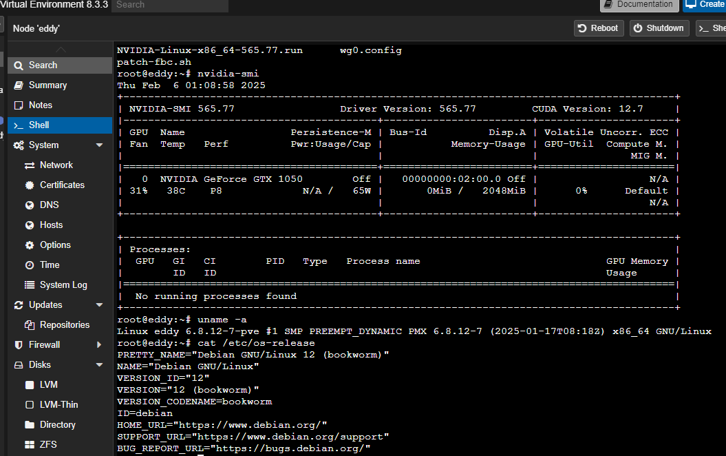

studzik5521 3 Posted February 6 Author Posted February 6 (edited) scale_cuda also does not work directly on proxmox (bare metal, debian) with a different driver version (previously 550.142 now 565.77) hardware_detection-63874400530.txtembyserver (15).txtffmpeg-transcode-f7636e5d-8d3a-4c61-9c9a-a84f3ca5343f_1.txtffmpeg-transcode-b56bc2ed-907b-42d3-ad59-4d956625eafd_1.txtffmpeg-transcode-359699c3-ae4a-4d8d-8091-c0e21804628e_1.txtffmpeg-transcode-30555faf-39a5-44d0-ae2f-33f92ad76844_1.txtffmpeg-transcode-841a1eb6-da12-4d6f-aac7-1a552b100bbe_1.txtffmpeg-transcode-79b849ef-6fea-4373-9cce-019e0af20e59_1.txtffmpeg-transcode-09a573ab-219e-4edf-b45b-b16ee3f8eaef_1.txt Edited February 6 by studzik5521
softworkz 4569 Posted February 7 Posted February 7 On 2/6/2025 at 1:10 AM, studzik5521 said: scale_cuda also does not work directly on proxmox (bare metal, debian) with a different driver version (previously 550.142 now 565.77) There's a crash when ffmpeg tries to access CUDA. How did you install the drivers?
studzik5521 3 Posted February 7 Author Posted February 7 Using the package from nvidia's website "NVIDIA-Linux-x86_64-565.77.run" or earlier "NVIDIA-Linux-x86_64-550.142.run" sudo ./NVIDIA-Linux-x86_64-565.77.run

studzik5521 3 Posted February 9 Author Posted February 9 (edited) I found this in the syslogs Feb 04 12:04:27 eddy kernel: pcieport 0000:00:01.0: AER: device recovery successful Feb 04 12:04:27 eddy kernel: pcieport 0000:00:01.0: AER: Uncorrectable (Non-Fatal) error message received from 0000:00:01.0 Feb 04 12:04:27 eddy kernel: pcieport 0000:00:01.0: PCIe Bus Error: severity=Uncorrectable (Non-Fatal), type=Transaction Layer, (Requester ID) Feb 04 12:04:27 eddy kernel: pcieport 0000:00:01.0: device [8086:6f02] error status/mask=00100000/00000000 Feb 04 12:04:27 eddy kernel: pcieport 0000:00:01.0: [20] UnsupReq (First) Feb 04 12:04:27 eddy kernel: pcieport 0000:00:01.0: AER: TLP Header: 34000000 01000010 00000000 88468846 Feb 04 12:04:27 eddy kernel: pcieport 0000:00:01.0: AER: device recovery successful Feb 04 12:04:27 eddy kernel: pcieport 0000:00:01.0: AER: Uncorrectable (Non-Fatal) error message received from 0000:00:01.0 Feb 04 12:04:27 eddy kernel: pcieport 0000:00:01.0: PCIe Bus Error: severity=Uncorrectable (Non-Fatal), type=Transaction Layer, (Requester ID) Feb 04 12:04:27 eddy kernel: pcieport 0000:00:01.0: device [8086:6f02] error status/mask=00100000/00000000 Feb 04 12:04:27 eddy kernel: pcieport 0000:00:01.0: [20] UnsupReq (First) Feb 04 12:04:27 eddy kernel: pcieport 0000:00:01.0: AER: TLP Header: 34000000 01000010 00000000 90059005 Feb 04 12:04:27 eddy kernel: pcieport 0000:00:01.0: AER: device recovery successful Feb 04 12:04:27 eddy kernel: pcieport 0000:00:01.0: AER: Uncorrectable (Non-Fatal) error message received from 0000:00:01.0 Feb 04 12:04:27 eddy kernel: pcieport 0000:00:01.0: PCIe Bus Error: severity=Uncorrectable (Non-Fatal), type=Transaction Layer, (Requester ID) Feb 04 12:04:27 eddy kernel: pcieport 0000:00:01.0: device [8086:6f02] error status/mask=00100000/00000000 Feb 04 12:04:27 eddy kernel: pcieport 0000:00:01.0: [20] UnsupReq (First) Feb 04 12:04:27 eddy kernel: pcieport 0000:00:01.0: AER: TLP Header: 34000000 01000010 00000000 88468846 Feb 04 12:04:27 eddy kernel: pcieport 0000:00:01.0: AER: device recovery successful Feb 04 12:04:27 eddy kernel: pcieport 0000:00:01.0: AER: Uncorrectable (Non-Fatal) error message received from 0000:00:01.0 Feb 04 12:04:27 eddy kernel: pcieport 0000:00:01.0: PCIe Bus Error: severity=Uncorrectable (Non-Fatal), type=Transaction Layer, (Requester ID) Feb 04 12:04:27 eddy kernel: pcieport 0000:00:01.0: device [8086:6f02] error status/mask=00100000/00000000 Feb 04 12:04:27 eddy kernel: pcieport 0000:00:01.0: [20] UnsupReq (First) Feb 04 12:04:27 eddy kernel: pcieport 0000:00:01.0: AER: TLP Header: 34000000 01000010 00000000 90059005 Feb 04 12:04:27 eddy kernel: pcieport 0000:00:01.0: AER: device recovery successful I found a solution on this page LINK, adding the option "pcie_aspm=off" to the kernel options helped. Unfortunately, this is a workaround. Although the error does not occur, CUDA still does not work. The oldest driver version I was able to install was 535.98, older versions threw an error when compiling the kernel module. Probably proxmox has too new a kernel for older drivers. All these versions had the same problem: 535.183.01, 535.98, 550.107.02, 550.142, 560.35.03 and 565.77 but then I had a problem with the message in syslog. In the next few days I will check nvidia toolkit, other ffmpeg and I will also check emby logs to see if they have changed. Edited February 9 by studzik5521 1
softworkz 4569 Posted February 9 Posted February 9 Probably the pci error is not related to the Nvidia GPU. On the Nviia site where you download the drivers, there's a link for each driver to a huge document which also has section like "Troubleshooting" and "Common Issues". It's a lot to ingest, but maybe something jumps in your eyes which could apply to your system. Like here for driver version 565.77: https://us.download.nvidia.com/XFree86/Linux-x86_64/565.77/README/index.html
studzik5521 3 Posted February 9 Author Posted February 9 I guess it's a problem with proxmox or kernel. Check it later because I don't have the energy to do it now 1
