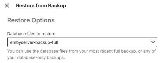

moviesandtv56 8 Posted March 19 Author Posted March 19 the NAS from Western Digital was bad, sent it back, they sent me new one, up and running, all good. thanks for your help..........I backed up my history of last played and the sort order, the director it created was embyserver-backup-full. I looked all over the forums and could not find a how to restore this, the directions for how to back up are excellent, but the info on how to restore I could not figure out, might have been looking in the wrong area. thanks.

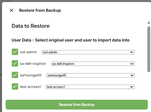

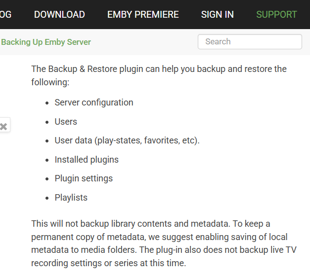

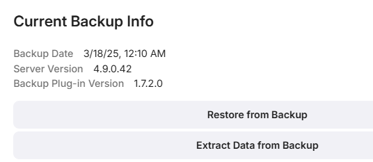

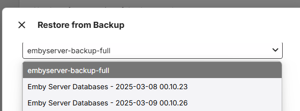

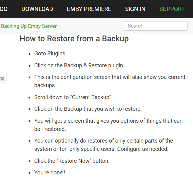

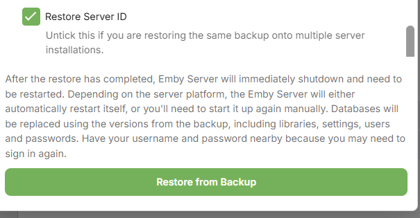

sa2000 410 Posted March 20 Posted March 20 23 minutes ago, moviesandtv56 said: I looked all over the forums and could not find a how to restore this, the directions for how to back up are excellent, but the info on how to restore I could not figure out, might have been looking in the wrong area. I will look into the documentation and screen content when doing a restore. I will summarize what we have currently and would appreciate your input as to which areas need improving The current documentation we have on this support doc: Backing Up Emby Server and for restores When you go through the screens to do a restore, you have a number of options: - Restore from Backup which gives you 2 options: restore from last full backup or restore only the databases from a specific databases only backup - extract user data from the last backup When selecting Restore from Backup, you get the dropdown to either select the last full backup or a databases only backup and the dropdown gives you databases only backups to choose from and when you select the full backup, you have an option to use a new server identifier or keep the existing one and some information on next action If instead you go for the Extract Data from Backup, you get the option to specify specific users to restore 26 minutes ago, moviesandtv56 said: the NAS from Western Digital was bad, sent it back, they sent me new one, up and running, all good. Great, Thanks for the feedback
