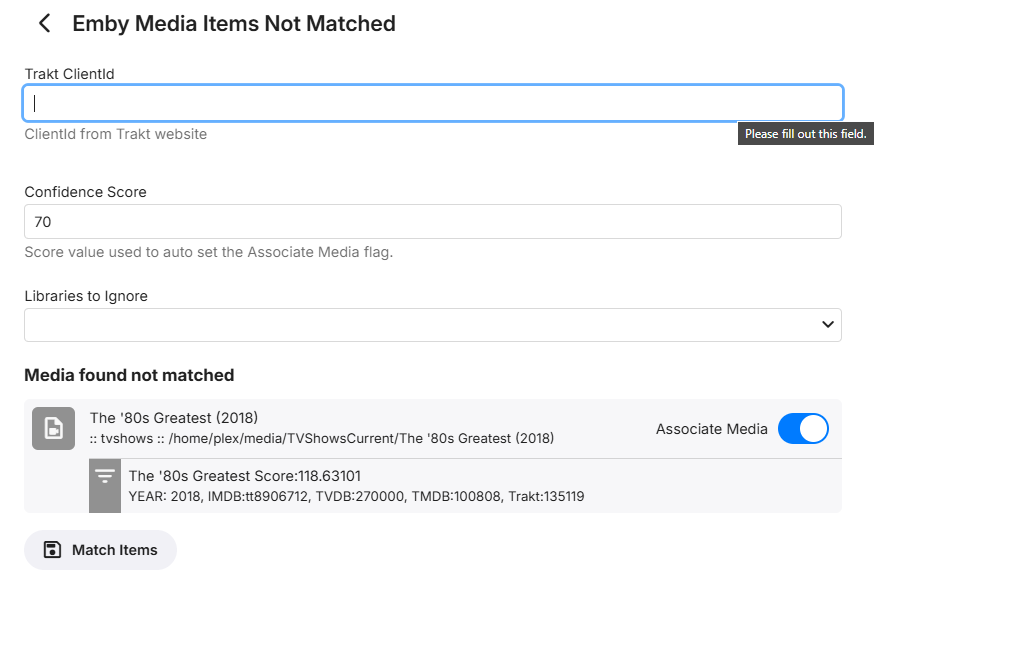

bakes82 160 Posted January 22 Posted January 22 Doesnt the library manager have options to look for missing things like images and what not. I built my own plugin to match items that emby doesnt find or that I reset using trakt, so it pulls all the unmatched items in emby, then uses the folder/file name to search trakt and pulls back what it thinks is the best option, and then if the score is greater than the confidence level I select it will auto select the "associate media" button, and then I can just press "Match Items" and it will issue the match for emby refresh meta, and pull images. So ultimately yes I believe using the library rest/sdk you could probably do what you want. Find items with missing data, loop them issue the metarefresh for those specefic items. 1
