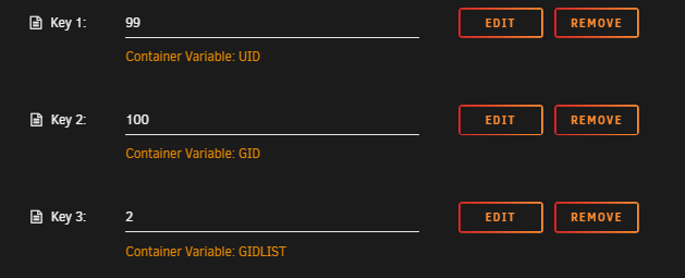

Neminem 889 Posted February 24 Posted February 24 (edited) If you are starting over with unRaid docker, try setting your docker file permissions like this. That way Emby runs as nobody. I think, by default the docker runs as UID 2 GID 2 GIDLIST 2 Edited February 24 by Neminem
salvadordalisdad 8 Posted February 24 Author Posted February 24 19 minutes ago, Neminem said: If you are starting over with unRaid docker, try setting your docker file permissions like this. That way Emby runs as nobody. I think, by default the docker runs as UID 2 GID 2 GIDLIST 2 Thanks, will do.

Neminem 889 Posted February 25 Posted February 25 (edited) 2 hours ago, visproduction said: How 'nobody' user and group works Since unRaid's primary user is root, but nobody is your default permissions for files / folders, it's easier to use nobody as a user in your dockers. Then the docker has access to your files / folders you assign to that docker. And does not require you to edit permissions for Emby to access files, uploaded or created by other dockers. Emby docker by default runs with 2 - 2 - 2, don't remember what user that is. But anyways nice history lessen Edited February 25 by Neminem 1
