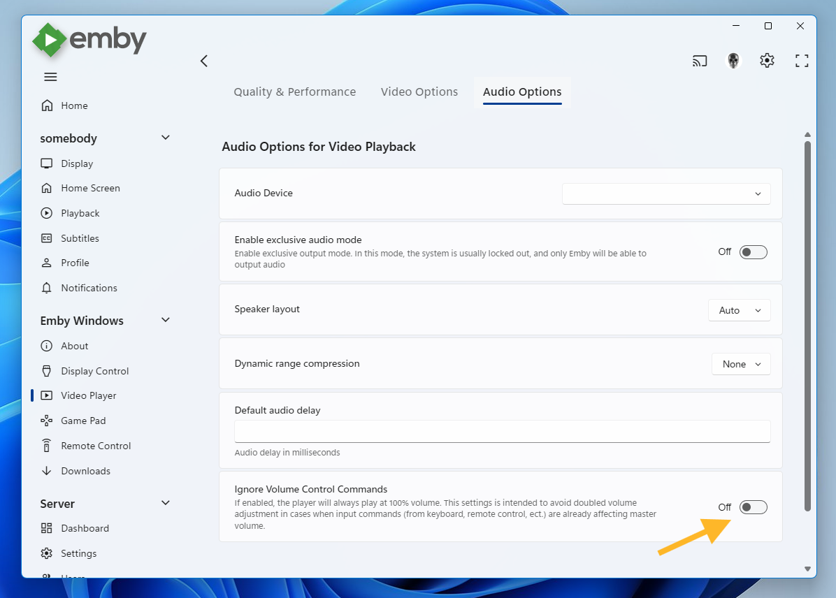

Could it be that you have switched this (new) option on?
Chillout
I have that setting set to "off".  I tried enabling it and it would not let me lower the volume within the app.
My setup is win11 with the OS system sound volume at 50%, my TV soundbar set to 50%, and I use Emby APP volume control to lower the volume as needed.
