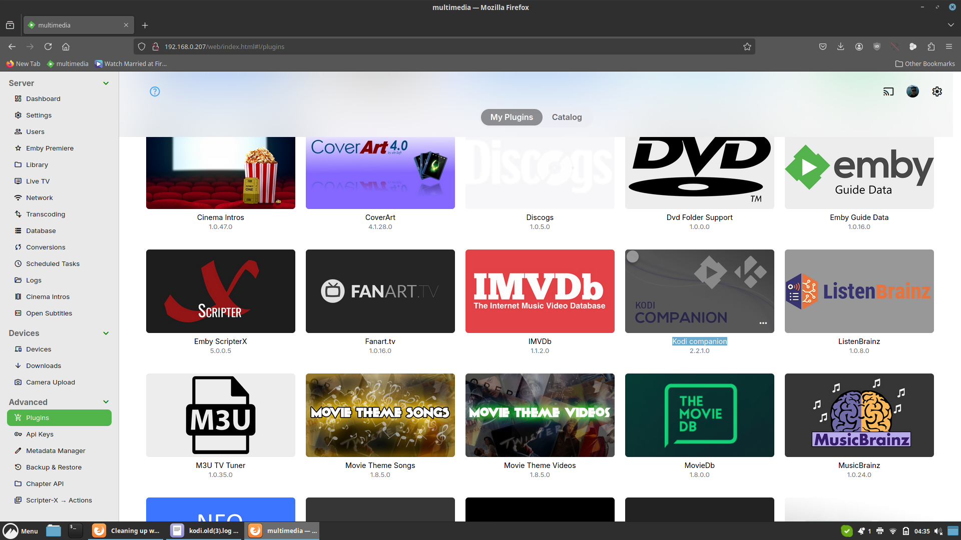

quickmic 1610 Posted January 15 Posted January 15 (edited) btw, if you don't have Kodi companion installed on your Emby server that's probably the issue and has nothing to do with moving files. It's about file deletion in general, but only affects Kodi's (plugins) startup sync. If the issue appears while Kodi is only, it's a different case. Please let me know if this fixes the issue. I'll also perform some tests... Edited January 15 by quickmic

wollabille 16 Posted January 15 Author Posted January 15 4 hours ago, quickmic said: btw, if you don't have Kodi companion installed on your Emby server that's probably the issue and has nothing to do with moving files. It's about file deletion in general, but only affects Kodi's (plugins) startup sync. If the issue appears while Kodi is only, it's a different case. Please let me know if this fixes the issue. I'll also perform some tests... I just googled it and cant find what that is, i have just installed Emby server and nothing else. Only 2 things i did back in the day when i got it was to path the 2 main folders Movies and series and then put in the emby premiere code. I have never fiddled with anything else.
quickmic 1610 Posted January 16 Posted January 16 (edited) 16 hours ago, wollabille said: I just googled it and cant find what that is, i have just installed Emby server and nothing else. Kodi companion is an Emby server plugin. You need to install it to keep track of deleted content while Kodi is offline. Moving files is for Emby servers a content delete action in one folder and add content in another folder. Emby doesn't know that you "moved" files. When Kodi companion plugin is not installed, Emby server doesn't report the deleted content to Kodi, only the added ones and exactly leads to what you reported -> double content. I'll add a notification in one of the next version, if the addon is not installed. Edited January 16 by quickmic 1
wollabille 16 Posted January 16 Author Posted January 16 (edited) Cool thx for the clarification. I have installed it now and will test it with deleting a show im not watching anymore see if its working edit: it worked. so that plugin was the solution MANY THX Edited January 16 by wollabille 1
