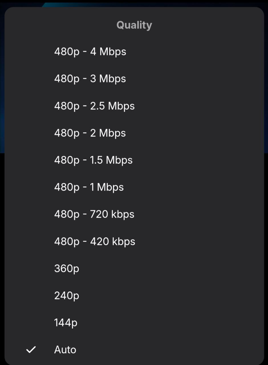

sk222 4 Posted January 13 Author Posted January 13 This reply is only tangentially related to this thread's topic. Also, it seems like the other resolutions aren't supported: #EXT-X-INDEPENDENT-SEGMENTS #EXT-X-STREAM-INF:BANDWIDTH=2147200,AVERAGE-BANDWIDTH=1460800,VIDEO-RANGE=SDR,CODECS="avc1.4d401f,mp4a.40.2",RESOLUTION=640x360,FRAME-RATE=50.000,AUDIO="program_audio",SUBTITLES="subs",HDCP-LEVEL=NONE https://daserste-live.ard-mcdn.de/daserste/live/hls/int/master360p1200.m3u8 #EXT-X-STREAM-INF:BANDWIDTH=8500800,AVERAGE-BANDWIDTH=5640800,VIDEO-RANGE=SDR,CODECS="avc1.64002a,mp4a.40.2",RESOLUTION=1920x1080,FRAME-RATE=50.000,AUDIO="program_audio",SUBTITLES="subs",HDCP-LEVEL=NONE https://daserste-live.ard-mcdn.de/daserste/live/hls/int/master1080p5000.m3u8 #EXT-X-STREAM-INF:BANDWIDTH=5491200,AVERAGE-BANDWIDTH=3660800,VIDEO-RANGE=SDR,CODECS="avc1.640020,mp4a.40.2",RESOLUTION=1280x720,FRAME-RATE=50.000,AUDIO="program_audio",SUBTITLES="subs",HDCP-LEVEL=NONE https://daserste-live.ard-mcdn.de/daserste/live/hls/int/master720p3200.m3u8 #EXT-X-STREAM-INF:BANDWIDTH=2816000,AVERAGE-BANDWIDTH=1900800,VIDEO-RANGE=SDR,CODECS="avc1.4d401f,mp4a.40.2",RESOLUTION=960x540,FRAME-RATE=50.000,AUDIO="program_audio",SUBTITLES="subs",HDCP-LEVEL=NONE https://daserste-live.ard-mcdn.de/daserste/live/hls/int/master540p1600.m3u8 #EXT-X-STREAM-INF:BANDWIDTH=1311200,AVERAGE-BANDWIDTH=910800,VIDEO-RANGE=SDR,CODECS="avc1.4d401e,mp4a.40.2",RESOLUTION=480x270,FRAME-RATE=50.000,AUDIO="program_audio",SUBTITLES="subs",HDCP-LEVEL=NONE https://daserste-live.ard-mcdn.de/daserste/live/hls/int/master270p700.m3u8 I assume Emby uses the first one of these, and the "Quality" menu options are just the transcoding settings? This would explain my confusion in the original post: On 1/11/2025 at 5:48 PM, sk222 said: It works fine with mpv, which also correctly detects the tracks of the stream, which Emby for Android fails to do correctly: Meaning, to make proper use of this M3U8, I have to download and customize it anyway and remove all but one video stream? The three audio tracks seem to be supported, though! #EXT-X-MEDIA:TYPE=AUDIO,LANGUAGE="de",NAME="Deutsch",AUTOSELECT=YES,DEFAULT=YES,GROUP-ID="program_audio",URI="https://daserste-live.ard-mcdn.de/daserste/live/hls/int/masteraudio1.m3u8" #EXT-X-MEDIA:TYPE=AUDIO,LANGUAGE="de",NAME="Klare Sprache",AUTOSELECT=YES,DEFAULT=NO,GROUP-ID="program_audio",URI="https://daserste-live.ard-mcdn.de/daserste/live/hls/int/masteraudio2.m3u8" #EXT-X-MEDIA:TYPE=AUDIO,LANGUAGE="de",NAME="Audiodeskription",CHARACTERISTICS="public.accessibility.describes-video",AUTOSELECT=YES,DEFAULT=NO,GROUP-ID="program_audio",URI="https://daserste-live.ard-mcdn.de/daserste/live/hls/int/masteraudio3.m3u8" But that's a different problem anyway and has nothing to do with the subtitle track apparently crashing ffmpeg. Should I open a separate thread?
