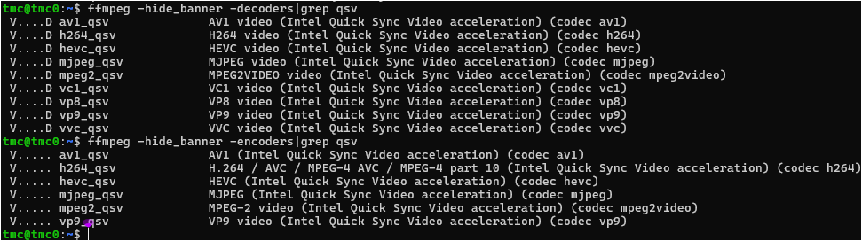

TMCsw 180 Posted April 17 Posted April 17 (edited) UPDATE: Appears this low powered CPU/iGPU may have more ‘Guts’ than I expected… …After: Downloading MediaStack.tar.gz from VPL GPU Runtime 2025Q1 Release - 25.1.4 (Latest) extracting and installing... (edit: forgot rebooting) ...Then recompiling ffmpeg from the latest ffmpeg-snapshot with the newer VPL stuff I now see the following: It would seem that it has HW support for both decoding/encoding of av1 and decoding of vvc via QSV. Although I have not found the correct command line to make av1 work (or from the error output it may be still a work in progress) most others I’ve tried seem fine and the CPU sits nearly idle… But of course, it still does not help emby, even in the beta Edited April 17 by TMCsw 1
