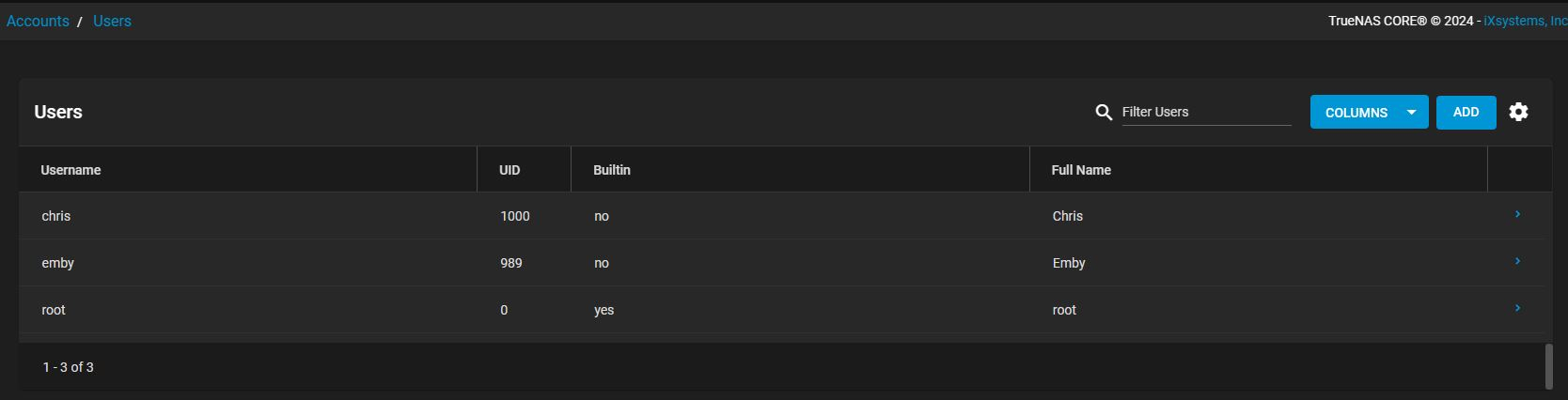

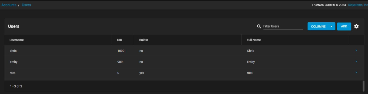

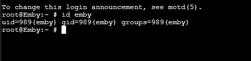

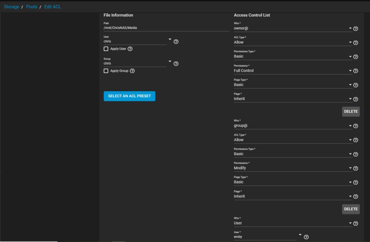

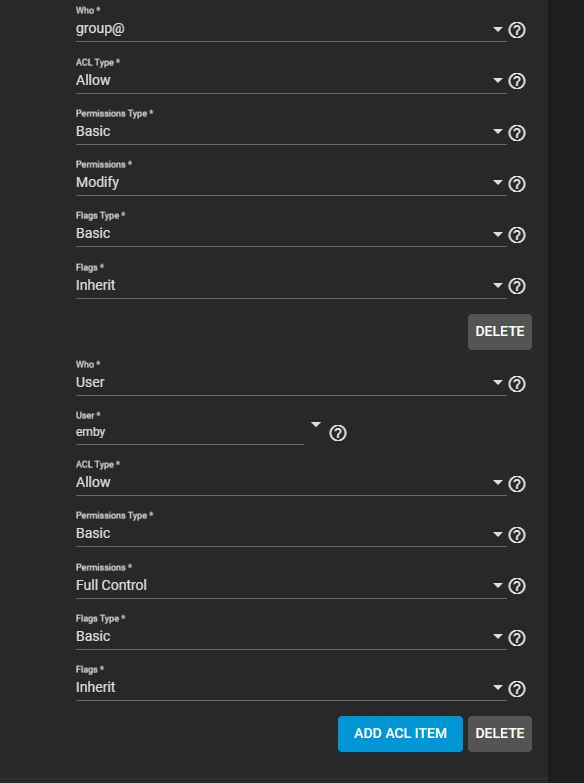

cgcmgr 23 Posted November 10, 2024 Author Posted November 10, 2024 The backup I created was from a working Emby server on Emby 4.8.10.0. The user assigned to it was emby and the UID, GID and groups were all 989. I restored that backup on a new Emby Jail and everything played except for some of the movies. I checked the UID, GID and groups of that new server and it too was emby and 989. I didn't understand why some movies wouldn't play. I have a user named chris and the UID for that user is 1000. So I set the the user emby, in that Jail, to have a UID, GID and group of 1000. This resolved the issue. I still find it odd that one server works fine with emby set as 989. Attached are the permissions. As you can see in one picture (see attachment Exiting server), I ran the command Id emby and it shows 989 associated to emby. That server works without issue and that's the server I backed up and used that backup to restore. I do have my original Emby server from when I first started using Emby and I have that one's emby associated to 1000. I figured, let me try associating the new server to 1000 and that worked (see attachment New Server). Below is a screen shot of my ACL. This is the same ACL associated to all three of my Emby servers (I will be decommissioning the one based on 4.8.1.0 shortly, leaving me just 2 servers) and the ACL is associated to the mount point of each server that points to the same location. So for one server 989 works, but for the other, 1000 works. I'm still a little shaky on permissions, but at least I got it working. Just can't understand why I had to make that change, especially when you can clearly see emby as a user in the ACL. If you can offer an explanation, I'm all ears. Thanks, Chris 1
