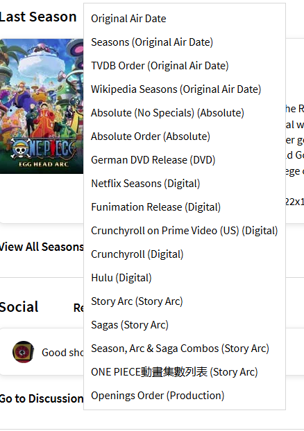

Normunds 1 Posted October 22, 2024 Posted October 22, 2024 I have a following show structure and I wonder if TV show library type could possibly accommodate it (just by dropping it in it does not). All other anime series fit well in one or two levels. I imagine I could merge the lowest levels and add "arc" as part of title. Or maybe use mixed library type only for this series. Or maybe there is a way to leave TV Show and hack this particular entry to use mixed type?

Happy2Play 9445 Posted October 22, 2024 Posted October 22, 2024 (edited) Think technically this would change once Emby actually support all provider alternate order per multiple feature requests TVDB ワンピース - TheTVDB.com or TMDB But will require media to be in expect order when then additional alternate orders are added. Edited October 22, 2024 by Happy2Play
Normunds 1 Posted October 24, 2024 Author Posted October 24, 2024 (edited) Thanks. I guess you are saying that there is no real solution except waiting or re-arranging the episodes Edited October 24, 2024 by Normunds
Happy2Play 9445 Posted October 25, 2024 Posted October 25, 2024 18 hours ago, Normunds said: Thanks. I guess you are saying that there is no real solution except waiting or re-arranging the episodes Technically you can have what you have but would require disabling everything on the library as Emby currently can not get metadata for it as dev has not added the provider support per the links above. So lots of work manually creating metadata for everything. Might get away with other metadata managers providing correct info just have to have Emby only READ metadata.
