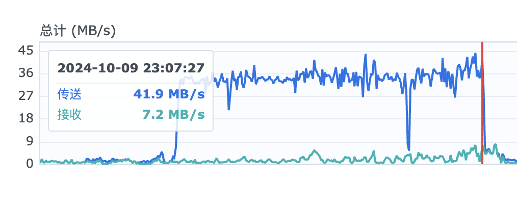

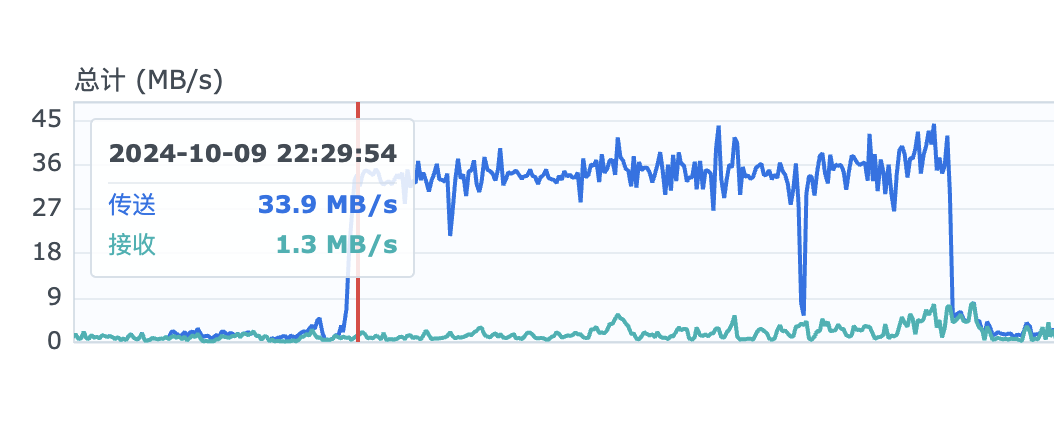

SherlockLin 2 Posted October 9, 2024 Author Posted October 9, 2024 Played to media from 22:29 to 23:07 on 10.9, resolution is 720p and compression format is H.264. Attached is the log file and the time period of the traffic anomaly. embyserver-63864115200.txt
SherlockLin 2 Posted October 9, 2024 Author Posted October 9, 2024 During this time 2 videos were played, the total size was about 1.8G, but as shown in the chart, the upload was over 52G. 57 minutes ago, SherlockLin said: Played to media from 22:29 to 23:07 on 10.9, resolution is 720p and compression format is H.264. Attached is the log file and the time period of the traffic anomaly. embyserver-63864115200.txt 40.89 MB · 1 download

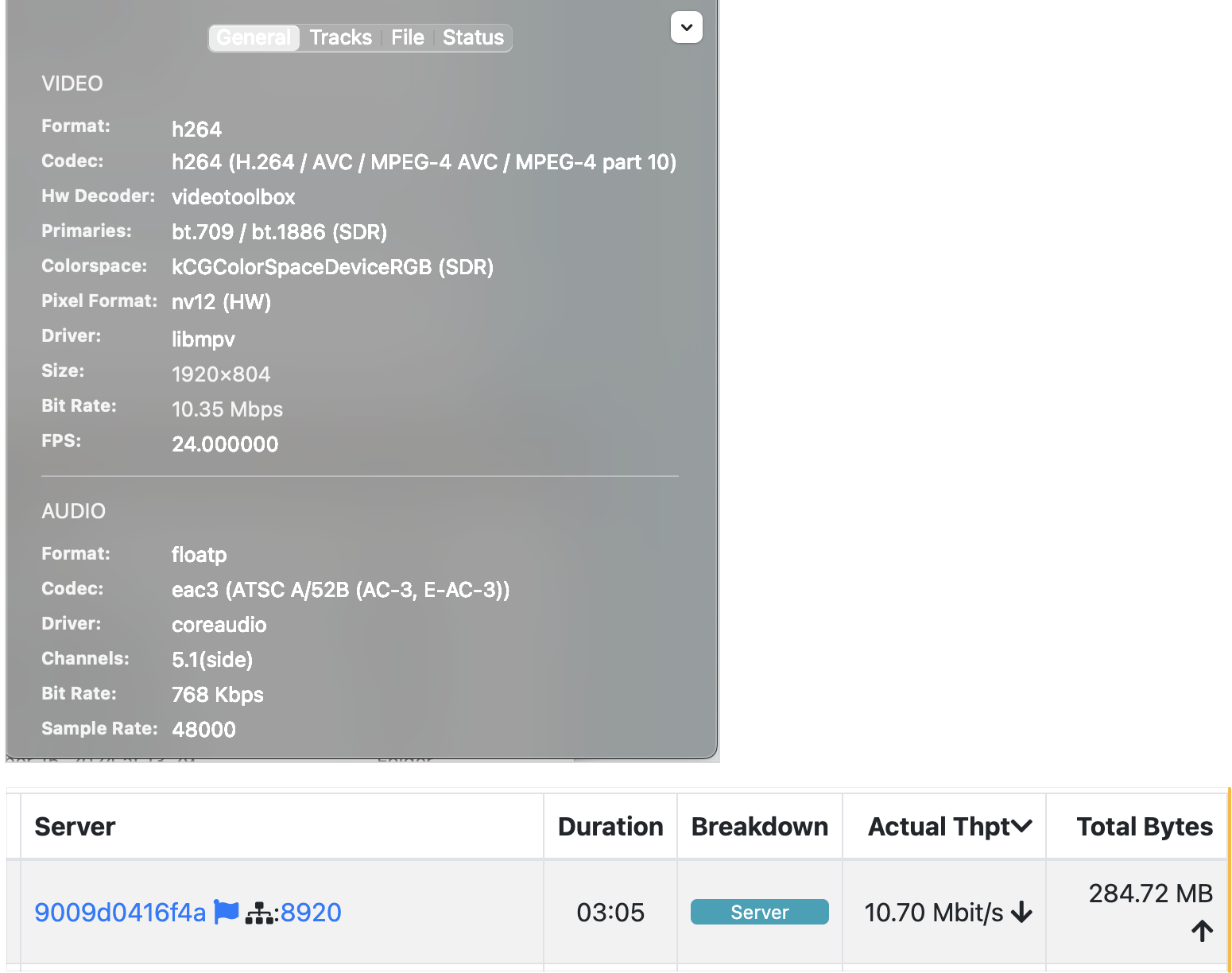

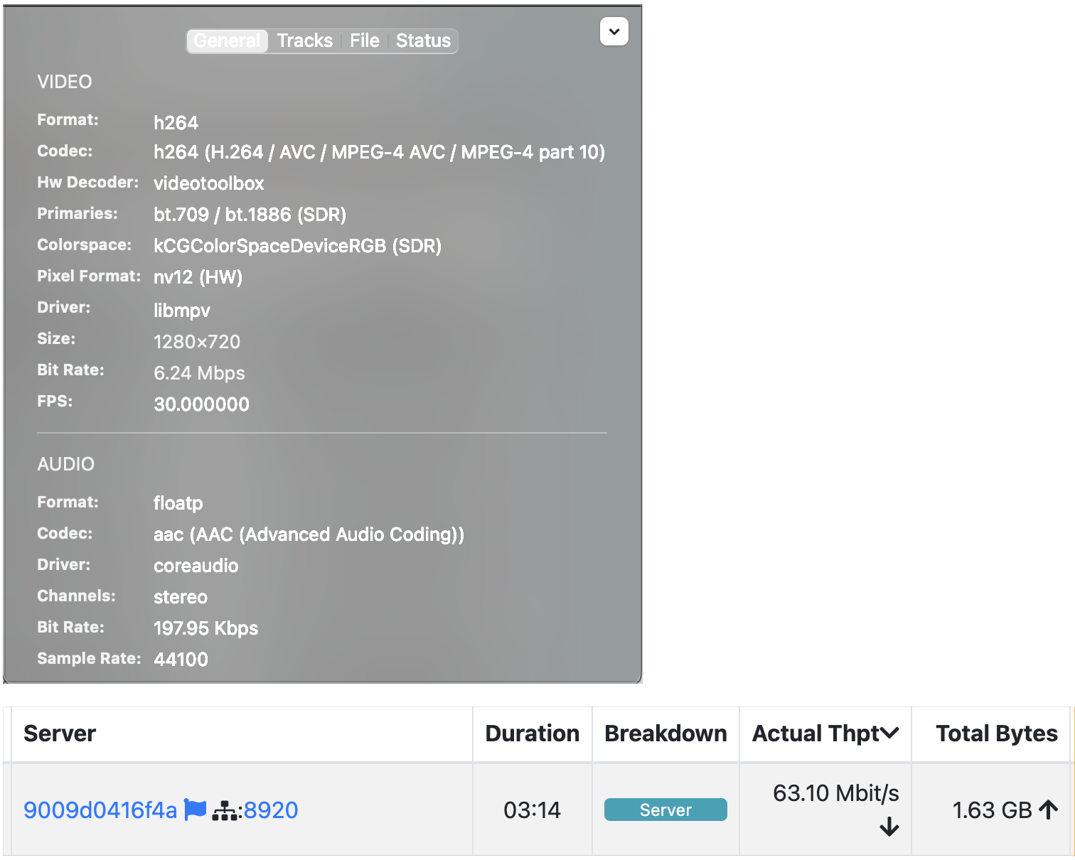

SherlockLin 2 Posted October 9, 2024 Author Posted October 9, 2024 I've found that this issue doesn't seem to have anything to do with the quality of playback the client chooses. It only has to do with the video being played. When I play a 1080p video, it turns out that the bandwidth is lower than 720p. No transcoding, direct play mode , very strange, here is the data comparison:

SherlockLin 2 Posted October 14, 2024 Author Posted October 14, 2024 (edited) On 10/10/2024 at 3:41 AM, SherlockLin said: I've found that this issue doesn't seem to have anything to do with the quality of playback the client chooses. It only has to do with the video being played. When I play a 1080p video, it turns out that the bandwidth is lower than 720p. No transcoding, direct play mode , very strange, here is the data comparison: The screenshot is the data I retested and monitored using ntopng, 8920 is the port Emby is listening on. First image shows the amount of data buffered in about three minutes under normal conditions (284MB), and second image shows the amount of data buffered in three minutes under abnormal conditions (1.63GB). This problem can be reproduced 100%, if you need any help I can test it for you guys. Edited October 14, 2024 by SherlockLin
