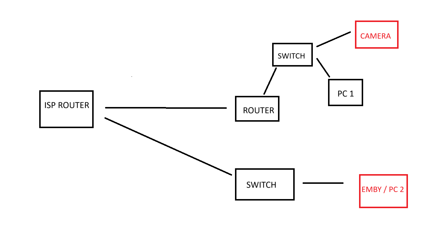

Lessaj 301 Posted August 31, 2024 Posted August 31, 2024 4 minutes ago, Alexmh said: The IP is the same, it won't change, it's binded. (192.168.1.69). So it's the same in the router as it's in Emby app, which detects it automatically anyway. So you're running your cameras off the same host as your emby server?
Alexmh 2 Posted August 31, 2024 Author Posted August 31, 2024 6 minutes ago, Lessaj said: So you're running your cameras off the same host as your emby server? No. My network setup is the following (sorry for my paint skills):
Happy2Play 9459 Posted August 31, 2024 Posted August 31, 2024 20 minutes ago, Q-Droid said: Are you certain that Emby is listening on 7920 and 7921? Accord to the server log posted it is. But would need to see new server log for port change. But there is a routing issue somewhere as in the ISP route if not changing from camera to Emby but that should come back to the portforwarding rule. 1
Lessaj 301 Posted August 31, 2024 Posted August 31, 2024 1 minute ago, Alexmh said: No. My network setup is the following (sorry for my paint skills): Okay but if you're trying to route your exposed port 80 to your emby PC (now also using port 80 locally) instead you would have to change the internal host IP in the rule that you're using for port 80, that's why the cameras are still what's coming up.

Alexmh 2 Posted August 31, 2024 Author Posted August 31, 2024 1 minute ago, Lessaj said: Okay but if you're trying to route your exposed port 80 to your emby PC (now also using port 80 locally) instead you would have to change the internal host IP in the rule that you're using for port 80, that's why the cameras are still what's coming up. Ok let me make it more clear: Camera IP: 192.168.1.111 (Port opened: others, not 80) Emby/PC IP: 192.168.1.69 (Emby port: 80) Gateway: 192.168.1.1 I think I know the problem, now I see the delete command was not applied for the camera port, only the addition of the new port for the emby. The router can't do two operations at once even if they are in the same window. I'll come with updates.
