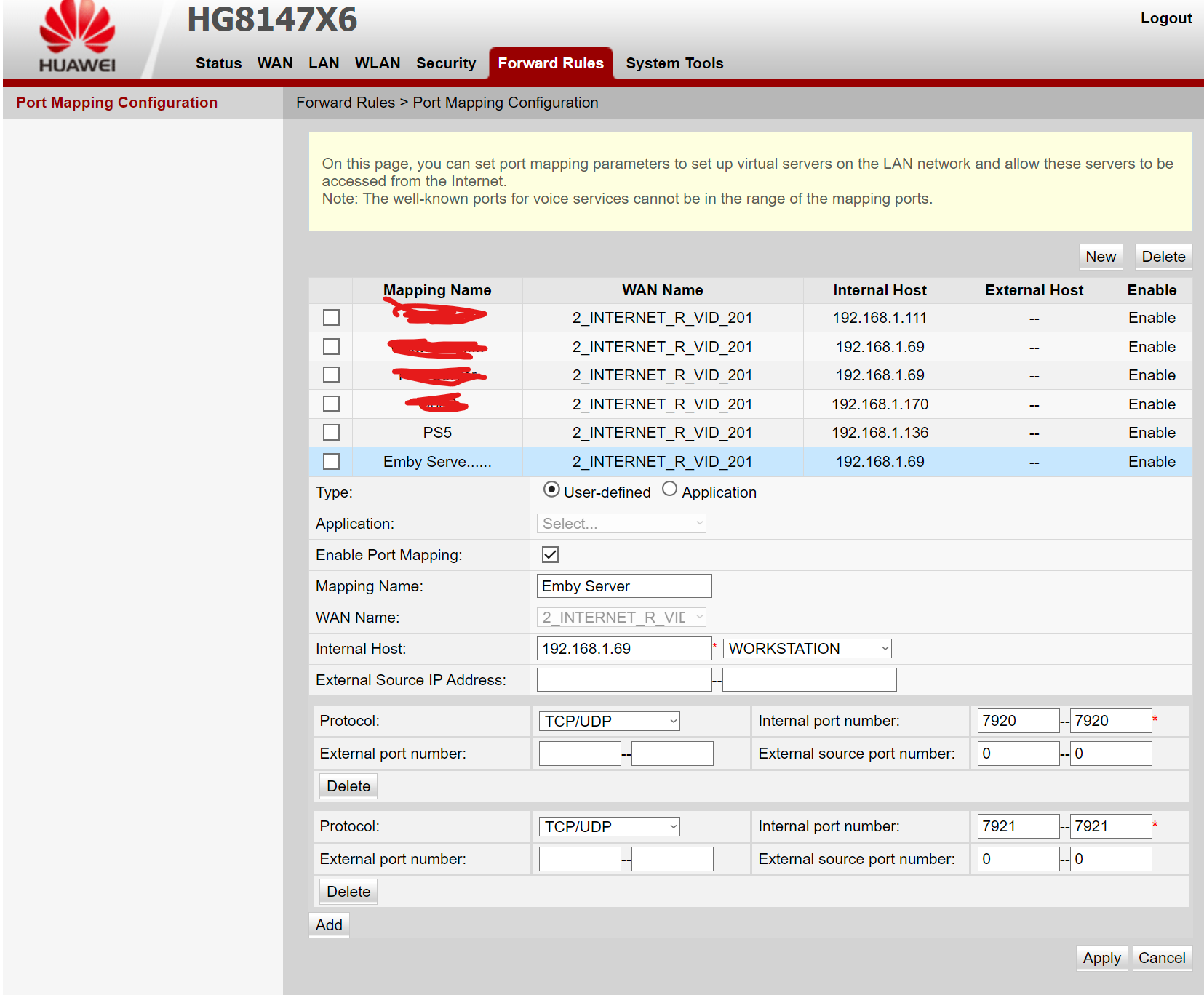

Lessaj 300 Posted August 30, 2024 Posted August 30, 2024 Can you show your port forwarding rules? I think you've incorrectly configured them because I can connect to any port on that address, which shouldn't happen. Tried a whole bunch of random ports and they all connect to something.
Alexmh 2 Posted August 30, 2024 Author Posted August 30, 2024 7 minutes ago, Lessaj said: Can you show your port forwarding rules? I think you've incorrectly configured them because I can connect to any port on that address, which shouldn't happen. Tried a whole bunch of random ports and they all connect to something.
Alexmh 2 Posted August 30, 2024 Author Posted August 30, 2024 10 minutes ago, Lessaj said: Can you show your port forwarding rules? I think you've incorrectly configured them because I can connect to any port on that address, which shouldn't happen. Tried a whole bunch of random ports and they all connect to something. I really don't care about people managing to connect on all ports, because I can easily fix that, I do care that they are able to connect to the Emby server and manage to log in But thank you for the heads up! Usually all the ports are blocked, even the ones that I port forward. It depends on what IP I get assigned. Luckily my power rarely goes out.

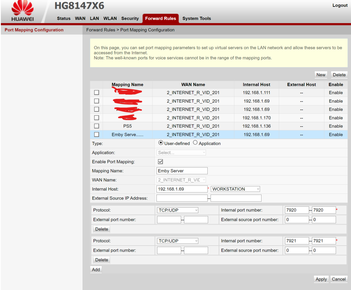

Lessaj 300 Posted August 30, 2024 Posted August 30, 2024 They should actually be only TCP but it doesn't really matter, however you didn't specify the external port number. Try specifying that as well and see if that works. Your other rules should be like that too, you're telling the router "when you see an incoming connection on this port, send it to this host on this port". But without specifying the external port, I guess it's using all of them, which is really strange. 2
Alexmh 2 Posted August 30, 2024 Author Posted August 30, 2024 If I specify the external port and do a "canyouseeme", the port will appear blocked. This is the only way I managed to see this port opened. But I will try again as you said. Btw to have a better comprehension why you can see all ports opened it's because my DDNS comes from my ISP, it's set up by me on their website. The DDNS is redirecting you to my external IP, not to a specific service that I run locally.

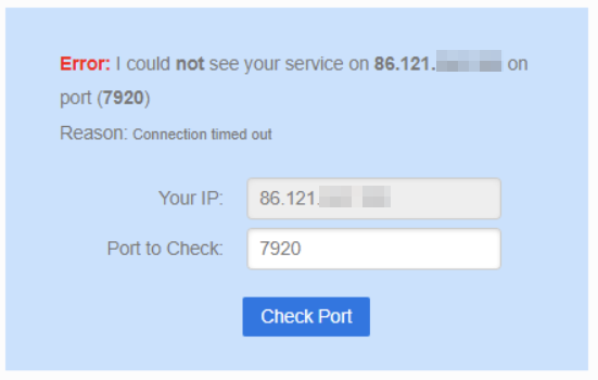

Alexmh 2 Posted August 30, 2024 Author Posted August 30, 2024 (edited) I've changed it as you've said. Now it says that it's not opened, but probably Canyouseeme interrogates through a different port and that's why. Try and connect now. I have no luck using the mobile app at the moment. Edited August 30, 2024 by seanbuff removed public IP
Happy2Play 9446 Posted August 30, 2024 Posted August 30, 2024 2 minutes ago, Alexmh said: I've changed it as you've said. Now it says that it's not opened, but probably Canyouseeme interrogates through a different port and that's why. Try and connect now. I have no luck using the mobile app at the moment. 7920 and 7921 show open for me (but not accessible) but don't recommend posting your address here. Potentially will need a mod to edit that.
Alexmh 2 Posted August 30, 2024 Author Posted August 30, 2024 10 minutes ago, Happy2Play said: 7920 and 7921 show open for me (but not accessible) but don't recommend posting your address here. Potentially will need a mod to edit that. It's no problem. A router restart will fix it The question is now, how do I make them accessible?

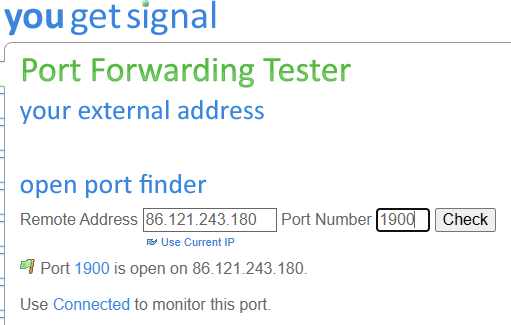

Happy2Play 9446 Posted August 30, 2024 Posted August 30, 2024 Well I primarily input 6000s, 7000s, 8000s, 9000s and all came back open. But specific 1900 show open also. Did no test others as some common ports do show closed.
Alexmh 2 Posted August 30, 2024 Author Posted August 30, 2024 Just now, Happy2Play said: Well I primarily input 6000s, 7000s, 8000s, 9000s and all came back open. But specific 1900 show open also. Did no test others as some common ports do show closed. liars ... they specifically say on their webpage that these ports are closed and I should make a petition to open them if I want
Happy2Play 9446 Posted August 30, 2024 Posted August 30, 2024 (edited) Unless that port test is wrong. Does canyouseeme.org show port 1900 open as they are limited to your WAN address where yougetsignal can input address. Port Checker shows it open also. Overall almost everything appears open so it is a matter of why forwarding is not happening correctly. Edited August 30, 2024 by Happy2Play
Alexmh 2 Posted August 30, 2024 Author Posted August 30, 2024 Yeah 1900 is open for me also. Also I tried again and I see now that 7920 and 7921 are opened again. Also here is a little something from my ISP Port forwarding "tutorial": "For security reasons, the ports in the range "Well-known ports" [0-1023] can be filtered depending on the equipment. It is recommended that a larger port be used for the external port option, for example 8008. For the internal port option, any port can be used. It is recommended that the port forward be done based on the MAC address [DHCP Binding], given the fact that it is possible that the IP allocation by DHCP is not constant. In the case of open port checks, they appear "open" only when a service is running on them."

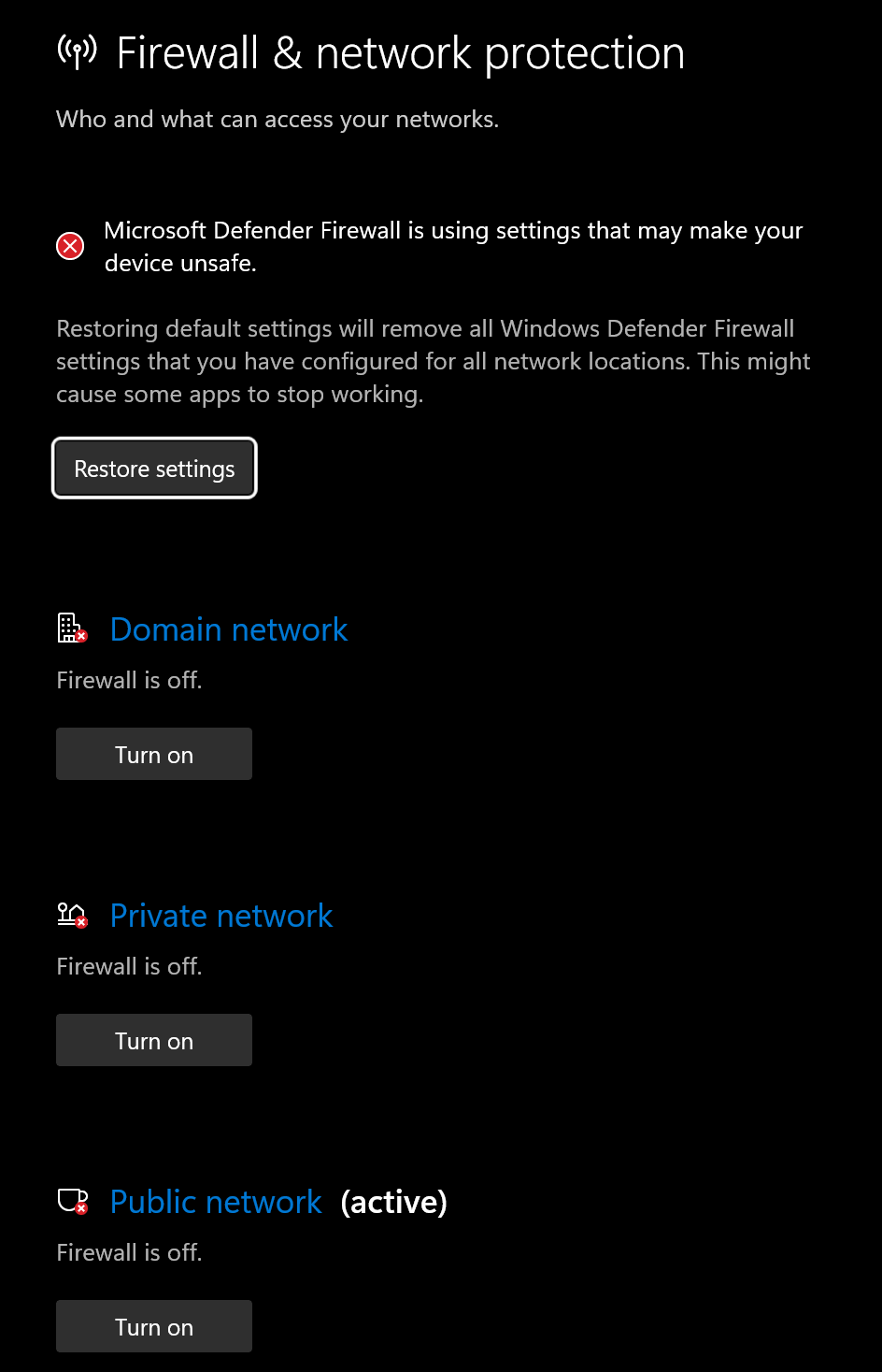

Alexmh 2 Posted August 31, 2024 Author Posted August 31, 2024 Just now, Happy2Play said: If no other client can connect it would suggest a firewall issue, do you have the corresponding ports in your firewall enabled? I completely disabled the firewall and antivirus for testing purposes days ago. There should be no problem.

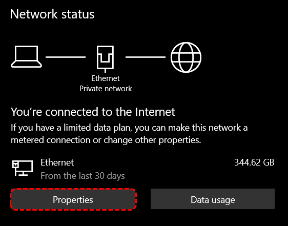

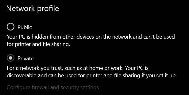

seanbuff 1149 Posted August 31, 2024 Posted August 31, 2024 Also, check your Windows Network Profile, it should be set to 'Private' and not 'Public'
Happy2Play 9446 Posted August 31, 2024 Posted August 31, 2024 Windows Firewall sometimes still does not play nice disabled.
Alexmh 2 Posted August 31, 2024 Author Posted August 31, 2024 Done, it's private now, still no luck. I'll enable the firewall and forward the ports.
