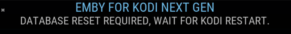

SwanStream 64 Posted September 28 Posted September 28 (edited) Hey @quickmic, new problem. Kodi on Corelec has gone FUBAR. The base kodi seems to be ok, but the e4k install is a mess and I'm I'm trying to 'reset' e4k database. I get to the "database reset required, wait for kodi restart" message.... but restart never happens. I've tried a few times now. Any other way to accomplish a fresh e4k sync? I've got remote access, and ssh via putty but have no idea where the db file on stored in the Coreelec ecosystem. Any help greatly (as always) appreciated. Nevermind. I found the db files. The problem seems to be it was trying to delete cached thumbs one at a time rather than just rm -r each thumb directory... with 19g of thumbnails that's gonna take a minute. I rm'd each sub directory in a few seconds, killed the relavent db files and now am all set. Thanks for all your work on the whole e4k extravaganza, much appreciated. /storage/.kodi/userdata/Thumbnails /storage/.kodi/userdata/Database Edited September 28 by SwanStream iStupid 1
