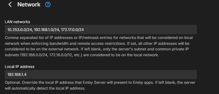

Neminem 810 Posted March 30 Posted March 30 2 hours ago, kingy444 said: For instance “10.122.58.1/32, 192.168.2.0/24” where “10.122.58.1” is the IP of the WireGuard machine inside the VPN and “192.168.2.0/24” is the subnet of the Emby server. Try changing to 10.122.58.0/32 or /24. My setup, that works when connected to my local wireguard vpn server. 10.253.0.0/24 - Wireguard vpn network. 192.168.1.0/24 - local lan 172.17.0.0/24 - docker network
kingy444 113 Posted March 30 Author Posted March 30 6 hours ago, Neminem said: Try changing to 10.122.58.0/32 or /24. My setup, that works when connected to my local wireguard vpn server. 10.253.0.0/24 - Wireguard vpn network. 192.168.1.0/24 - local lan 172.17.0.0/24 - docker network Thanks but unfortunately the list above is only for local LAN networks, I have the /24 listed in the Remote IP filter however and have tried this setting too (however they are remote so I don’t keep them vpn network here) Per above: - Full tunnel works fine on iOS app - Split tunnel (Allowed IPs) can browse but no video playback - Full + Split tunnel work on Safari browser on same device - Above scenarios are on mobile data, remote wifi works as expected via iOS app - As the app can browse on mobile data and it’s only playback that fails my deduction is that the app is routing the media playback differently to the browser version (which again works in all scenarios so the split tunnel is working)
