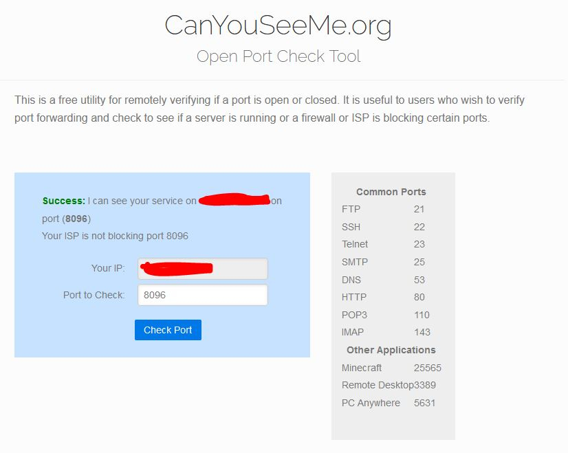

smody121 3 Posted August 12, 2024 Author Posted August 12, 2024 (edited) It's a bit tricky as you know since I'm testing inside my home and it's not always going to work just turning off the wifi on my phone and trying to get back in to the Emby server "remotely". On the port forwarding testing side: I have tried https://canyouseeme.org/ as well as downloading the Port Forward Network Utilities desktop software to test open ports as well. I use a Netgear Orbi RBR 850 as my home router, very easy to configure this router. I have forwarded ports 8096 and 8920, understand it doesn't matter which local IP address to use but at this point I'm not able to get either tool to recognize the open port, so that's probably an issue that needs resolving. Edit: I've gotten it to recognize the open port again, so good there. Still having the same problems as below though... To your question on how I've tested the connection to the Emby server externally, I turned off the wifi on my phone, and reopened the Emby app. The options were: Connect to the Emby server through the internal IP address Connect to the Emby server with Emby Connect Add a server Downloads folder Emby connect isn't working, it just takes me back to this screen above as soon as I enter my credentials, looping on itself forever. When I try manually typing in the external IP address provided by the Emby Dashboard, it does not recognize the server. When I go back to the documentation from Emby, it says the port must be forwarded if the auto port mapping doesn't work (which it didn't), so back to the problem at the top of this comment. Feels like I'm just going in circles. Edited August 12, 2024 by smody121

smody121 3 Posted August 17, 2024 Author Posted August 17, 2024 On 8/14/2024 at 1:35 PM, Luke said: OK I would suggest checking out our Connection Troubleshooter: Connectivity Please try the steps listed there and let us know which ones succeed and which ones do not. Thanks ! Followed the guide: Largely skipped the internal connections section as my connection is already fine on the WiFi network across all devices I did double check that "Allow remote connections to this server" was checked in both the Network and Users (nice cameo in the Users section lol) settings and "Enable automatic port mapping" was unchecked in the Network settings I also opened port 8096 in my Windows Firewall External connections still not working I opened a browser on my cell phone with my WiFi turned off, pasted in the external URL provided by Emby (Remote WAN Access address) and after ~2min the page showed the error: Webpage not available. net::ERR_CONNECTION_TIMED_OUT Triple checked that automatic port mapping was still unchecked Port Forwarded 8096 as directed (verification attached) Only have the one RBR850 router, no need to address double NAT Triple checked the Users all have been granted remote server access through the Emby settings Was directed to the remote connection guide Tried running automatic port mapping again using the stated procedures and came back with the same issues I'm having now "You will need to forward TCP Port 8096 on your router to port 8096 on the Emby Server machine. Do the same for port 8920 as well (if using SSL)." I don't actually know what this guide is trying to say with this sentence. I did not take any steps to "forward 8096 from the router to the Emby server", the server address was provided by Emby, and I port forwarded the port number using the IP address of my desktop computer (not my Synology NAS). I would assume that made this "forward" occur, but lmk if I need to do something not explicitly stated in this guide I did set up DHCP for both the NAS and my desktop though It says next that if my connection still doesn't work (it doesn't) then it could be a CG NAT issue from my ISP and that I should visit the forums... here I am. My external IP provided by Emby is NOT within the CG NAT range listed on the guide of 100.64.0.0 - 100.127.255.255 I ran tracert 8.8.8.8 in a command prompt on my desktop, none of the resulting lines started with 172, 10 or 192. They started with 173, 72 and 142 No firewall issues or VPN running in the background Emby Connect seems useless if I can't get the remote connections to work, but like I said above, when trying to access Emby through the app it puts me in a login loop So yea... still not having any luck here.
seanbuff 1092 Posted August 17, 2024 Posted August 17, 2024 29 minutes ago, smody121 said: I did not take any steps to "forward 8096 from the router to the Emby server", the server address was provided by Emby, and I port forwarded the port number using the IP address of my desktop computer (not my Synology NAS). I would assume that made this "forward" occur, but lmk if I need to do something not explicitly stated in this guide Little confused by this bit. If your Emby Server is installed on your Syno NAS, then you need to port forward 8096 in your router to your the local IP of the docker container on your NAS (get this from the Emby dashboard). Your desktop is irrelevant here. But since your canyouseme test shows success then I'm guessing it's from the auto port mapping.
Neminem 791 Posted August 17, 2024 Posted August 17, 2024 Or Jellyfin is also installed, since they use same ports. 22 minutes ago, seanbuff said: But since your canyouseme test shows success then I'm guessing it's from the auto port mapping. 1
smody121 3 Posted August 17, 2024 Author Posted August 17, 2024 42 minutes ago, seanbuff said: Little confused by this bit. If your Emby Server is installed on your Syno NAS, then you need to port forward 8096 in your router to your the local IP of the docker container on your NAS (get this from the Emby dashboard). Your desktop is irrelevant here. But since your canyouseme test shows success then I'm guessing it's from the auto port mapping. Thank you, this is where I thought I may be going wrong before. What's confusing me is that the canyouseeme worked when mapped to my desktop but my auto port mapping was turned off. When I switch the IP address from the desktop to the NAS, canyouseeme stops working whether I've auto port mapped or not. I believe I may be using the wrong IP address to port forward. Which IP address from the NAS should I be using to port forward, is it the local IP that my router recognizes as my NAS? That's what I've been using. 19 minutes ago, JayceDK said: Or Jellyfin is also installed, since they use same ports. Did not know this was a thing. I did in fact try and use Jellyfin before Emby, so still had a Jellyfin container on my NAS but did not have it on my desktop. I deleted the container just to clean it up.
seanbuff 1092 Posted August 17, 2024 Posted August 17, 2024 2 hours ago, smody121 said: Which IP address from the NAS should I be using to port forward, is it the local IP that my router recognizes as my NAS? Did you try this? 3 hours ago, seanbuff said: the local IP of the docker container on your NAS (get this from the Emby dashboard).
