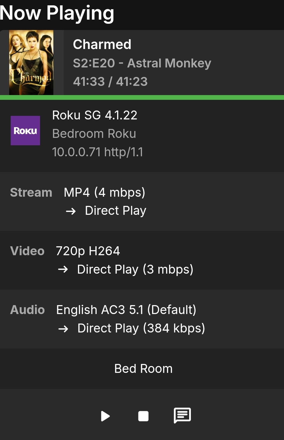

davedick 19 Posted July 4, 2024 Posted July 4, 2024 (edited) On the Roku, Emby won't automatically move to the next episode (time line shows 1 second remaining). Now playing in the server still shows the episode, even after "home" is pressed on the remote. Tried with Emby on Xbox, and it did automatically move to the next episode. Looks like playback time is longer than video time Edited July 4, 2024 by davedick

davedick 19 Posted July 4, 2024 Author Posted July 4, 2024 To clarify, I usually will press back after the video stops (like I described) to go back a few screens (usually to the emby main screen) then I'll push home. I probably can reproduce is, as it looks like it happens with multiple episodes. Would doing a server restart, then watching the video help as far as the logs go?

davedick 19 Posted July 10, 2024 Author Posted July 10, 2024 On 7/7/2024 at 1:39 PM, speechles said: @davedickCan you share that file with us via dropbox, google drive, or similar? Would need the exact file to reproduce your issue then we will know what is causing this. I cannot reproduce with any files I have locally unless transcoding. Yours appears to cause the issue while direct playing. Can you please share with us? Thanks. Not sure where I could upload the file because of the type it is. That being said, When I made the OP, I used DvdFab 13 to rip and noticed it had a audio/mouth sync issue, so I used MakeMkv to re-rip. Now here's what's interesting, I have two different Roku's 4800x Roku Ultra and 4662 RW Roku Ultra LT. The 4800x doesn't freeze, but the 4662 does.
