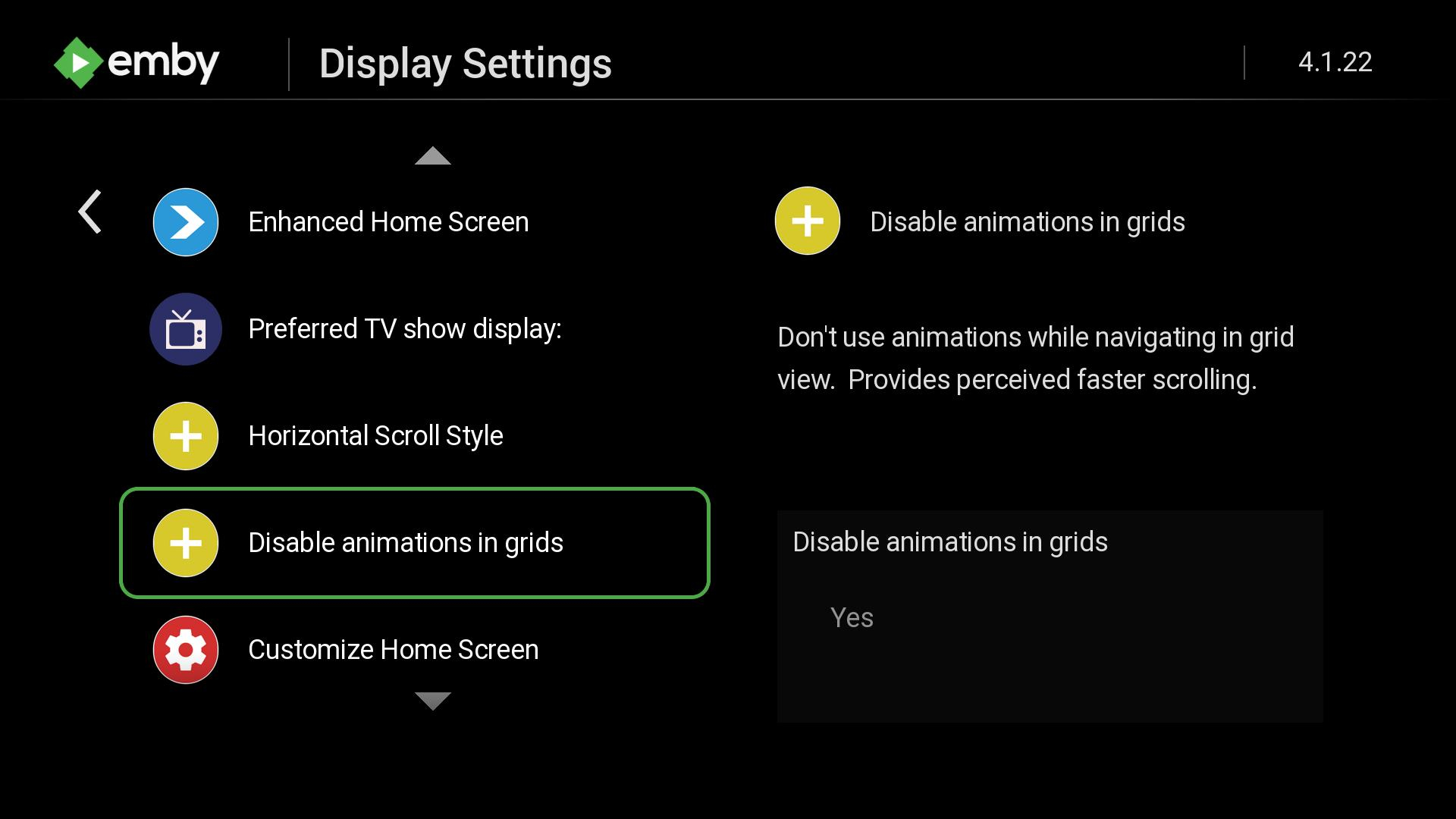

speechles 2001 Posted May 25, 2024 Posted May 25, 2024 @Blam84@Gilgamesh_48If you enable skip animations in the Display settings of the app does the misalignment still happen? You will notice with the skip animations enabled that scrolling is immediate and it behaves much more like the web app does in TV mode. 1
Gilgamesh_48 1098 Posted May 25, 2024 Posted May 25, 2024 3 minutes ago, speechles said: @Blam84@Gilgamesh_48If you enable skip animations in the Display settings of the app does the misalignment still happen? You will notice with the skip animations enabled that scrolling is immediate and it behaves much more like the web app does in TV mode. I have just changed that setting and it appears that the problem is fixed. Thanks. However I never knew what that setting actually did and I left it in the "Show animations" since it was the default. I never changed it because I saw nothing wrong in operation. I will change this setting on my bedroom Roku as well and run with it. I hope the problem is really gone for me but I still do not know what the setting did/does and if it is at all important. In my use I do not see any difference if it is on or off but I may just not be seeing or looking for that differences. Again, thank you for looking into this and finding at least part of the problem. Maybe the code that animates stuff needs looking at to prevent other maybe serious problems. Are there any other bugs in the settings that I need to keep a look out for?

ebr 15579 Posted May 26, 2024 Posted May 26, 2024 On 5/25/2024 at 1:41 PM, Gilgamesh_48 said: but I still do not know what the setting did/does Does this not explain it?
Gilgamesh_48 1098 Posted May 26, 2024 Posted May 26, 2024 1 minute ago, ebr said: Does this not explain it? Not really as I don't understand the "word" "animation" in this context. With "animations" disabled the scrolling looks exactly the same as it did before except the display does not screw up on return from a movie. Of course my old eyes might not be noticing the difference or I may prefer it so much that my old brain dismisses the differences as just proper operation. I can confirm that this really does fix my problems because there have been several times over the last day or so that I preformed actions that would before screw up my display and the display was always fine. Thanks.
ebr 15579 Posted May 26, 2024 Posted May 26, 2024 2 minutes ago, Gilgamesh_48 said: the scrolling looks exactly the same as it did before It doesn't behave the same. With animations enabled, you will see a "smooth scrolling" effect as the posters animate from one position to the next. With them disabled, the posters simply snap into the next position. Perhaps "Enable Smooth Scrolling" would be a better term to use...
Gilgamesh_48 1098 Posted May 26, 2024 Posted May 26, 2024 Just now, ebr said: It doesn't behave the same. With animations enabled, you will see a "smooth scrolling" effect as the posters animate from one position to the next. With them disabled, the posters simply snap into the next position. That difference is tiny to me. Others may notice it but I do not really see it. I can confirm there is a difference (I just tested) but the 'animations," to me, look worse and having them off does not produce the "bug" and the lack of the bug is a HUGE difference cosmetically. As I have said before the cosmetics of Emby is not real important to me but it is better for any interface to look good than not and, in this case for me, no animations look better than "animations." Thanks.
Erik 123 Posted May 27, 2024 Posted May 27, 2024 On 25/05/2024 at 13:17, speechles said: @Blam84@Gilgamesh_48If you enable skip animations in the Display settings of the app does the misalignment still happen? You will notice with the skip animations enabled that scrolling is immediate and it behaves much more like the web app does in TV mode. Hey @speechlesI cannot find my original thread on this so I missed it was implemented. Just wanted to say a big thank you as I really appreciate the option to disable the animations and the UI feels very crisp movement again. Thanks!
