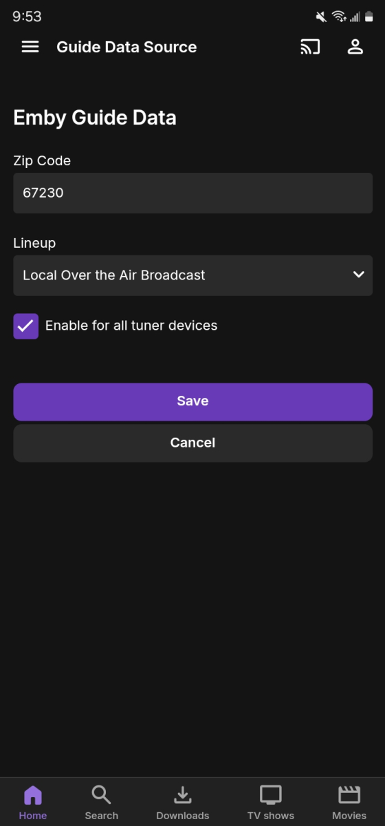

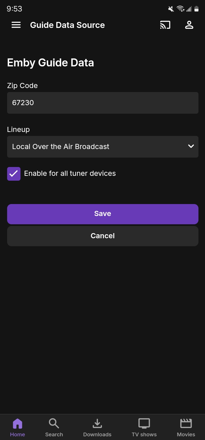

Luke 40000 Posted May 20, 2024 Posted May 20, 2024 Can you double check the config screen to see this what is configured? Thanks.
n0tanks87 6 Posted May 20, 2024 Author Posted May 20, 2024 5 minutes ago, Luke said: Can you double check the config screen to see this what is configured? Thanks. This screen?
