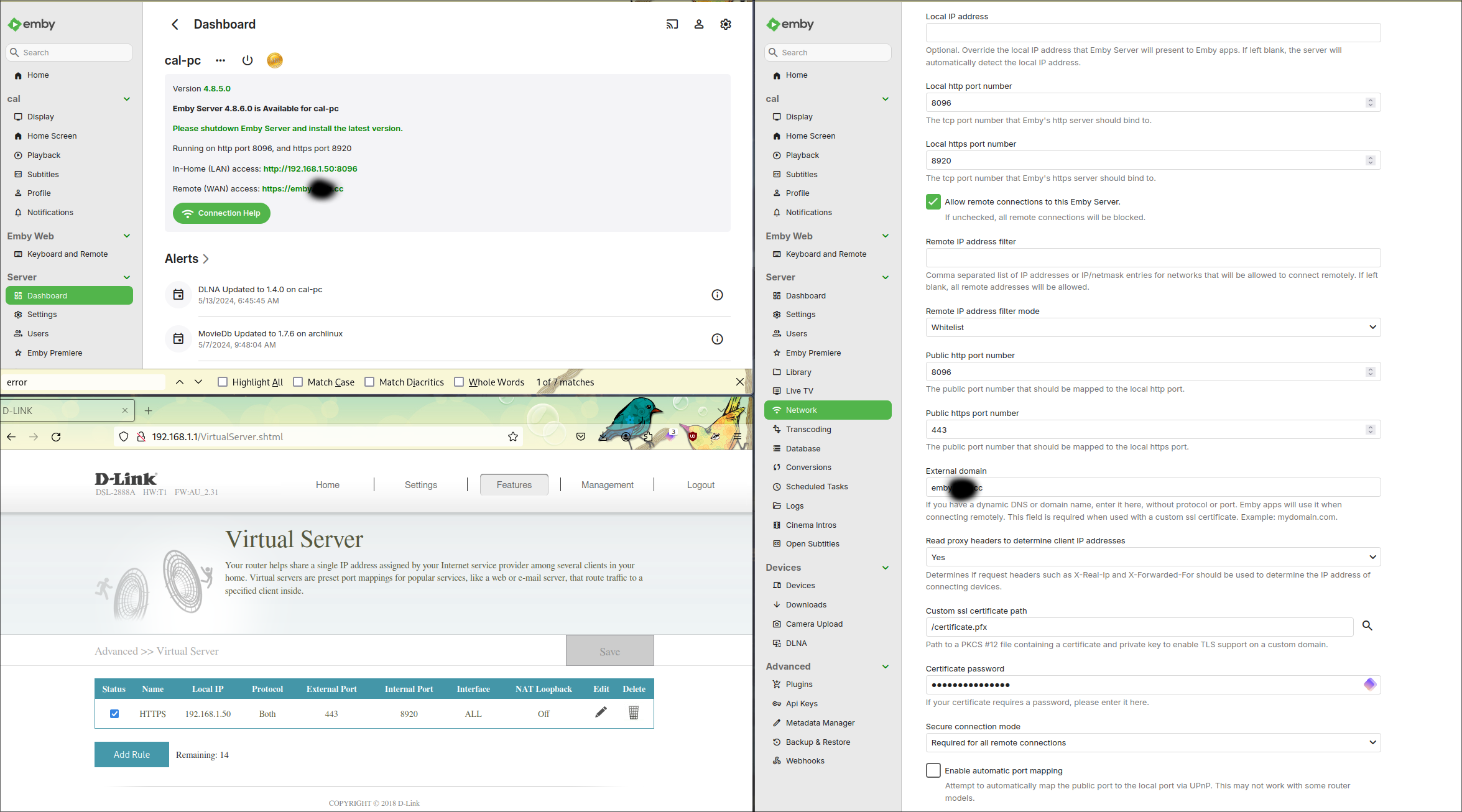

I'm losing my mind, what am I doing wrong?
I have tried with and without the automatic port forwarding option in Emby, and with or without adding manual forwarding per picture.
I can connect to https://emby.xxx.cc fine off my phone (different network), but it does say insecure even though it is https verified by ZeroSSL
I cannot see any errors in the latest log, but with automatic port forwarding there was an error to do with duplicate port mappings or something.
Alexa mainly tells me "Error connecting to your emby user", when I was setting up SSL it did say some other errors like connection or skills issue.
Test prompts: "ask m. b. home who is the active user?" (usually no response) & "tell m. b. home to change user to cal" ( error connecting to your emby user) & "tell m. b. home pause" (emby.thumb.png.507bc04c9b3a439ea1db8e39a48715f8.png error connecting to your emby user)
embyserver.txt
**FIXED AND WORKING**
if anyone finds themselves in same boat, the above screenshots was correct (except i changed secure connection mode to required for all remote connections) but the SSL was not good enough. When I now connect from outside of home network, it shows as SSL secured connection and now alexa is working fine.

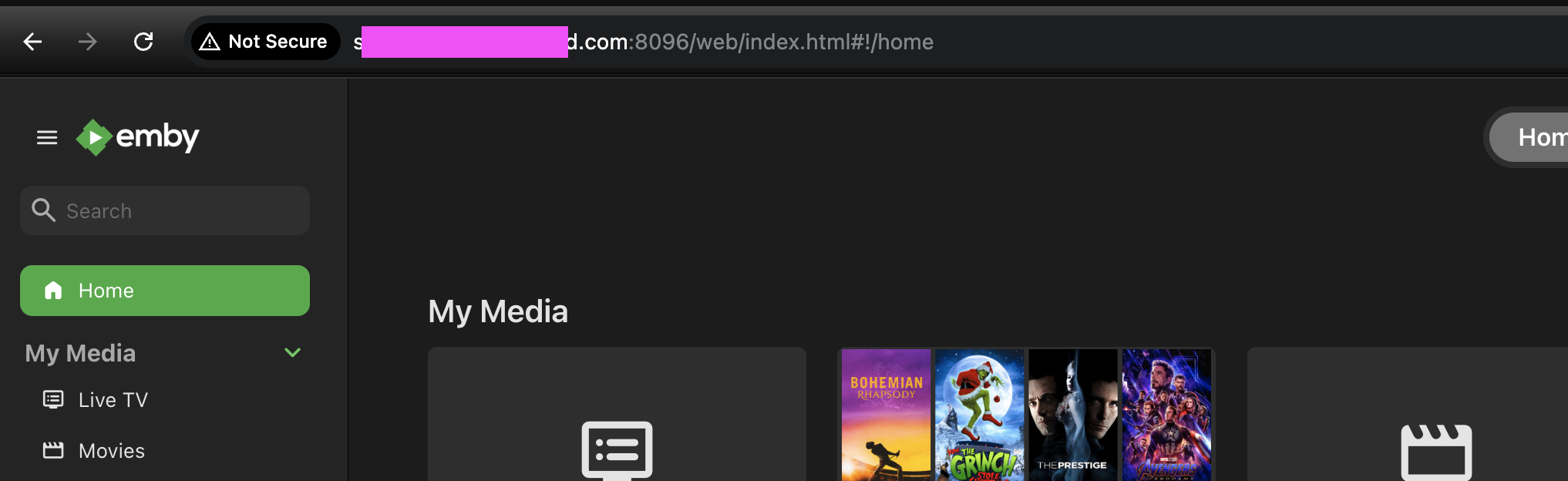

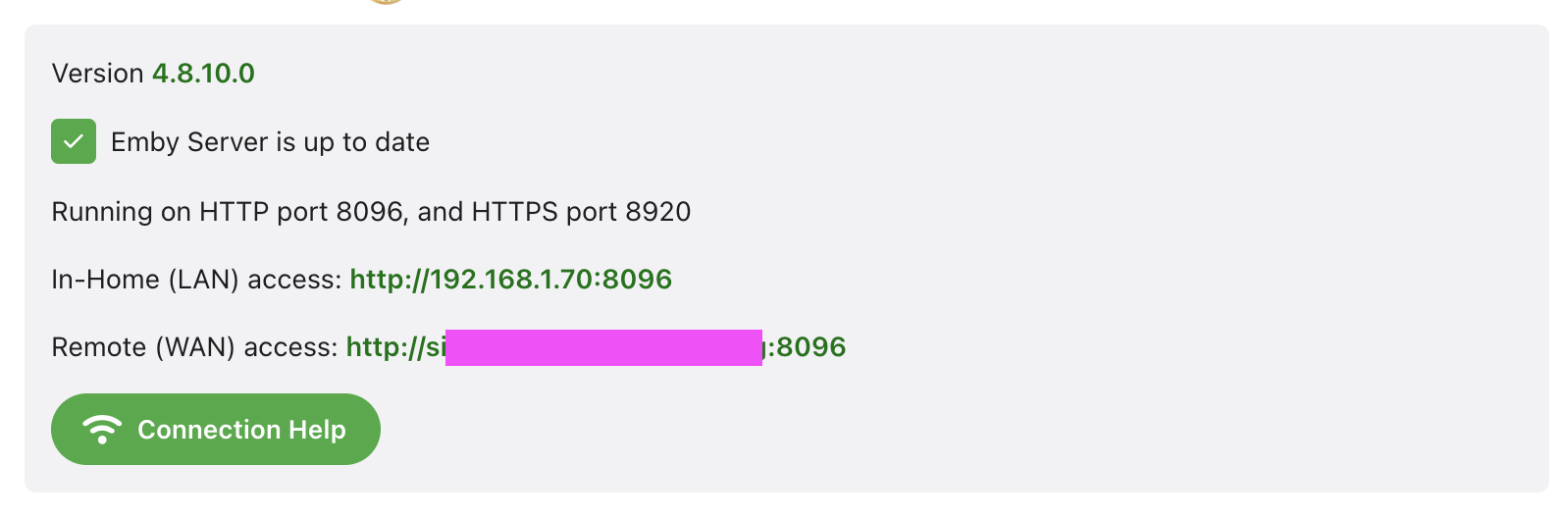

Are you able to test without ssl so that your Emby server dashboard displays your remote address as http?
SirGanty

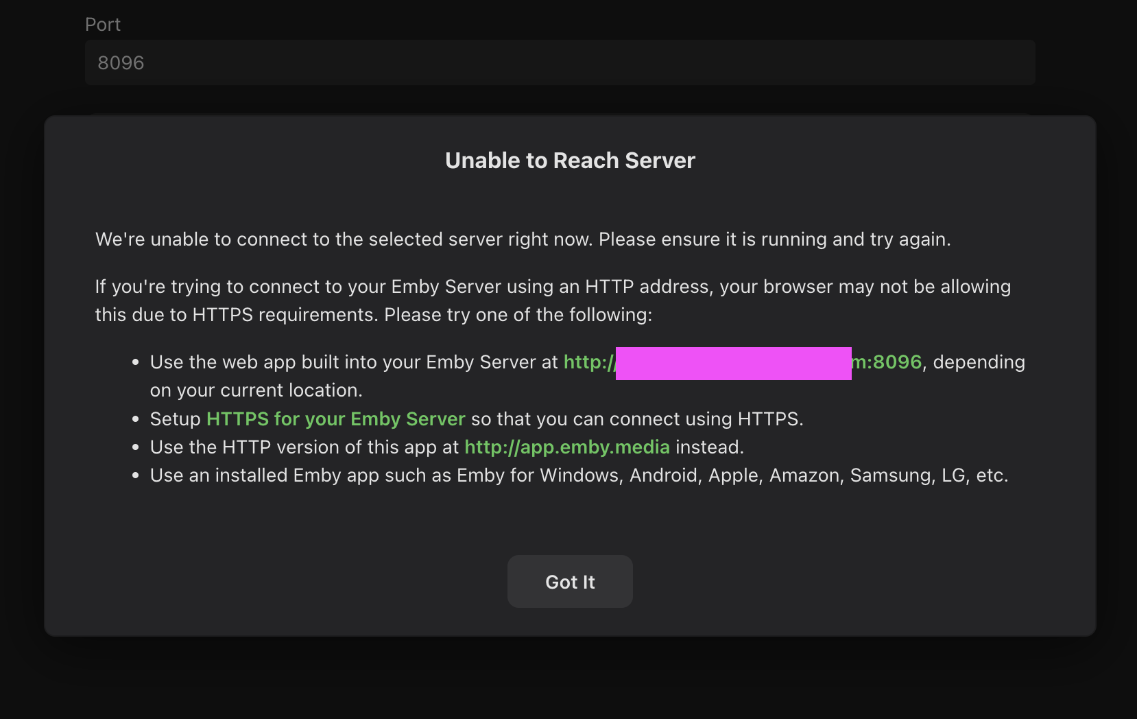

When I disable https on the server, and open up 8096
and then try to add that to emby connect I get
although I can get in directly

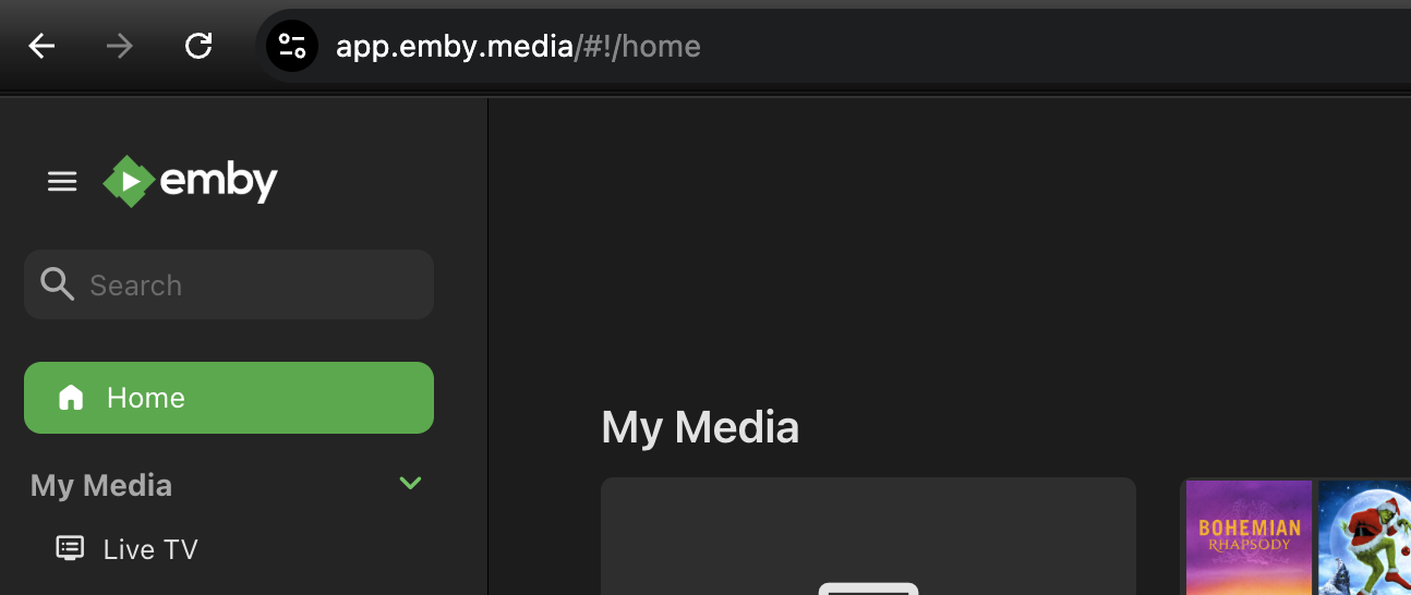

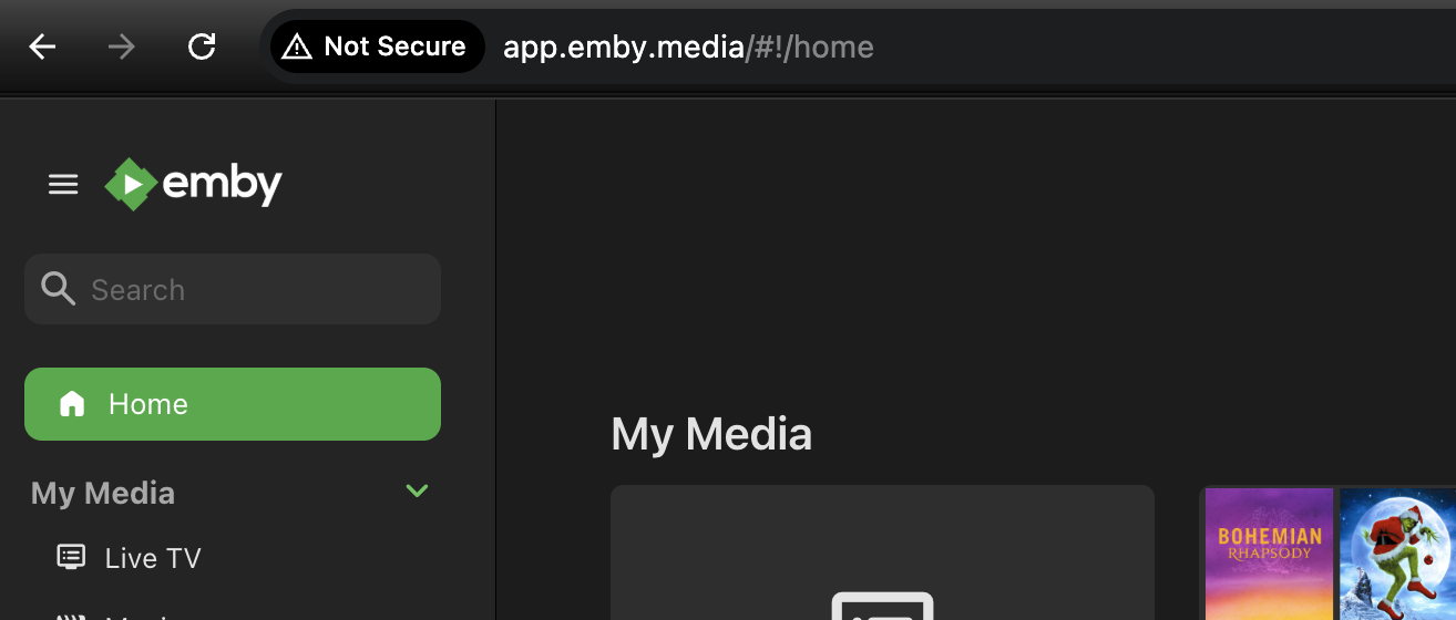

Then if I switch to http://app.emby.media I can add the server (although not via emby connect, I have to add the server details manually)

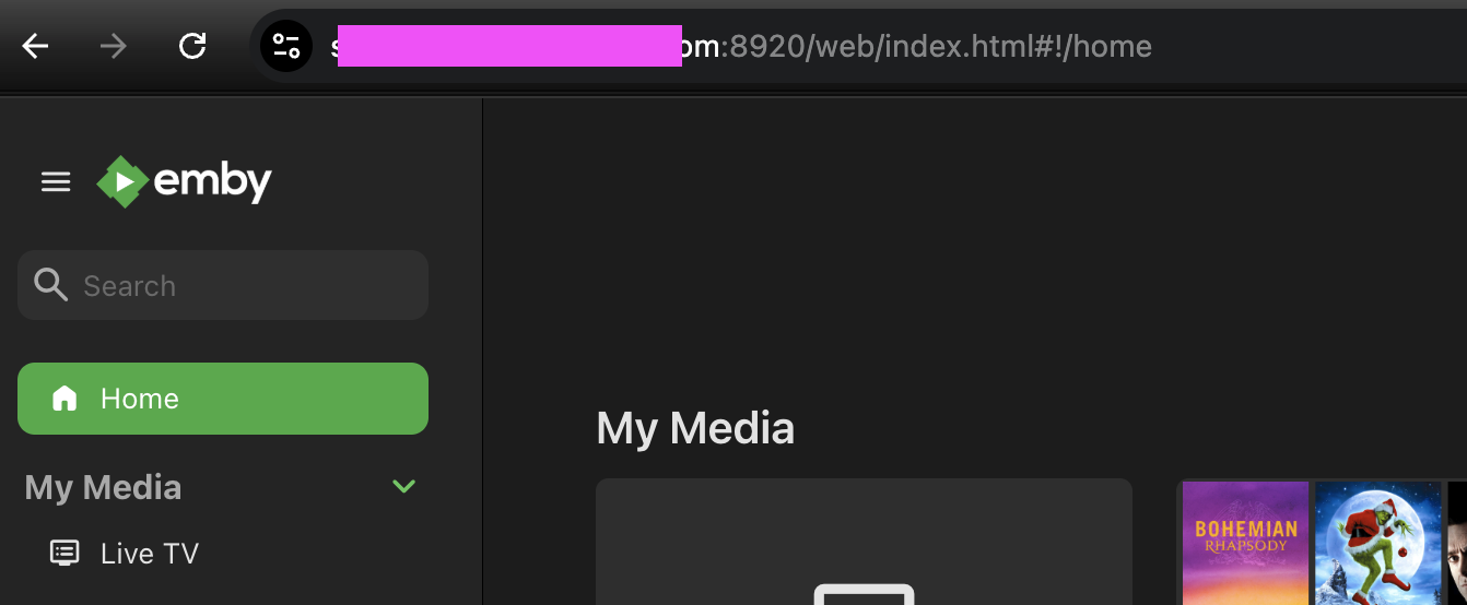

So I go back, added back in https (i have tried bith "preferred" and "required for remote" settings), reconnected via https...
re-linked the skill, and selected the server, logged in my user
