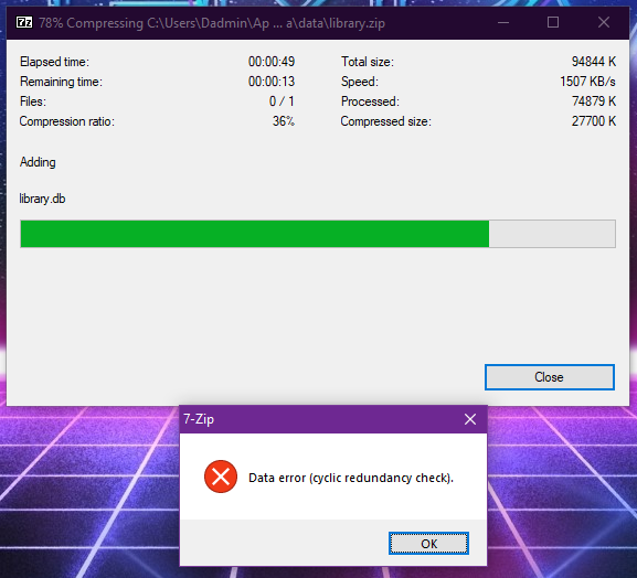

Procyan 1 Posted February 7, 2024 Author Posted February 7, 2024 Huh, so when I try to compress library.db, .zip or .7z, it errors with cyclic redundancy check.

Procyan 1 Posted February 8, 2024 Author Posted February 8, 2024 Sry for the late reply. No can do on booting to safe mode and trying to zip or 7z the library.db. Same error cyclic redundancy check.
Luke 39617 Posted February 8, 2024 Posted February 8, 2024 5 minutes ago, Procyan said: Sry for the late reply. No can do on booting to safe mode and trying to zip or 7z the library.db. Same error cyclic redundancy check. You might actually be having a hard drive failure: https://answers.microsoft.com/en-us/windows/forum/all/disk-drive-cannot-initialize-data-error-cyclic/595dee79-7ebd-45f3-a98e-931288181d7c Can you scan the drive for errors? https://www.elevenforum.com/t/check-drive-for-errors-with-chkdsk-check-disk-in-windows-11.8046/

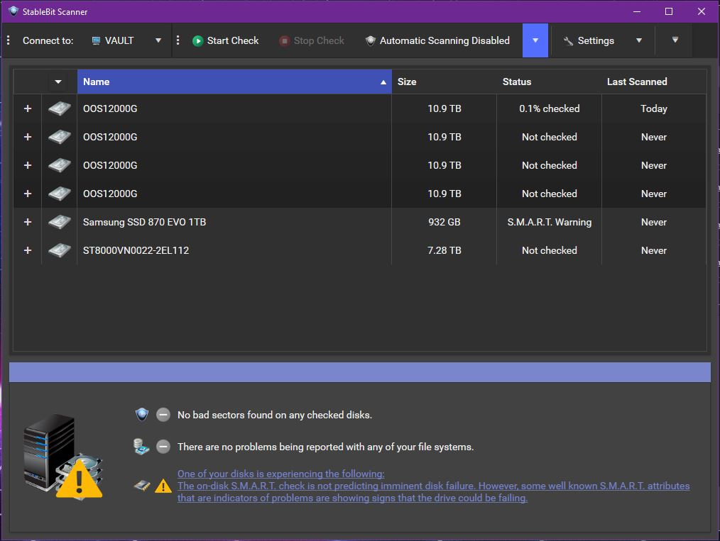

Procyan 1 Posted February 8, 2024 Author Posted February 8, 2024 Soooo I run StableBit drivepool. Looks like I cannot scan the pool through windows and have to purchase their scanning solution. So I bought it and am now scanning the drives. The hard drive that is reporting the SMART problem isn't part of the pool. I'll report ba 1
Procyan 1 Posted February 9, 2024 Author Posted February 9, 2024 SO it looks like it is going to days possibly longer to do the scan over the 40TB of drives. Since it is just Emby that is messed up is there a settings file I can save and import into a new installation of Emby? Will I have to have it download all the metadata again?
TeamB 2411 Posted February 9, 2024 Posted February 9, 2024 (edited) The file you are having issues with in C:\Users\<user>\AppData\Roaming\Emby-Server\programdata\data\library.db So it is on your windows drive, it is probably not part of the StableBit POOL, in the above screen show it is probably your Samsung EVO drive and that is the one you are having SMART issues on. Use the windows tools to scan your c drive, this is where the file in question is. Edited February 9, 2024 by TeamB

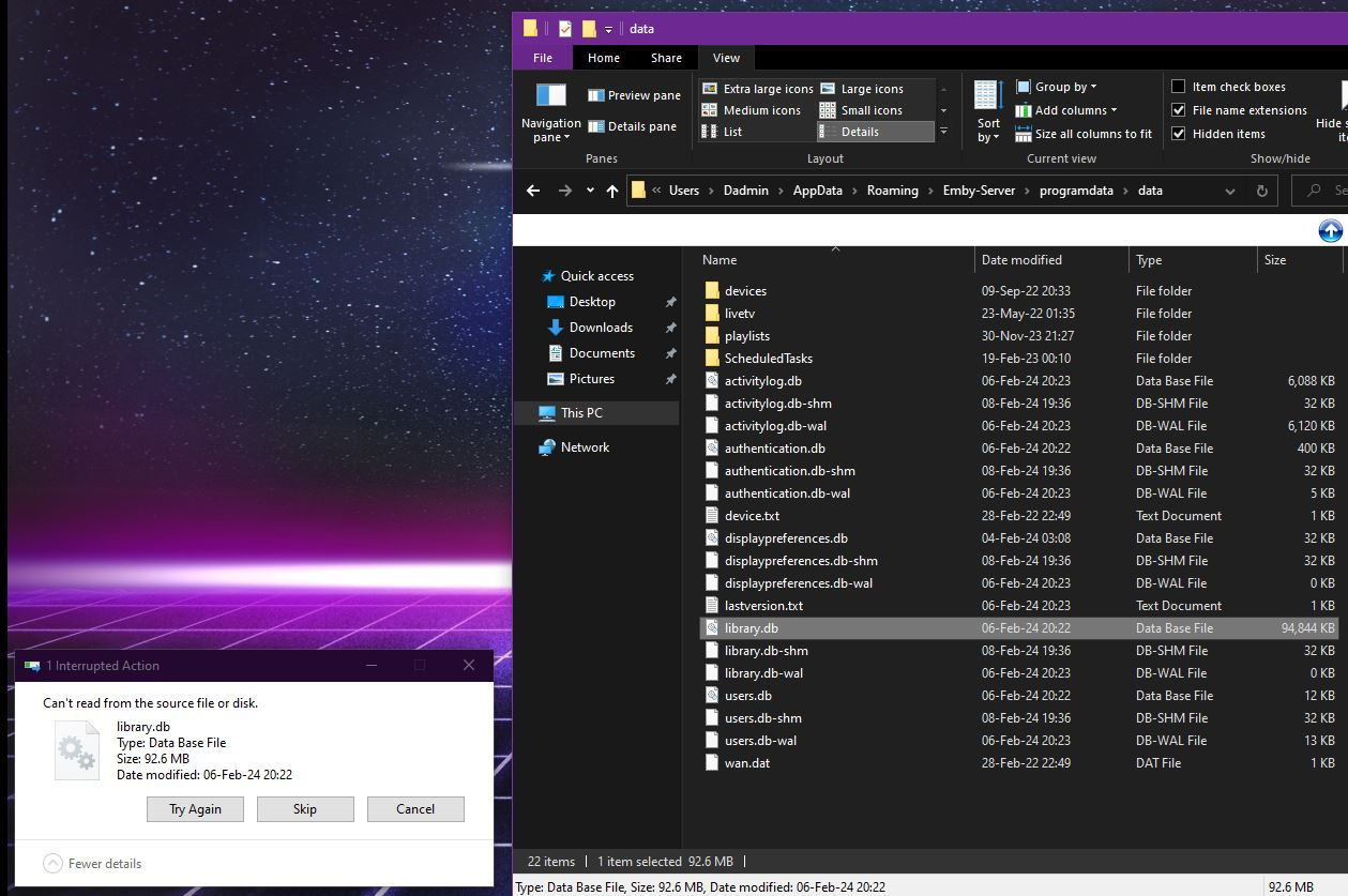

Procyan 1 Posted February 9, 2024 Author Posted February 9, 2024 A scan of C drive through Windows revealed no errors. When trying to copy the library.db to desktop revealed the following error. So I guess it has corrupted. Is there a way to rebuild it?
Happy2Play 9351 Posted February 9, 2024 Posted February 9, 2024 5 minutes ago, Procyan said: A scan of C drive through Windows revealed no errors. When trying to copy the library.db to desktop revealed the following error. So I guess it has corrupted. Is there a way to rebuild it? As you image shows all of the database are still open suggesting Emby is Running as shm and wal files only exist when a database is open or Emby is not shutdown cleanly. If Emby is not running task manager then you should be able to delete all the shm and wal files.
Procyan 1 Posted February 9, 2024 Author Posted February 9, 2024 I was able to delete the files. I then tried to start the server again and the .shm and .wal files re-created, but Embyserver.exe did not start.
Happy2Play 9351 Posted February 9, 2024 Posted February 9, 2024 5 minutes ago, Procyan said: I was able to delete the files. I then tried to start the server again and the .shm and .wal files re-created, but Embyserver.exe did not start. Can you post another server log but suggests something wrong with current database.

Procyan 1 Posted February 9, 2024 Author Posted February 9, 2024 No still cannot copy over library.db. Thanks for all of the suggestions so far.
TeamB 2411 Posted February 9, 2024 Posted February 9, 2024 4 minutes ago, Procyan said: No still cannot copy over library.db. Thanks for all of the suggestions so far. if Emby server is not running, you have rebooted and you still can not copy the DB file you have issues with your drive. Even StableBit thinks you have issues with your drive. Check the SMART errors and see what is going on.
Procyan 1 Posted February 15, 2024 Author Posted February 15, 2024 OK scan is done and it detected that library.db has corrupted, none of the drives used for the movies and TV Shows had errors. The scan was unable to recover library.db. So I uninstalled emby server from the control panel restarted the computer and was trying to install Emby server again and got an error. I really don't want to have to format the whole computer just to get Emby working again. Attached is the log from the attempted install of Emby server. install.log
