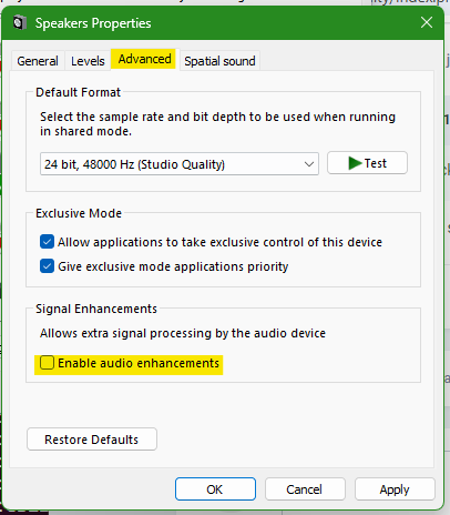

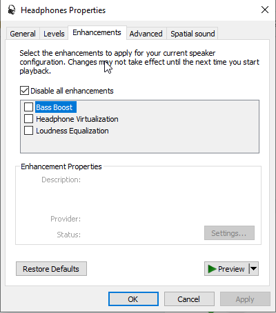

albertlos 10 Posted September 26, 2024 Posted September 26, 2024 I've fixed the issue on my side for my JBL earbuds! I just found it on reddit for my JBL earbuds. Apparently you can set in the JBL app the settings to VIDEO. This fixed the delay when streaming Emby. I also find out that you can fix it on PC (windows 10 and 11) by disabling all enhancements (although none were turned on, ticking the box like below, fixed the problem). search for sound settings > choose your output device > device properties > additional device properties, gave me below window. 2
softworkz 4456 Posted September 26, 2024 Posted September 26, 2024 (edited) 7 hours ago, albertlos said: I've fixed the issue on my side for my JBL earbuds! I just found it on reddit for my JBL earbuds. Awesome. I knew that it just can't be true that so many devices are not suitable for watching video. @generiq Does the change regarding the enhancements also fix delay on your Flip 4? Edited September 26, 2024 by softworkz

softworkz 4456 Posted September 26, 2024 Posted September 26, 2024 14 minutes ago, wordlover said: To reiterate, though, there are many of us with setups and delays that aren't fixable - having audio delay functionality built in to Emby (as it is on so many other platforms, as reported above) would be very helpful to many users, i.e. your 'consideration #2' above. Yes, but you will surely agree that it would be beneficial for everybody when no such adjustments are needed in the first place (whenever possible). So please guys, help us getting to the ground of this and try whether disabling enhancements will fix audio delay for you. 6 hours ago, albertlos said: I also find out that you can fix it on PC (windows 10 and 11) by disabling all enhancements (although none were turned on, ticking the box like below, fixed the problem). search for sound settings > choose your output device > device properties > additional device properties, gave me below window. Thanks!

generiq 245 Posted September 26, 2024 Posted September 26, 2024 3 hours ago, softworkz said: @generiq Does the change regarding the enhancements also fix delay on your Flip 4? No. I already stated - no software update. There are no settings in the JBL app, and disabling enhancements has no effect. And if I reboot, enhancements are re-enabled. So even if that did work, I'd have to disable it every time i started the computer.

softworkz 4456 Posted September 26, 2024 Posted September 26, 2024 12 minutes ago, generiq said: .there doesn't appear to be a fix, and everyone appears to be doing what I'm doing.. Well, but obviously not everybody would need to be doing that: 13 hours ago, albertlos said: I also find out that you can fix it on PC (windows 10 and 11) by disabling all enhancements (although none were turned on, ticking the box like below, fixed the problem).
