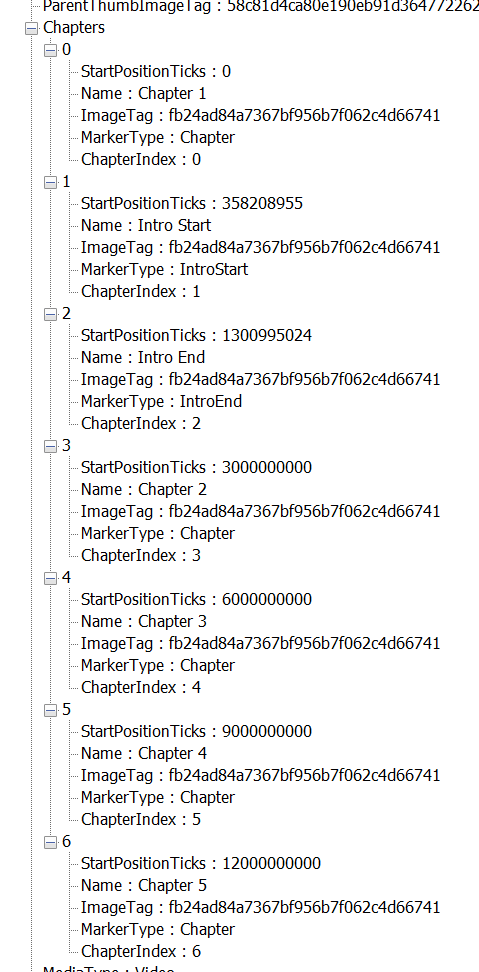

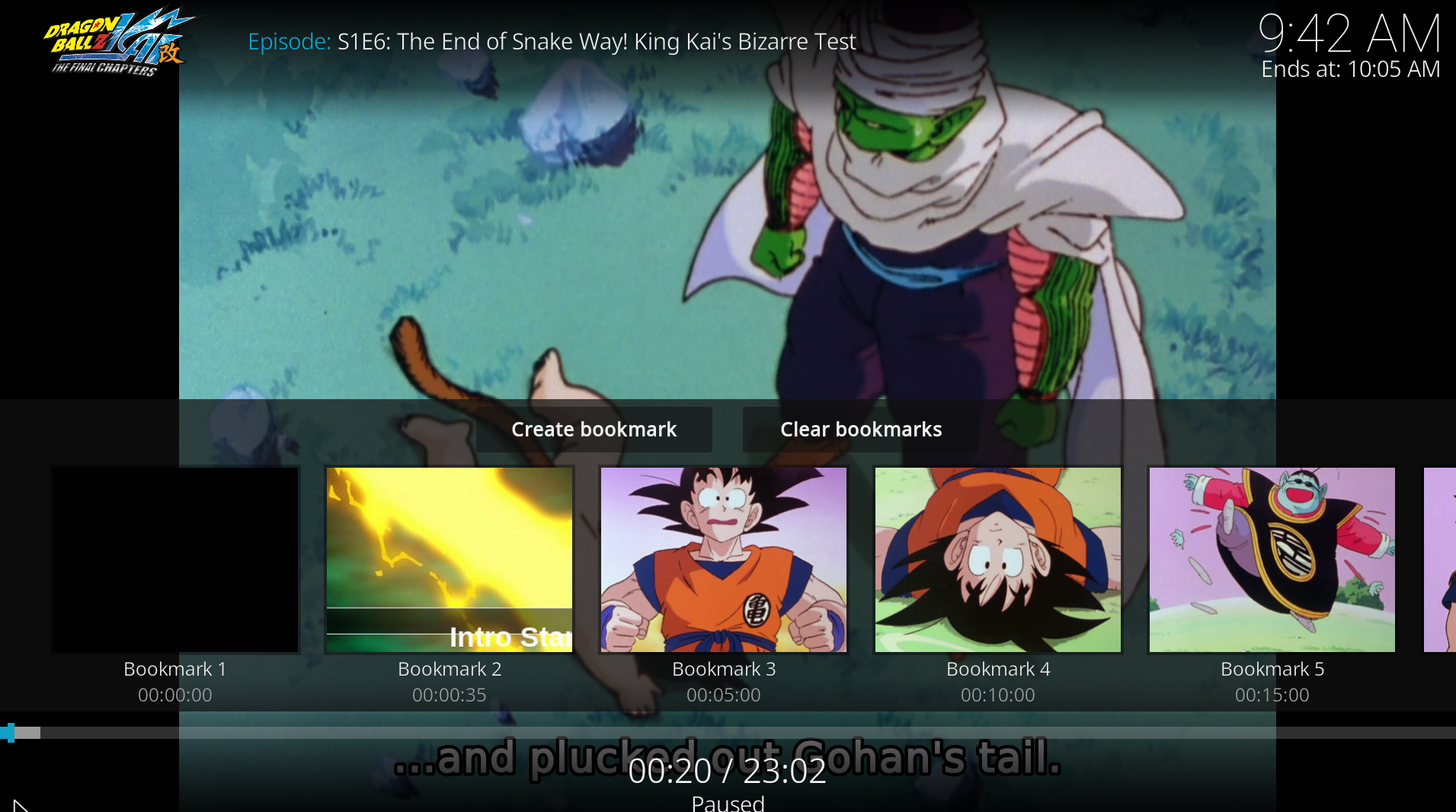

Thanks for the excellent addon, I have been testing introskip lately from core and I cannot seem to get it working on Kodi with emby-next-gen. Currently I am trying plugin.video.emby-next-gen-7.0.8.zip with kodi 19.4 and it seems to sync and play ok but episodes I have confirmed have chapter markers:
Are not providing a intro skip pop up button in kodi, but work fine in emby web player.  Here is a log file with playing this given video file until its intro sequence.
Thanks again!
kodi.log
Link to comment

quickmic
5 minutes ago, 1moment said:
Hey quickmic!
Thanks again!
At the moment only the chapters are synced but not the actual "jump" functionality.
I think also possible (for next releases) to implement this feature.
Edited by quickmic

1moment
Thanks for the clarification - in that case I believe I am only showing the 'IntroStart' marker and not 'IntroEnd' which I think won't be very useful?
  • Thanks 1
Link to comment
Share on other sites
quickmic
First I see the label is on the wrong position. Should be centered in the "box". Please go to the right-side edge/end of the bookmarks and check if it's there. Also compare bookmarks with Emby server WebUI and report if it differs.
Edited by quickmic
