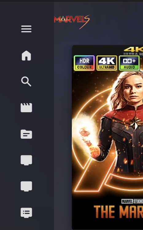

47 minutes ago, Eigeplackter said:
My apologies if this issue has been handled somewhere in the thread.
Is there a special setting to get the back button on top of the screen ?
It doesnt seem to be hidden under the sidebar and I cant move backwards, i.e. when I'm into a collection with several movies.
Im running the official Chrome Version 127.0.6533.100 (64-bit) and used css 3.4  and 3.5.1.
Looks like you need to add .skinHeader-withminidrawer here.
@media (min-width: 50em) {
  .skinHeader-withfulldrawer, .skinHeader-withminidrawer {
    padding: 1em 5em 1em 10em !important;
  • Thanks 1

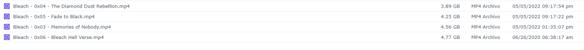

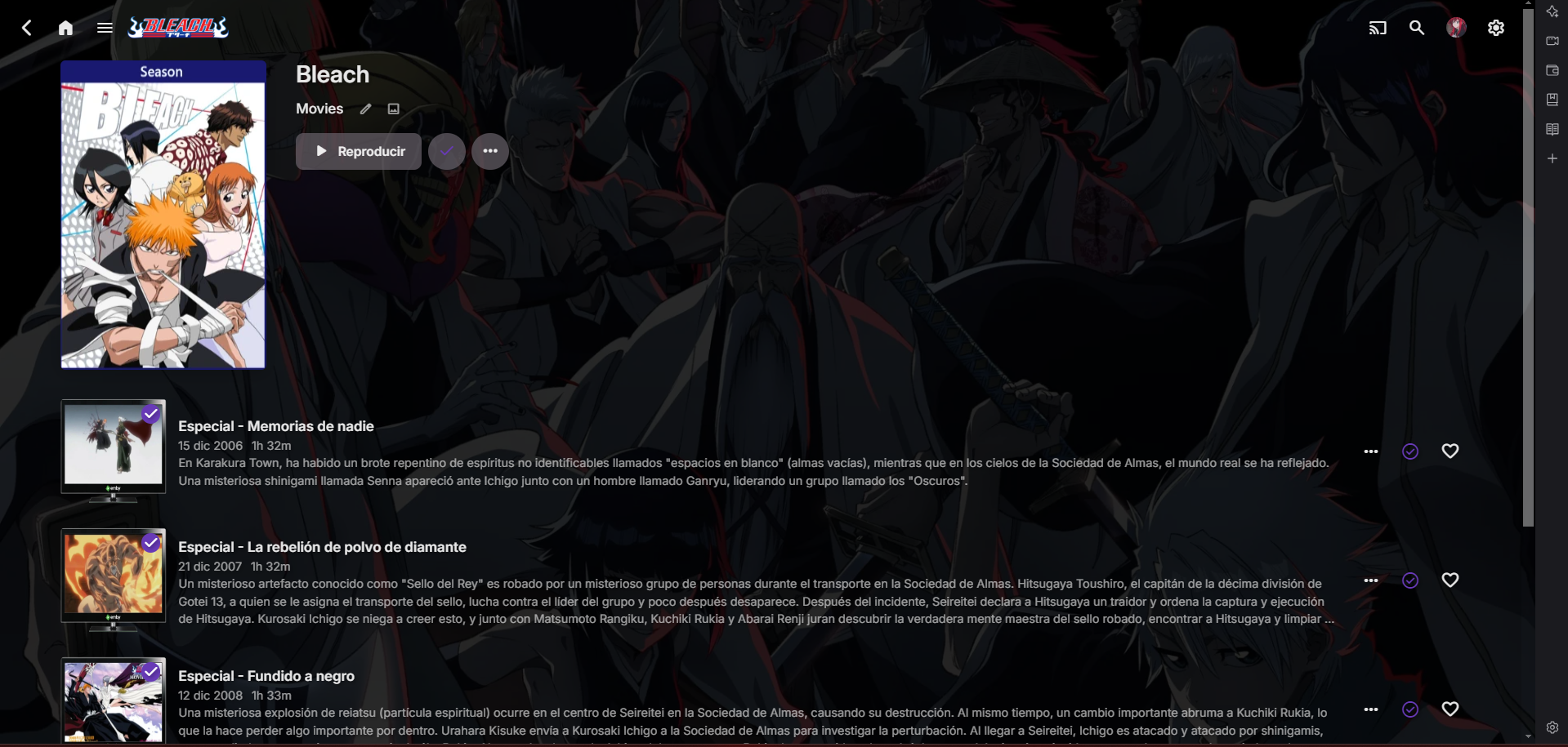

Gremory17
Hace 4 horas, Happy2Play dijo:
No estoy seguro aquí, ya que no puedo reproducir lo que está viendo a menos que hay algún tipo de problema de caché, ya que Emby dice que hay 18 temporadas en su video.
Como veo las 18 temporadas/Especial a través de la temporada 17.

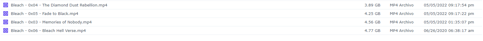

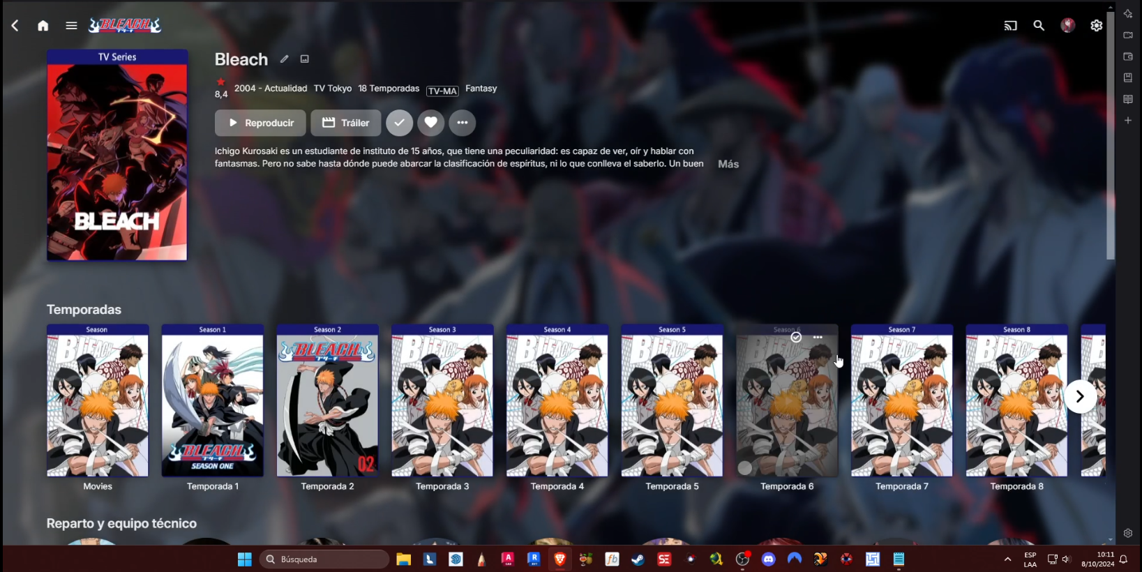

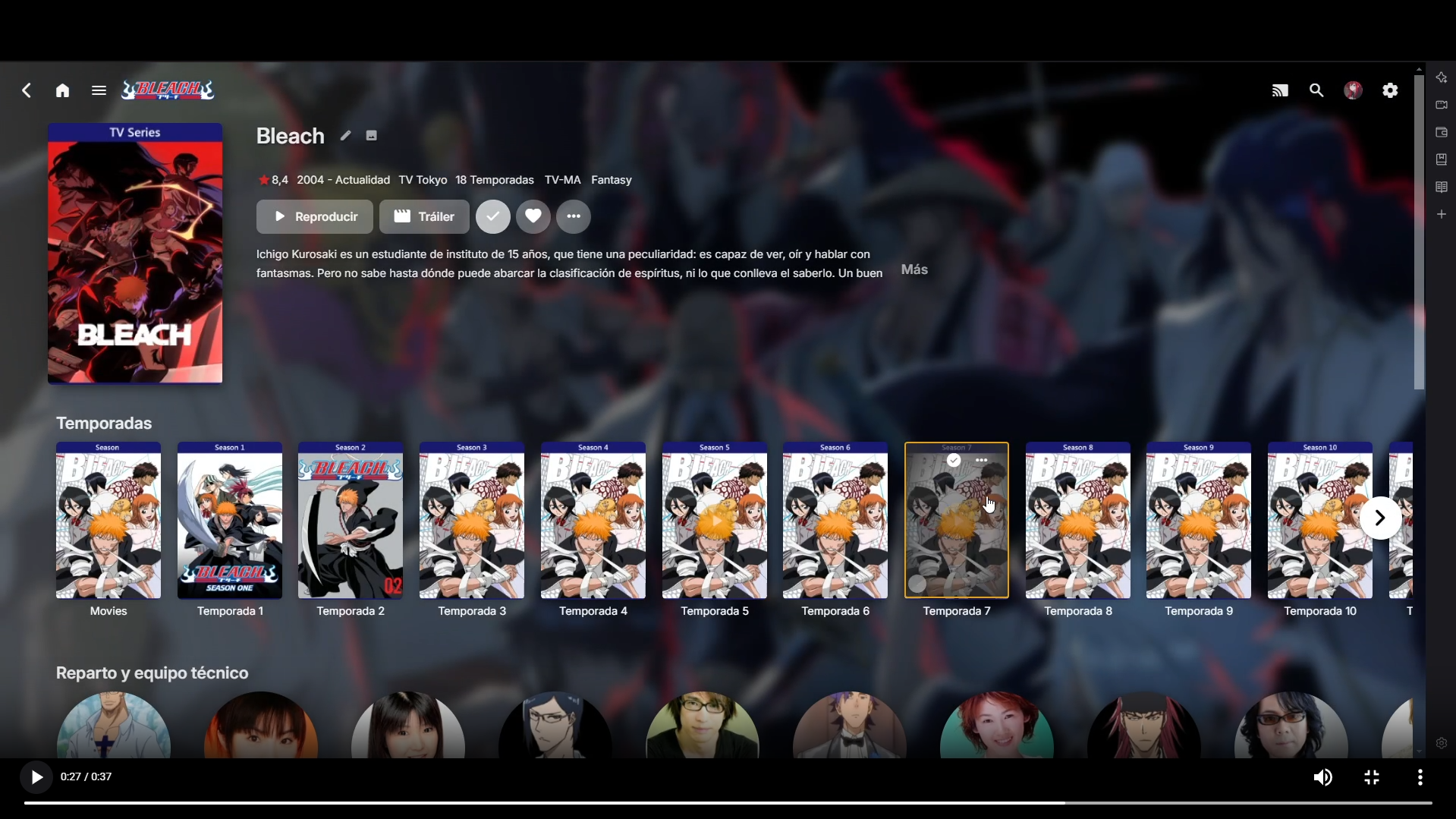

Carpeta Movies lo toma como una temporada por eso muestra "18" pero eso no debe afectar en nada ya que emby lo detecta de manera correcta su información pero en el video se muestra el verdadero error al no tener ningún CSS muestra correctamente la S17, al poner el CSS la S17 desaparece, Todo esto desde navegador Braveimagen.thumb.png.9baab6e6c23023b9f3d5c909dc9.pngimagen.thumb.png.4b523629ba22229ef008710a560a8f60.png
Edited by Gremory17

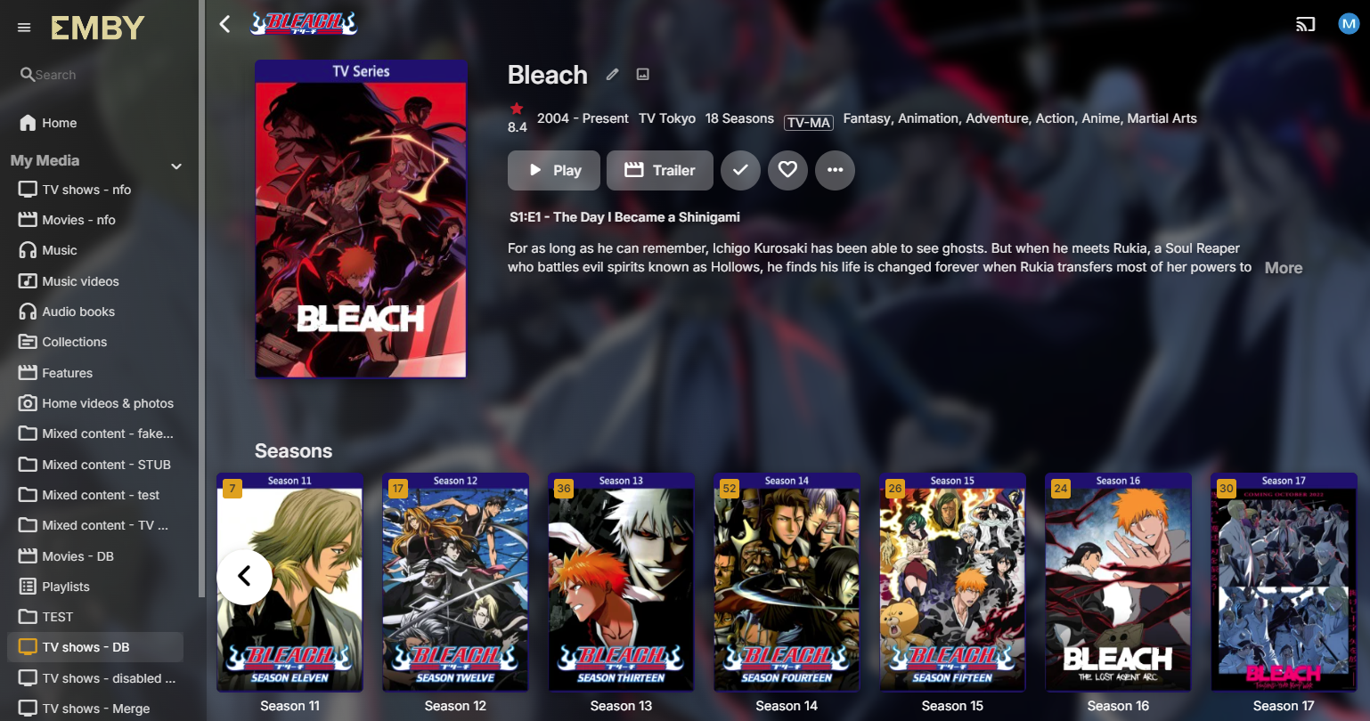

Happy2Play
1 hour ago, Gremory17 said:
Movies folder takes it as a season that's why it shows "18" but that should not affect anything since emby detects it correctly its information but in the video the real error is shown by not having any CSS shows correctly the S17, when you put the CSS the S17 disappears, All this from Brave browser
Still not sure as I retesting in Brave and everything appeared so I have no idea how to reproduce the issue you showed in your video.  Added the entire series and specials to ensure it was not something with episode count or something weird even tried with navbar open and closed.
visproduction
Grem's Season posters are smaller on a wider window.  Perhaps switching to smaller poster icons has something to do with loosing Season 17.  Also, I know there is sometimes a number of posters in a row limit from inside a .js.  Often the number is 16. But that should not change with a custom CSS change.  Smaller posters on wider window hitting some max-width limit?  Very strange.
  • Agree 1
Happy2Play
Yeah I tested default to extra small and could not reproduce what is shown in video.  But small gives me the same 9 images across.  So I don't know what other factor is at play here.
visproduction
Hmmm... Anime from Japan... Does Grim's title for season 17 have some quirky Japanese character in the name, or is there a space at the beginning of the name???  CSS change of font-family perhaps just can't read this type of name?
Gremory17

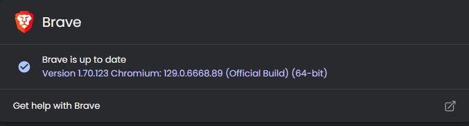

11 hours ago, Happy2Play said:
Todavía no estoy seguro de volver a probar en Brave y todo apareció, así que no tengo idea de cómo reproducir el problema que mostró en su video.  Se agregó toda la serie y especiales para asegurarse de que no era algo con recuento de episodios o algo extraño incluso intentado con la barra de navegación abierta y cerrada.

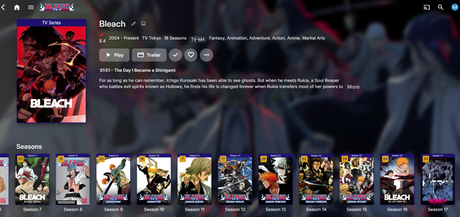

Acabo de intentar con navegador google  chrome y ahi si me detecta la S17 con CSS solo con navador brave no se porque no se visualiza S17
Gremory17
 Ya pude solucionarlo al final ocupe el misma version CSS para navegador brave, pero  con la diferencia  que ahora los posters se ven mas grandes  en  el  anterior video hasta s10 se  podia visualizar sin desplazarme ahora  que los posters son mas grandes toma hasta s8 pienso tal vez que fue algun bug ocasiono esto
(Antiguo video con CSS en navegador Brave poster mas pequeños hasta s10)image.thumb.png.ee127510af2396d9e129ef9a9aa3f97d.png
(Actual video con CSS en navegador brave Poster mas grande hasta S8)
  • Like 1

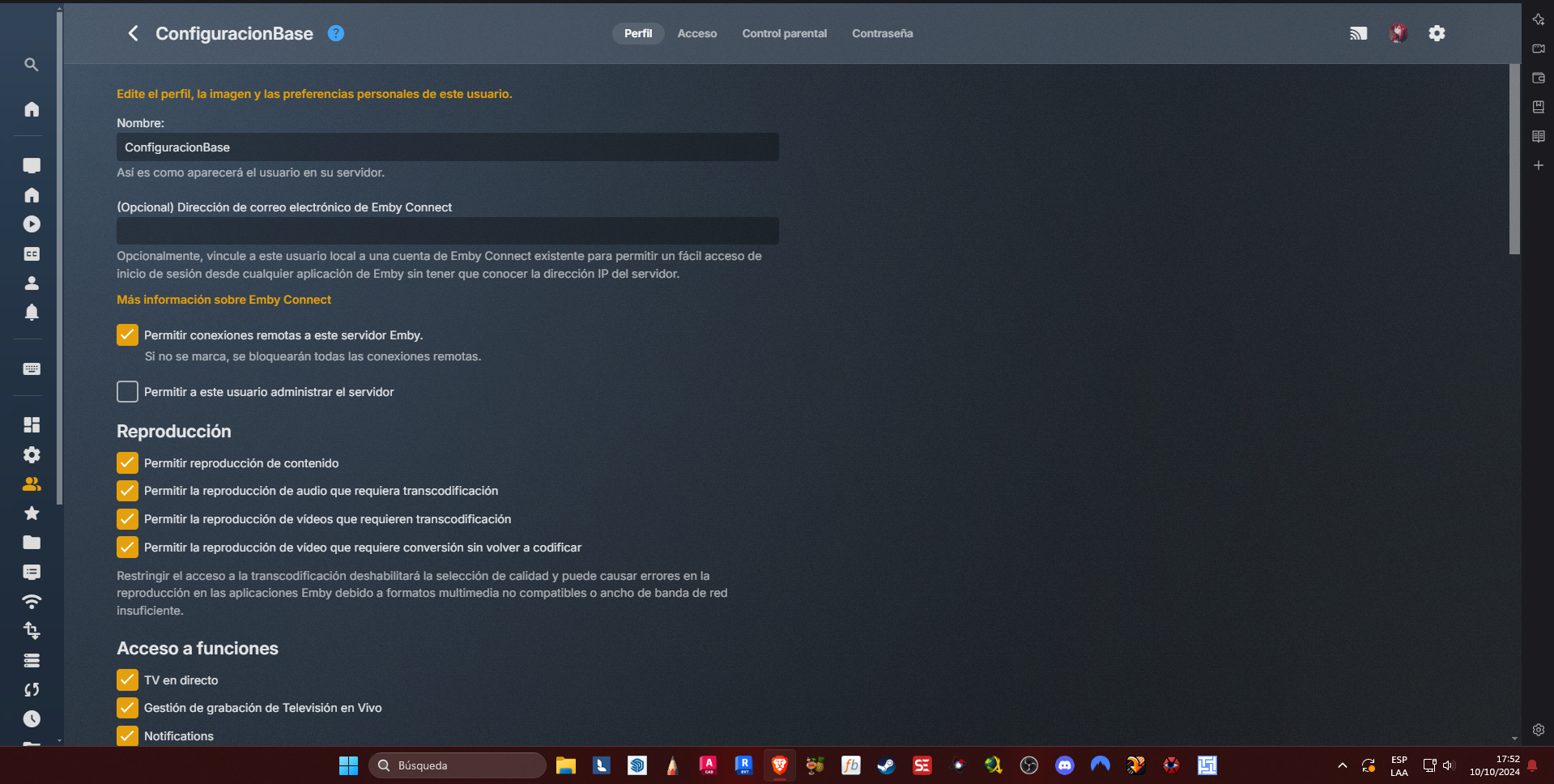

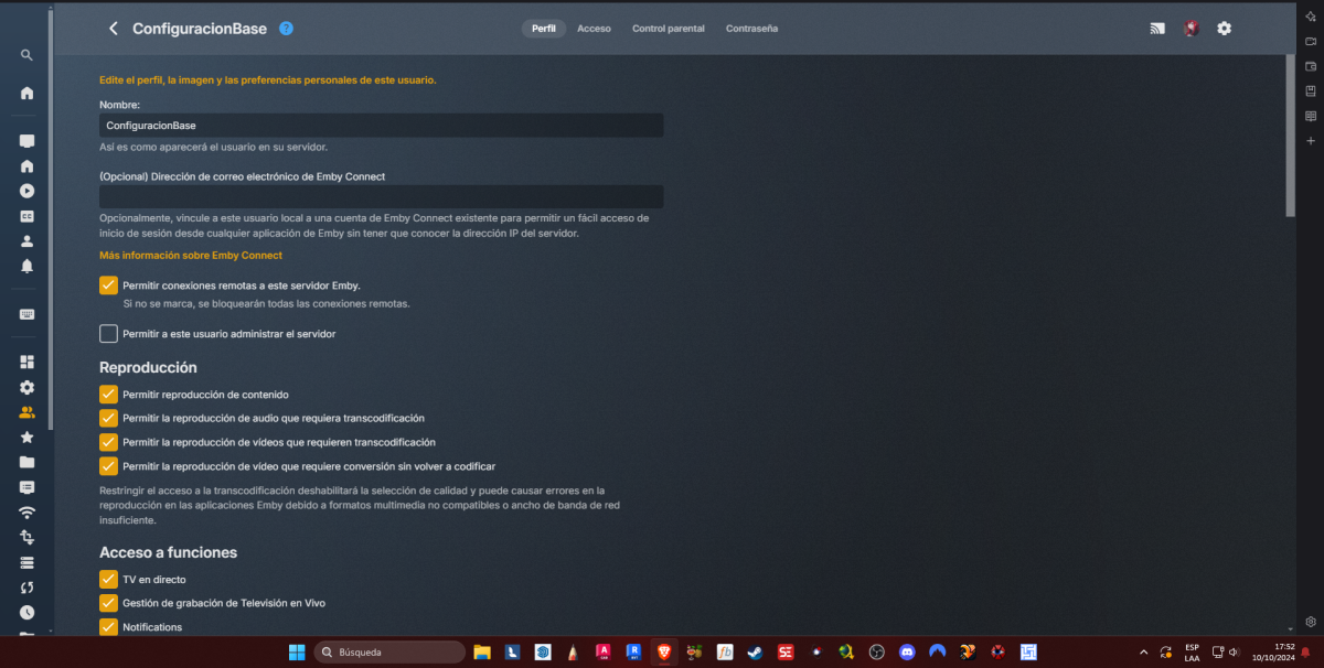

It seems there is a similar issue within the settings portal.  This fixed the majority of it, but it's still happening on random pages such as:
  • Users > Profile
  • Live TV
  • Transcoding
  • Conversions > Settings
  • Logs
  • Logs > Settings
  • Downloads
Happy2Play
  • Users > Profile
  • Live TV
  • Transcoding
  • Logs
  • Logs > Settings
  • Downloads
No idea but a quick and dirty fix.
div.view-users-user, div.view-transcoding-transcoding, div.view-server-sync-sync, div.view-logs-logs, div.view-librarysetup-librarysetup, div.view-livetvsetup-livetvsetup, div.view-plugins-plugins {left: 7em!important;}
  • Agree 1
muchas gracias :D agregado a la nueva versión
Emby3.6.1.txt
  • Thanks 1
