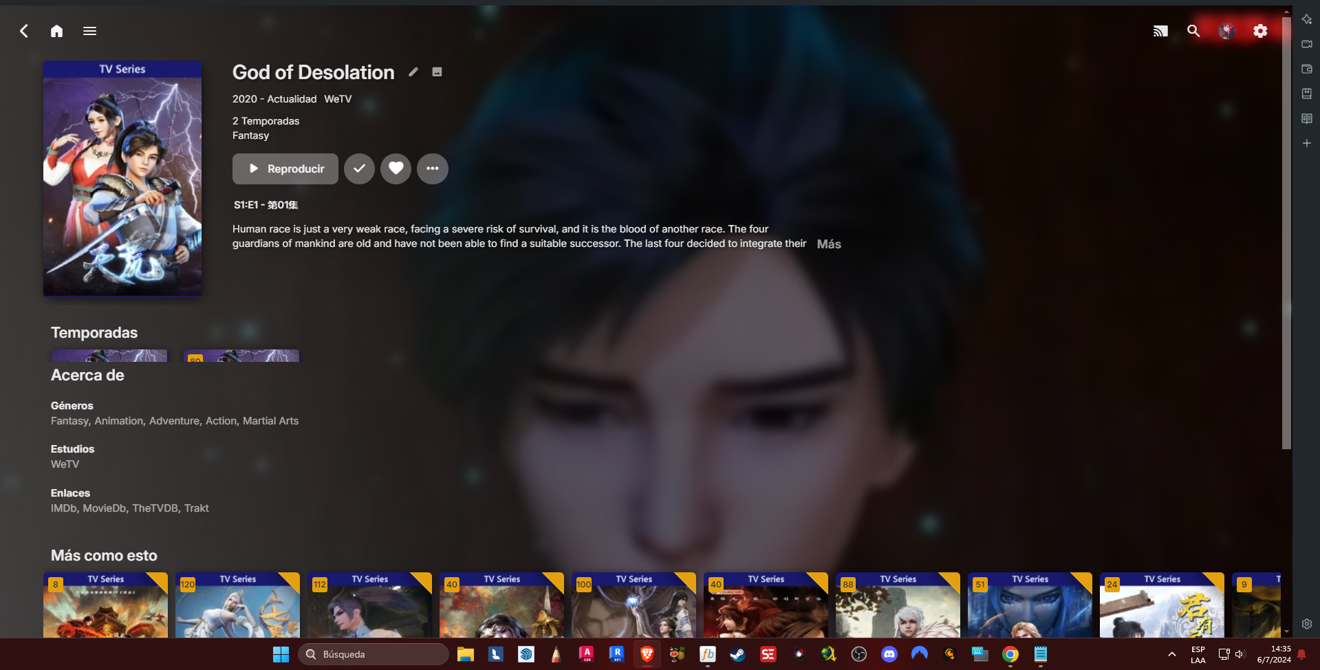

1 minute ago, Gremory17 said:

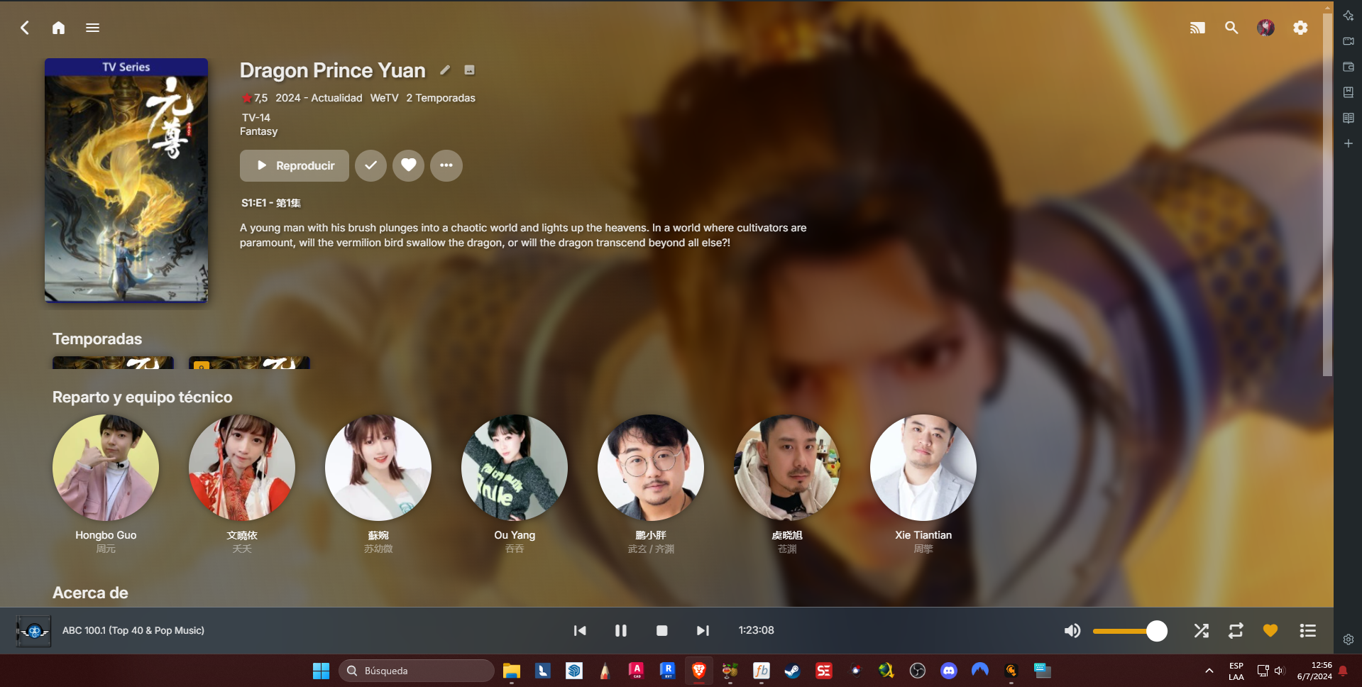

hay alguna forma de arreglar como se ven las temporadas? la imagenimage.thumb.png.a70fe90570bd6d114eb66311f62c8608.png
Did you update versions as this issue was identified a few posts back.  But new versions can be found here.
@fillidillcan you put the newest code in first post.  Thanks
Happy2Play
Actually, your issue would appear to be new covering Seasons folders vs the previous episode row you reported but cannot reproduce with v3.4 code. @Gremory17
Is this the only code you are using?

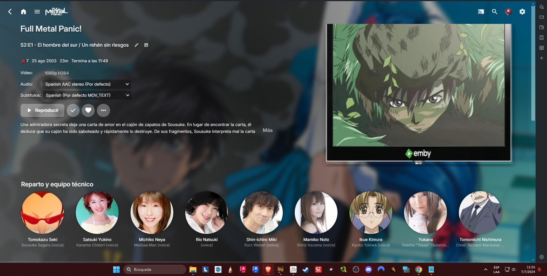

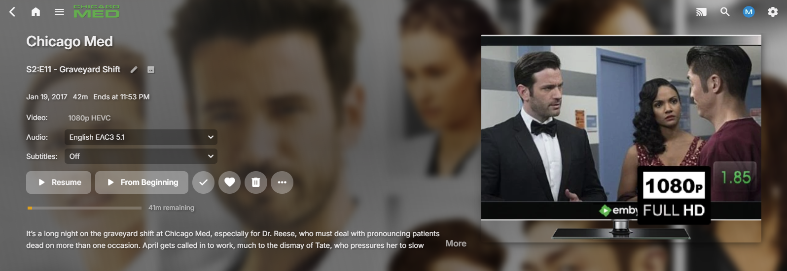

version 3.4 estoy ocupando y aun me sale cortado lo de las imagenes de temporada dificulta un poco entrar a la temporada, no son todos

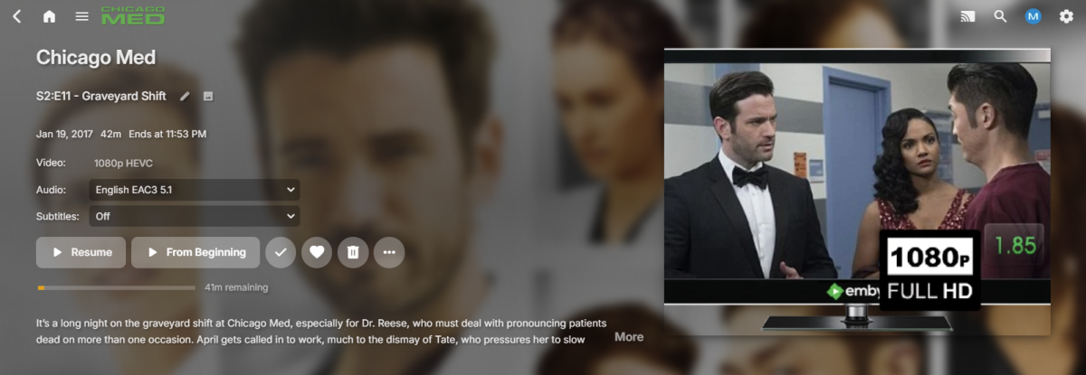

tambien identifique que la informacion del video ahora lo hace hacia la derecha esto solo aplica si el video tiene multi sub o audio aparteimage.thumb.png.fbd158829f945a747657a0efe1e833d1.png

Happy2Play
Can you post a copy of the css you are using.  As I cannot reproduce Seasons issue.

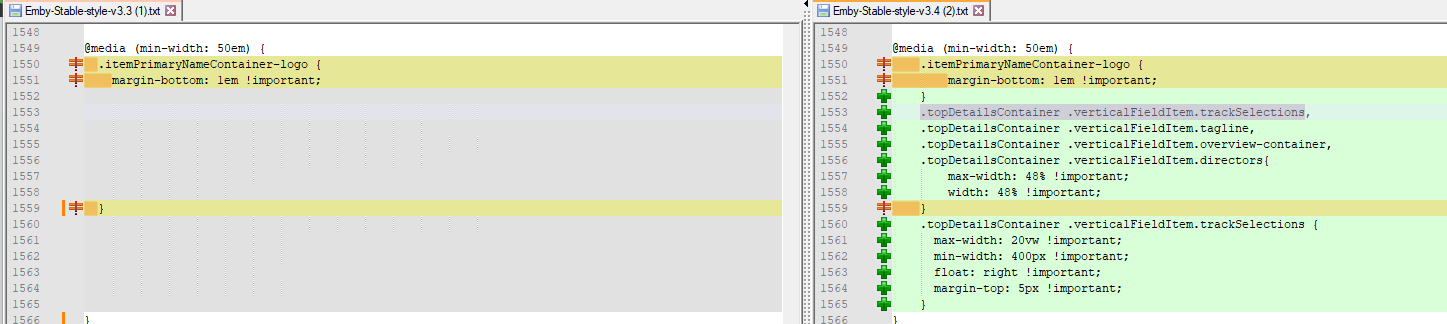

As for the tracksection info floating right that is a change @fillidillactually did in v3.4 so you would want to compare it to v3.2 or v3.3 and remove the changes.

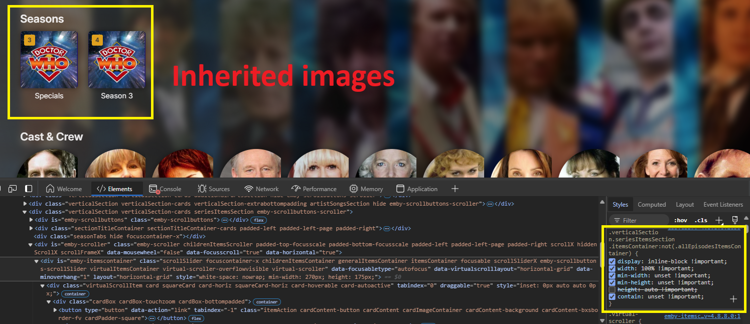

Thanks, I was able to reproduce this as this is an issue for items without season images as the inherited image is smaller and the height: auto !important creates the issue.  @fillidill Easy to reproduce find item with no season images or pick a show and delete season images.
.verticalSection.seriesItemsSection .itemsContainer:not(.allEpisodesItemsContainer) {
    display: inline-block !important;
    width: 100% !important;
    min-width: unset !important;
    min-height: unset !important;
    height: auto !important;
    contain: unset !important;
Looks like it can be disabled or removed.
Or add a season image to one of the seasons to correct the issue.

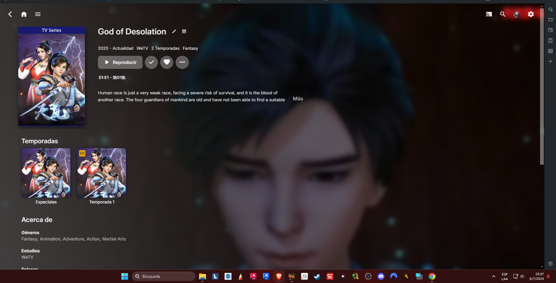

image.thumb.png.a2d9bb3fa282783634a1f58512e0fc11.pngmuchas gracias removiendo esa parte de codigo resuelve el problema
Happy2Play
4 minutes ago, Gremory17 said:
Thank you very much removing that part of code solves the problem
Don't believe it will have any side effect in my quick look around.

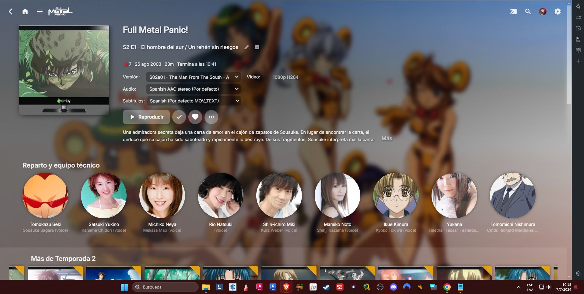

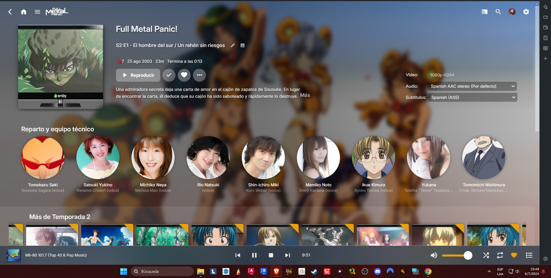

revise los demas archivos y todo bien, no veo ningun error en portadas de temporadas,  ahora bien que deberia mover para que los detalles de video este abajo de la sinopsis del capitulo y no se vea reflejado a la derecha image.thumb.png.348b7b757001d7161e3da7c19eb582fe.png
Happy2Play
8 minutes ago, Gremory17 said:
I checked the other files and everything is fine, I don't see any errors in season covers, now I should move so that the video details are below the synopsis of the chapter and not reflected on the right image.thumb.png.348b7b757001d7161e3da7c19eb582fe.png
Have you compared the previous version to new version?
Should be a matter of removing new code but will look some more as I see some quirks I previously mentioned with section width and trackselection moving with width.

I commented out that entire section.
/*@media (min-width: 50em) {
	.itemPrimaryNameContainer-logo {
		margin-bottom: 1em !important;
	.topDetailsContainer .verticalFieldItem.trackSelections,
	.topDetailsContainer .verticalFieldItem.tagline,
	.topDetailsContainer .verticalFieldItem.overview-container,
	.topDetailsContainer .verticalFieldItem.directors{
		max-width: 48% !important;
	.topDetailsContainer .verticalFieldItem.trackSelections {
	  max-width: 20vw !important;
	  min-width: 400px !important;
	  float: right !important;
	  margin-top: 5px !important;
and added width here.
.flex-grow.detailTextContainer form.trackSelections {
    order: 3 !important;
    width: min-content;
As I was seeing this.
Happy2Play

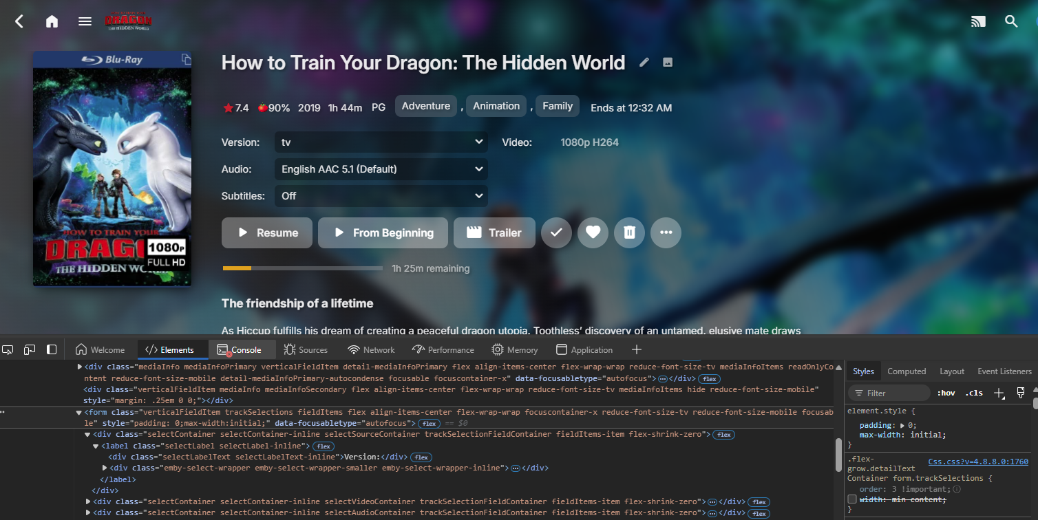

Still don't see how you get this
As I get image on other side.  With edited comments above.

Muchas gracias quedo perfecto el css, dejare la version 3.5 con las 2 partes que me ayudaste arreglar @Happy2Play
Emby3.5.txt
Happy2Play
54 minutes ago, Gremory17 said:
Thank you very much the css was perfect, I will leave version 3.5 with the 2 parts that you helped me fix @Happy2Play

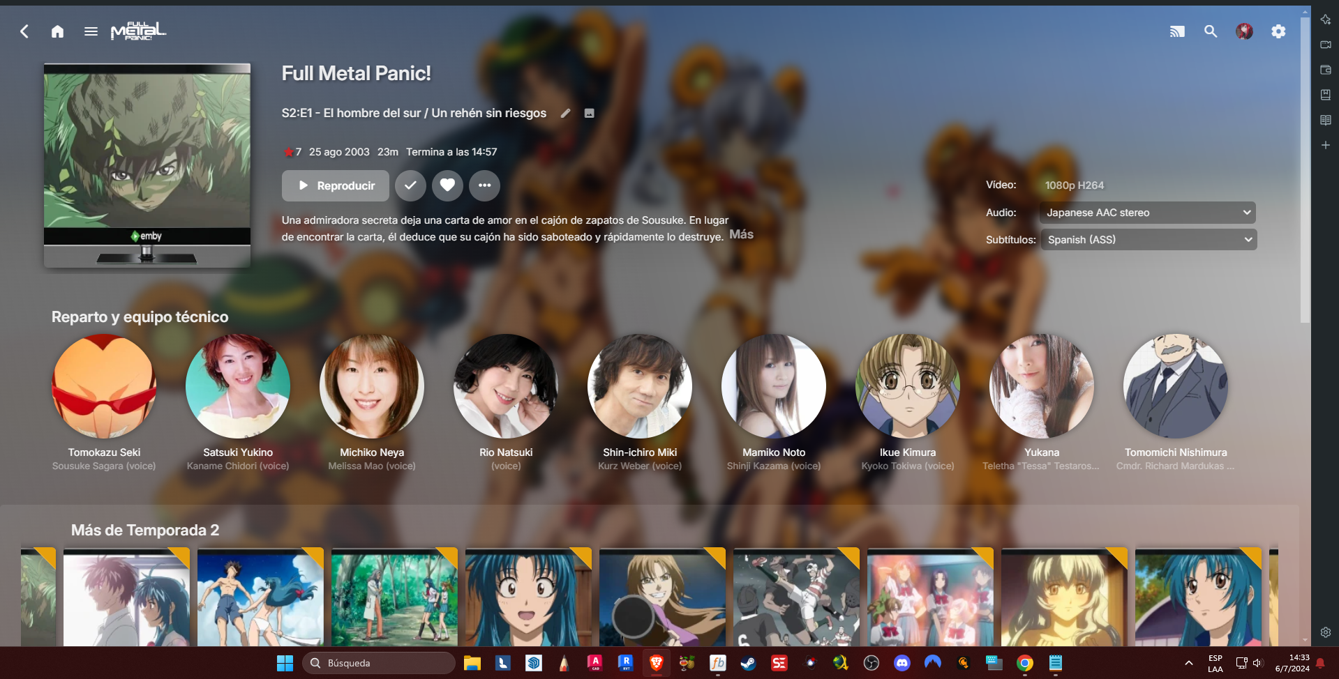

Looks like you made 2 mistakes the "ancho" breaks the code below.  And the code is actually duplicated as it exists later without the addition of width.
}*/ancho
    width: min-content;
So you need to remove "ancho" and should remove duplicate code but is not code breaking only the uncommented word.
That should fix the issue with Video track shifting right.
Edited by Happy2Play
}*/ancho
    width: min-content;
Ahora si estaria bien verdad? @Happy2Play
Happy2Play
3 minutes ago, Gremory17 said:
Now it would be okay right? @Happy2Play
Yes the tracksection is correct and you see the same as I do with image on the right a little oversized.🙃  At least via episodes.
Gremory17
:D bueno xD no creo que afecte mucho visualmente si esta sobredimensionada lo dejare asi ya que funciona bien gracias por la ayuda :D
