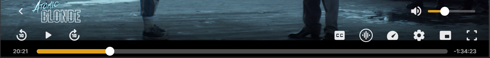

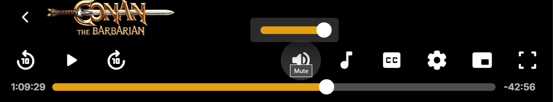

18 minutes ago, Mithrim said:
I'm not sure what view you are showing there but this is how it looks for me when hovering over the speaker icon (this time Microsoft Edge Version 126.0.2592.68 (Official Build) (64-Bit):
CSS is from Emby-Stable-style-v3.2.txt
Here is what I get but looks like it may be a resolution thing but can't get what you see resizing the browser.
Chrome Version 126.0.6478.115 (Official Build) (64-bit)
Edge Version 127.0.2651.8 (Official build) stable app, beta channel (64-bit)
I can't reproduce what I see in your screenshot, @Happy2Play
This is at 100% (Edge)
And this is scaled way down:
The slider stays above the speaker icon.
Are you also using Emby-Stable-style-v3.2.txt without any other modifications?

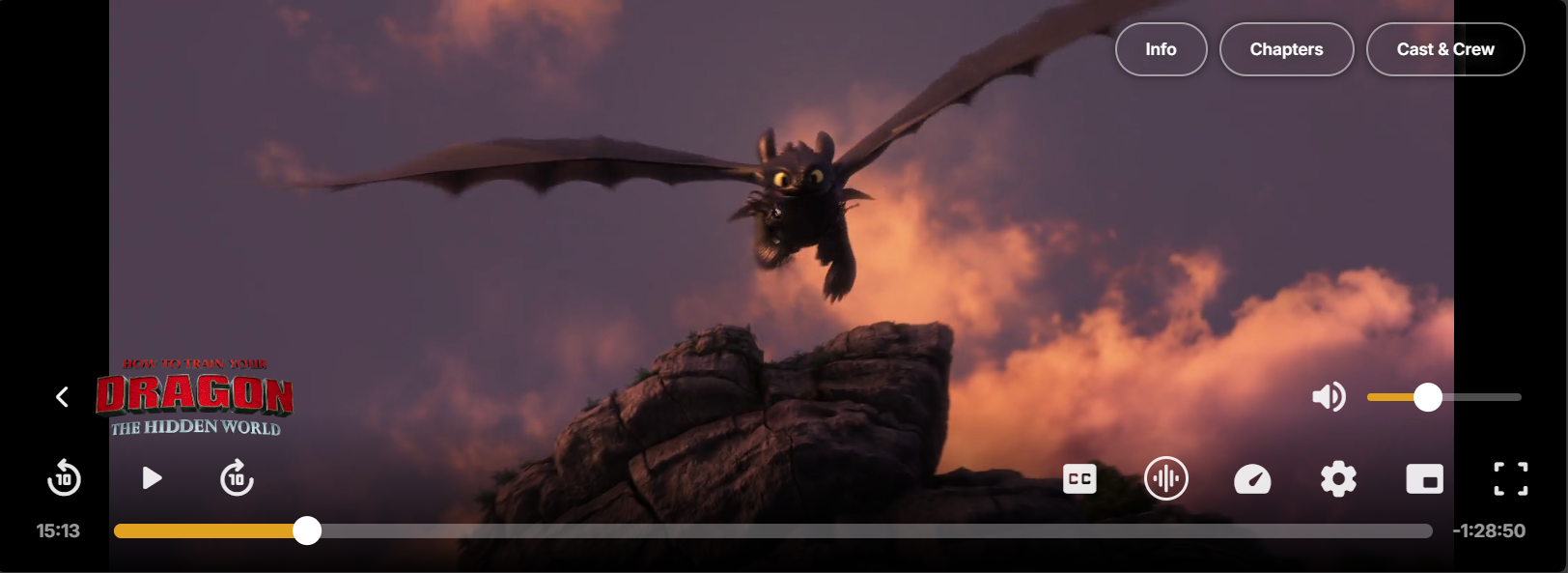

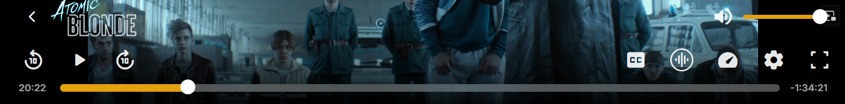

Happy2Play
Only that file is loaded into css even cleared history/cache.  I do not have volume indicator on bottom row, it is up with volume slider.
zoom 100%

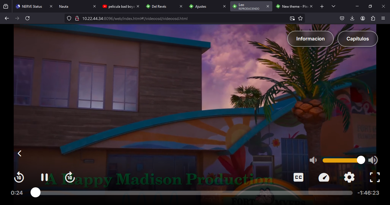

PinkMellow

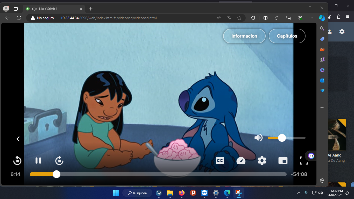

Hola a todos, soy nuevo en esto de los css y quisiera saber si pudieran ayudarme ,esta todo perfecto pero el control de volumen de los videos ,me sale en algunos navegadores y en otros no, muchas gracias de antemano por la ayuda.
Estilo PLEX.css
PinkMellow
ejemplo y veo que tampoco sale el botón de retornar atrás, muchas gracias

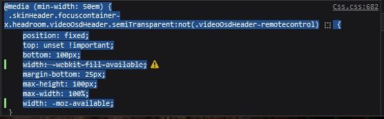

Happy2Play
19 minutes ago, PinkMellow said:
everything is perfect but the volume control of the videos appears in some browsers and not in others
example and I see that the back button does not come out either, thank you very much
Will take a look as I notice this earlier as this is an issue specific to Firefox.
Happy2Play
@fillidillI doubt you even look at Firefox.
But it requires its own variables is some cases as width: -webkit-fill-available; is not compatible so you need to add width: -moz-available. @PinkMellow
Only looked at this specific issue as there is a different issue with the PIP button.  Looks to be independent of Emby buttons as Emby button is hidden.
Edited by Happy2Play
typo

PinkMellow
muchas gracias por la ayuda al implementar ese codigo solucione para firefox ,pero me deba error en otros navegadores y esta fue la solucion que encontre y me abre en todos ya bien ,incluido el boton de ir a atrás
.skinHeader.focuscontainer-x.headroom.videoOsdHeader.semiTransparent:not(.videoOsdHeader-remotecontrol) {
    position: fixed;
    top: unset!important;
    bottom: 100px;
    margin-bottom: 25px;
    max-height: 100px;
    width: 100%;
PinkMellow

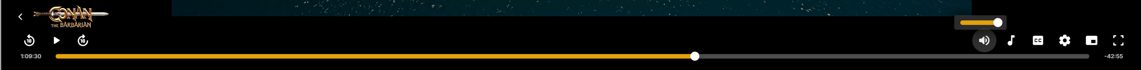

ahora tengo un problemilla jsjsj ,que al achicar el navegador se desaparece la barra de volumen
Estilo PLEX.css
Happy2Play
5 minutes ago, PinkMellow said:
Now I have a little problem jsjsj, that when I shrink the browser the volume bar disappears
Yes as that code falls into a @media (min-width: 50em).    I guess you can lower that value.

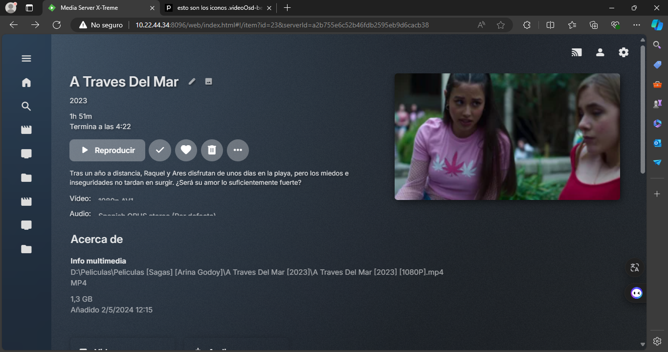

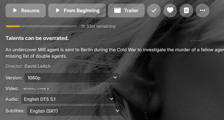

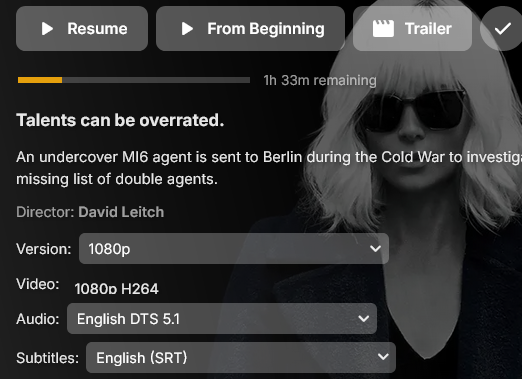

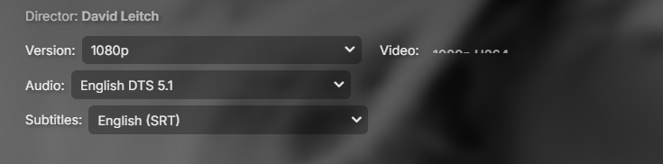

Hi Fillidill
I've just found your work great job.
I did find a little issue when using Edge, its fine in firefox. But as you can see the video and audio detail are cut.
It does it on everything.
Edited by sutt359
  • Like 1
  • Thanks 1
fillidill
@sutt359Hmm, that is really weird. In my edge it looks like this. How did you get the Video and Audio sections? Is that a setting perhaps? Which Emby version are you using?

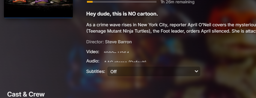

Happy2Play

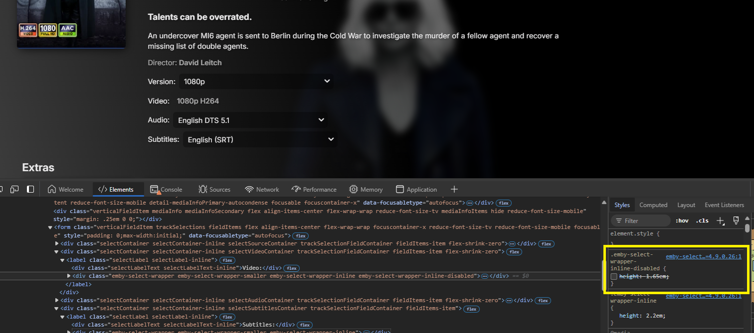

Still looking but here is what I get in Edge and Firefox, as your example is missing media info ie video and audio.
ff
screen width issue in edge as I expanded the window
Happy2Play
First issue appears related to this Emby code .emby-select-wrapper-inline-disabled as disabling it resolves the alignment issue. @fillidill
  • Agree 1
  • Thanks 1
Happy2Play
As for the moving track element it looks like this needs decreased.  On my screen it corrects is at 58% when full screen.
.topDetailsContainer form.trackSelections {
    max-width: 60% !important;
fillidill
Oops! Realized that I had hidden those Video and Audio sections in my own personal CSS edit which was the reason I didn't see it before. The reason I removed them is because I don't like how much space they take so I can't see cast below. I've now done a compromise where I move them to the side instead.
Emby-Stable-style-v3.4.txt

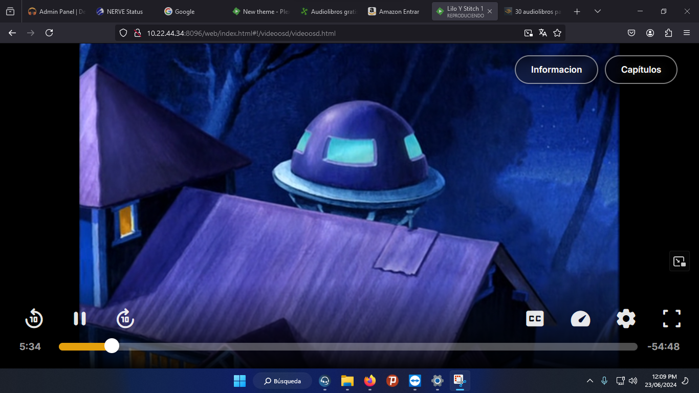

PinkMellow
Hola a todos me quisiera hacer estas pequeñas modificaciones al css pero no se como realizarlas y quería ver si pudieran ayudarme ,muchas gracias de antemano.
lo 1ro es que quisiera que el botón de volumen en ves de mostrar esos dos iconos de volumen solo mostrara uno del de la izquierda y que al tocarlo se pudiera poner en mute
y lo 2do es hacer que no se recorte la información de los videos
muchas gracias por la ayuda debajo adjunto fotos y el css

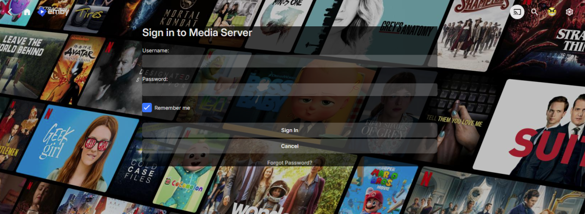

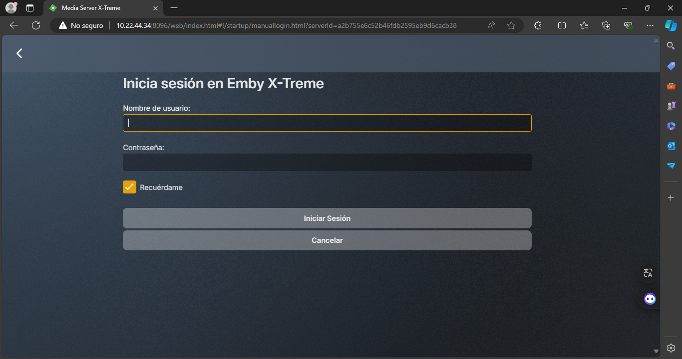

PinkMellow
por cierto no habria forma de hacerle un inicio de sesion mas llamativo tipo netflix o no se ,pero algo mas lindo
Happy2Play
17 minutes ago, PinkMellow said:
The 1st thing is that I would like the volume button instead of showing those two volume icons to only show one of the one on the left and that when you touch it it could be muted
You would have to undo the changes that were recently done as there are two volume controls, one in the header (div.videoOsdVolumeControls-top) and one showing now technically for mobile (videoOsdVolumeControls-bottom).
Will try to compare tomorrow if I get the time.
and the 2nd thing is to make sure that the information in the videos is not cut
You are not following changes already mentioned above.
Happy2Play
1 hour ago, PinkMellow said:
By the way, there would be no way to make a more flashy login like Netflix or I don't know, but something nicer
Have you looked around but will need minor code changes from older versions.  As you can add backdrop image url from online or place in correct folder.
