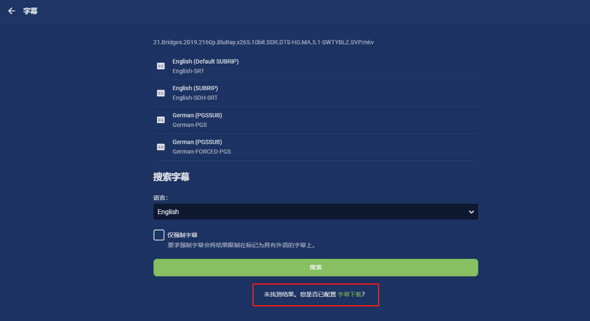

Joechung 5 Posted July 19, 2021 Share Posted July 19, 2021 (edited) 亲爱的 Emby 团队: 您好,我尝试在 IOS 和 W10 或网络上搜索字幕,但没有找到任何字幕。我购买了终身会员,解锁了字幕搜索功能并安装了插件。请求解决方案。 问题出现在以附图为例,这个《21座桥》原本自带4个英文内嵌字幕,后来我尝试通过Emby搜索英文、简体中文和繁体中文的字幕,发现没有一个字幕搜索。 Edited July 19, 2021 by Joechung Minor Changes Link to comment Share on other sites More sharing options...

Joechung 5 Posted July 21, 2021 Author Share Posted July 21, 2021 (edited) HI 亲爱的emby系统工程师 1. emby自带字幕搜索问题:我尝试在IOS和W10或网络上搜索字幕,但没有找到任何字幕。我购买了终身会员,解锁了字幕搜索功能并安装了插件。求解决办法。 问题出现在以附图为例,这个《21座桥》原本自带4个英文内嵌字幕,后来我尝试通过Emby搜索英文、简体中文和繁体中文的字幕,都没有搜索到字幕,我会上传问题1的日志和视频附件,请工作人员帮我解决。 问题2.关于key,我想问一下,我在网站上找不到答案,我想知道,一个终身key设备限制是25个设备,那么如果我不买扩展设备外壳,超过26个设备,会发生什么?将来我的密钥将不可用吗? 问题3.我想为我的Emby设置双服务器,我打算安排NAS的服务器端只读取和加载电影资源,并利用PC服务器端的性能来做资源抓取,但问题出现了,我的PC Emby Theater的服务器端设置了新媒体搜索无法搜索NAS的电影库,只能搜索到本地C和D盘。请告诉我如何使用 PC 上的 Emby Theater 将电影文件添加到 NAS? 行动 2021-7-19 19-30-20.mp4 embyserver.txt Edited July 21, 2021 by Joechung Link to comment Share on other sites More sharing options...

Luke 36878 Posted July 23, 2021 Share Posted July 23, 2021 You've enabled five subtitle providers. Have you checked the websites for each of those to see what they actually have for the movie you're searching for? Link to comment Share on other sites More sharing options...
Joechung 5 Posted July 23, 2021 Author Share Posted July 23, 2021 48 minutes ago, Luke said: You've enabled five subtitle providers. Have you checked the websites for each of those to see what they actually have for the movie you're searching for? Even if I only have 2 subtitles on, I still can't search for subtitles. I'll re-upload the log, please help me again to see why. Thank you! embyserver.txt Link to comment Share on other sites More sharing options...
Luke 36878 Posted July 23, 2021 Share Posted July 23, 2021 Again, did you check the OpenSubtitles and SubDB website to see what they actually have for the movie you're searching for? Link to comment Share on other sites More sharing options...
Joechung 5 Posted July 23, 2021 Author Share Posted July 23, 2021 (edited) 8 minutes ago, Luke said: Again, did you check the OpenSubtitles and SubDB website to see what they actually have for the movie you're searching for? Dear Luke I'll show you the screenshot again, I really understand that OpenSubtitles has the exact subtitles on it, and the corresponding movie name and subtitles are not searchable in OpenSubtitles that comes with EMBY, I'm very distressed what causes it. Edited July 23, 2021 by Joechung Link to comment Share on other sites More sharing options...
