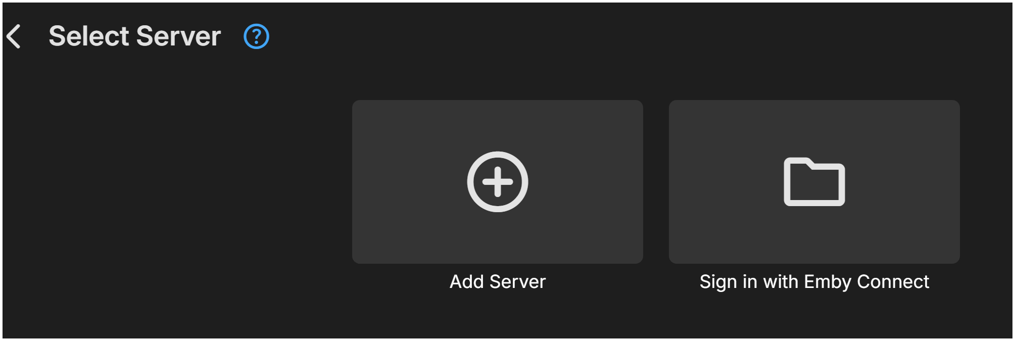

Great idea these how to guides and strangely enough the 1st one on Emby Connect is relevant to me as I'm not sure what I'm doing wrong but it never seems to work as it should for me or my users.
Basically I Login to Emby connect get presented with Add Server or Login into Emby Connect (screenshot attached), which just takes me back to the previous login page.image.thumb.png.13d92b9166145bb1acf409cc4e1862b9.png
I've followed the guide and all settings appear as they should be and I can get remote access to my server if I use my external URL, but just do not understand why Emby Connect is not working.
Any guidance appreciated.

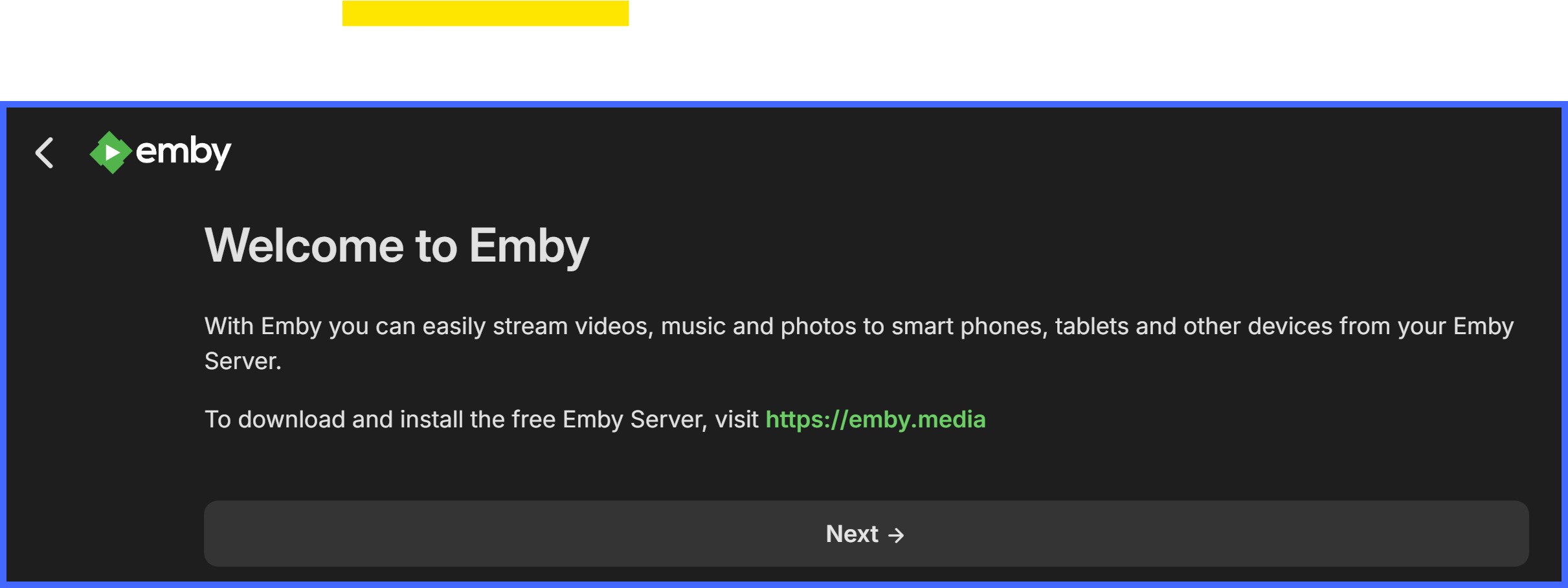

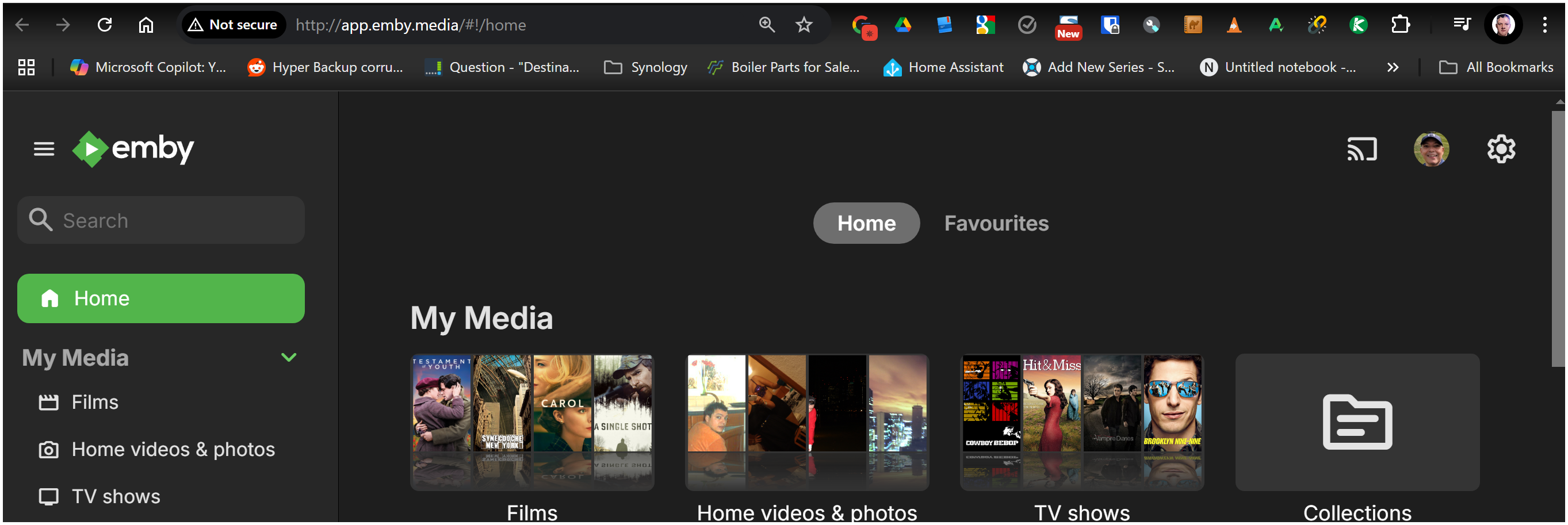

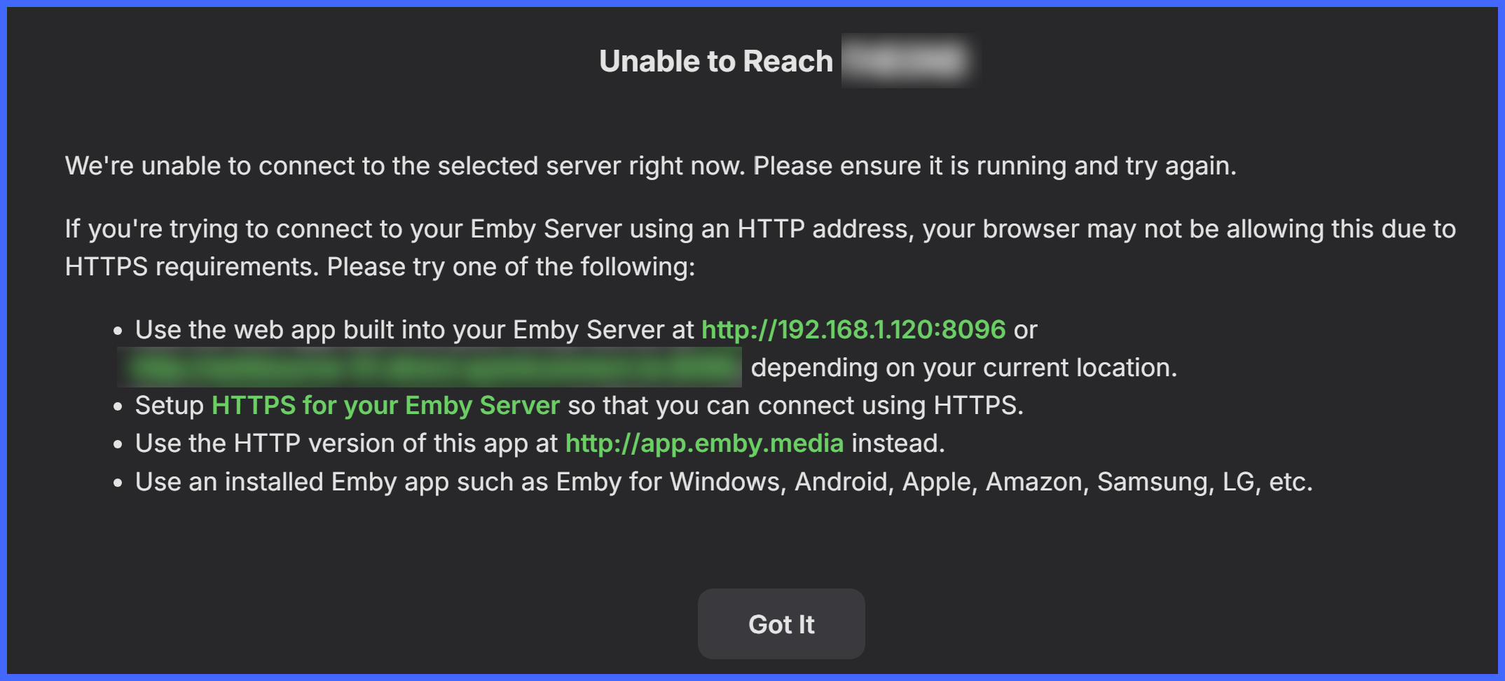

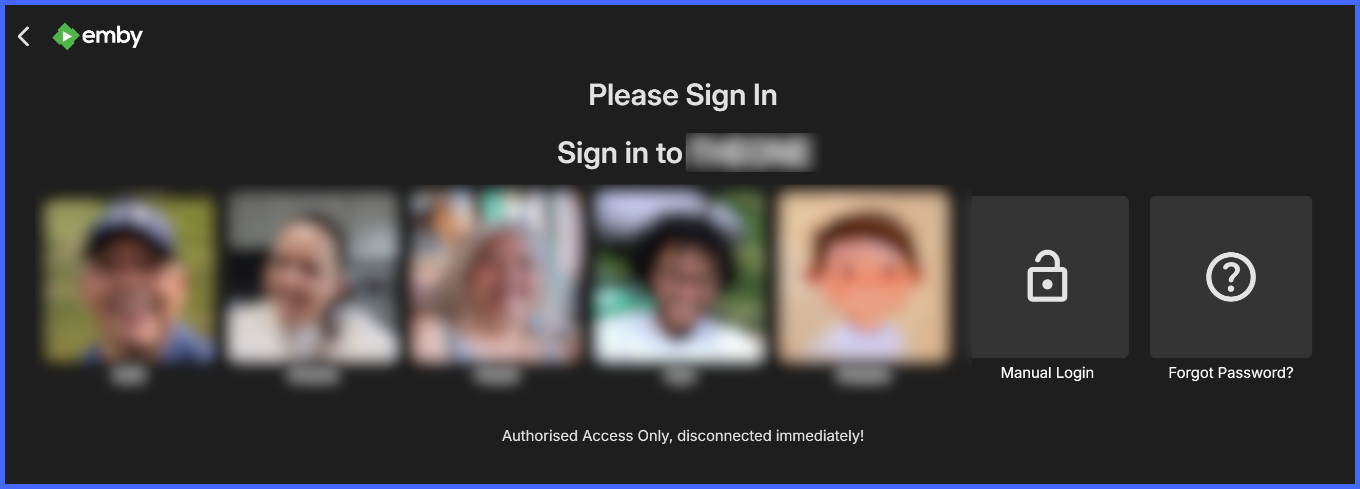

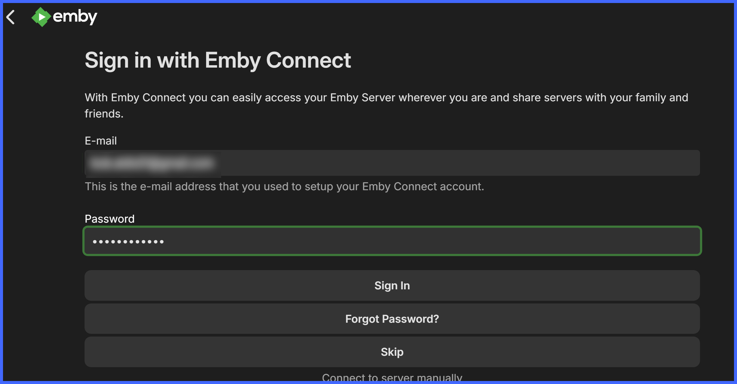

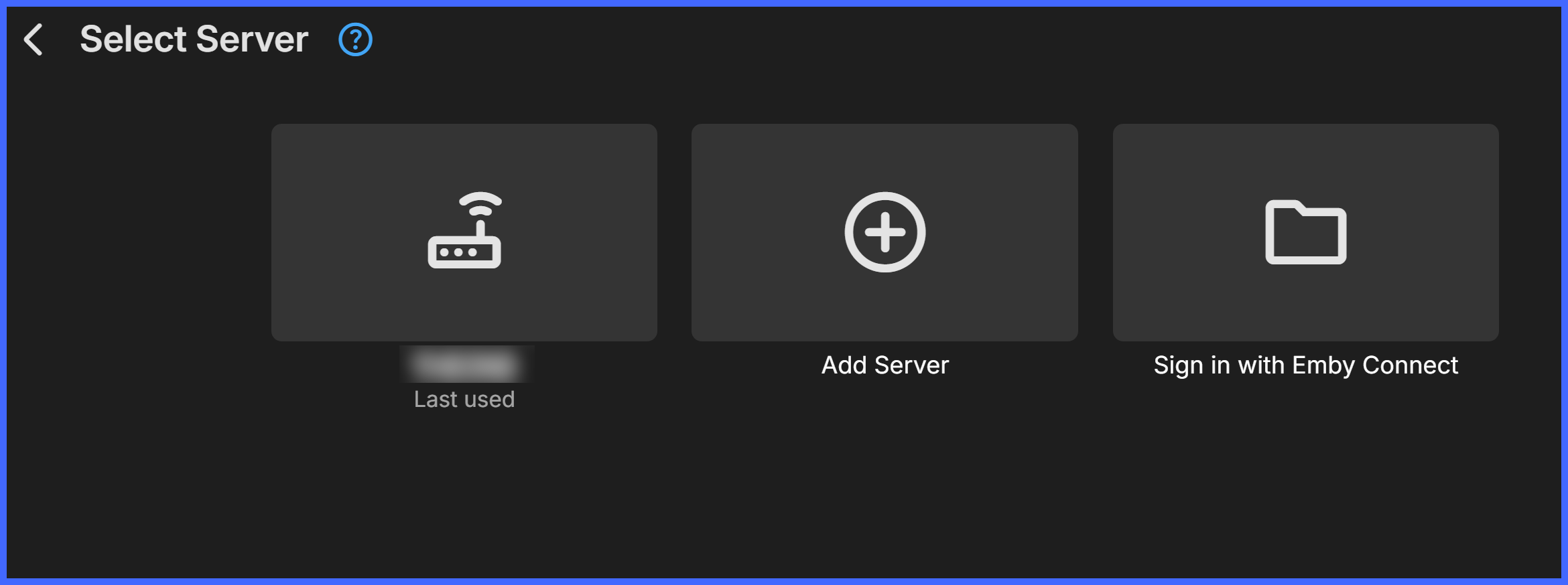

So this is the process and my experience:
3) Signed in options
I believe I've successfully signed in to Emby Connect as presented with "Last used" Server, but as per my previous question, if logged in why is there still a "Sign in with Emby Connect" button?image.thumb.png.82bc2e57f2f75a17a3ec4dc537384272.png
4) Try to login by pressing the "Last used" buttonimage.thumb.png.25f62c10e3a8f28e9361ff7122267973.png
5) Sign in successfully by clicking on either of the links (when at home, or just the WAN link when remote) so server available on the configured URLSimage.thumb.png.c571e9c1e09477719a9d728b430edbbe.png
I'm currently on Version 4.9.0.34 beta running on Synology NAS , but this has been my experience with Emby Connect as far back as I can remember and so hasn't ever felt right?
Any suggestions welcome?

seanbuff
24 minutes ago, bobaldis said:
why does Emby Connect fail to connect stating "Unable to Reach Server" surely it uses these same URLs, this happens every time not just occasionally?
Hi Bob, so the assumption is that your browser is forcing you to a https login, and you have not setup TLS for your server so it is failing. Is this correct?
If there is no HTTPS configured on your server, you could try disabling your browser from redirecting you using the steps outlined here: https://emby.media/community/index.php?/topic/123079-unable-to-connect-via-emby-connect/#comment-1296417
  • Thanks 1
bobaldis
Thanks, just off to bed but will try this in the morning.
